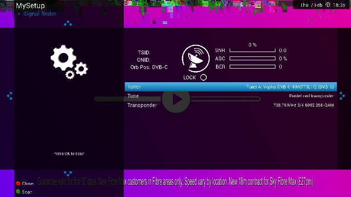

739 Mhz 6952 Quam256-3/4 snr 0%

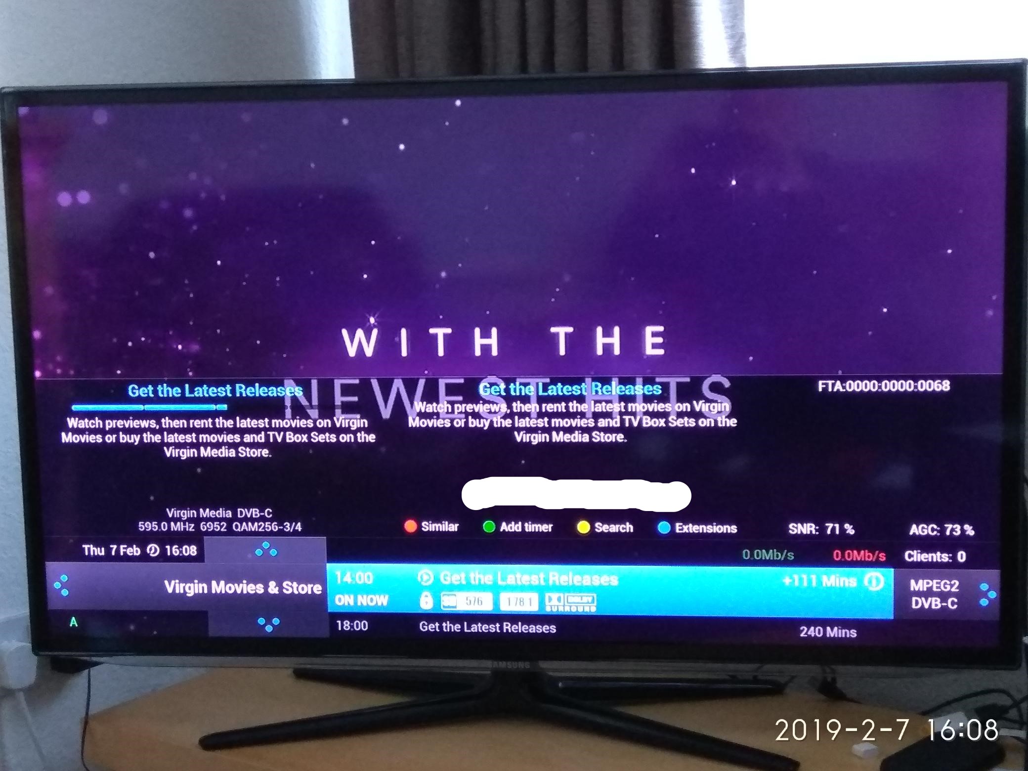

QAM 256 = 5
your image posted above suggests the QAM has changed from 64 to 256
The image is not going to make a difference, ABM is a plugin. In any case the current provider file has
frequency="595000" symbol_rate="6952000" system="0" modulation="5"
These match what your screenshot shows

Thank you! Forget ABM for time being.
Stage 1
Select the channel. Go to signal finder then grab a screenshot and upload it.
Use your web browser to grab the screenshot instead of camera.
So if your receiver has IP address "192.168.0.12", put the following in your web browser.
Code:
http://192.168.0.12/grab?format=jpg
You can then right click, save image as.
