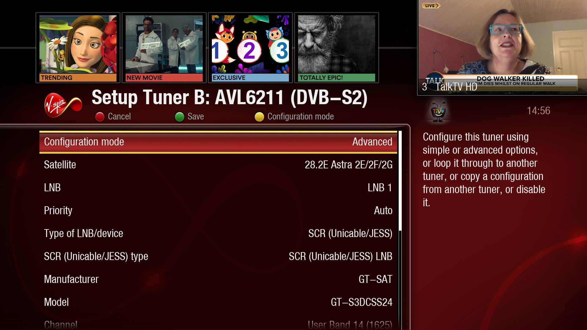

I don't recall the LNB make etc but here are the settings off my VU+ using FCB tuner, don't know if they help
Those GT Sat Hello use same frequencies across the model names. Check the xml file for frequencies, I am not at home.
Also, I forgot to mention, most devices will do unicable 1. The first 4 frequencies on LNBs are unicable 1 on most of them. So, change the frequency on vu+ to free up one of the first 4. Might aa well as start at 5.
