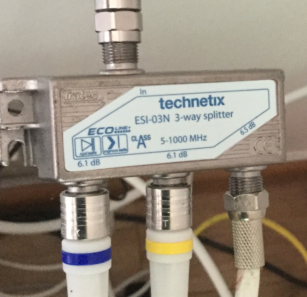

Ah sorry, I assumed you had the same receiver as the OP as you didn't specify it was different.
Can you try disabling tuner C to see if it makes any difference?
Made no difference which you may be expected since it's only 0.5db difference. I then changed the three way with the two way that was supplied from vm and again the arena hd and mix hd are pixelated.
Sent from my iPad using Tapatalk
thats actually quite a lot
dB is logarithmic, not linear,
so the difference between 6.1 and 6.5 is more than 5 times the difference between 6 and 6.1
its probably iro 10 or 20 times
hi mate i use to work for them for about 8 years as an engineer and a manager the 3rd cable could be causing you issues as you could be getting noise on your feed from the exposed braiding under the f connector also looking at your router up/down stream they are ok down stream should be as close to 0.0db as you can get it should be between -5 and +5db and your upstream is a little high try to get that around 42dbmv also if you have any other feeds with nothing on try some termination caps on them as they could also be letting noise in. make sure you are also using solid core cable not the honeycomb cable. also make sure all connections are tight.
you have probably upped your return power by removing the 3 way.
Problem seems to be solved by remaking termination on the feed to the zgemma box. Thanks to all who provided help.
