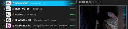

By catchup channels showing I mean like in the example screenshot I am attaching, when you bring up the channel list (not the only way but one example) do you see like this in the screenshot where there is the clock icon with the red arrow going round next to any channels?

There are catch up channels showing ( I have 2 Amikos both the same this applies to both ), When I select a previous programme I get the message " Get URL Fail ". If I power down the box,s and re-start sometimes it will work but only for programmes maybe 2 hours old.
