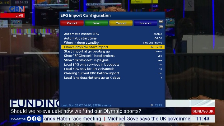

Any ideas why my EPG Importer is only working with manual import? Import days are all ticked. Box is H7s ATV 6.4
I've deleted EPG data and rescanned but obviously won't know if that has sorted it until tomorrow.

Not sure why you have Netmed and Viasat EPG set, these are foreign satellites
That .. I can't answer ... unless ... When I got the box a couple of weeks ago I only set it up for IPTV as I was waiting for the guy to come round and set up a new dish. It was pre loaded with a 2017 version of ATV with a load of German bouquets. After I got the new dish installed I upped it to 6.4 and set it up for UK sat and IPTV, maybe they are just remnants, they don't show in bouquets but I'll take them out.

I removed those foreign sat's and changed the auto download time. Checked it this morning and it seems to have worked. I'll check it again tomorrow to make sure it wasn't just a one off.
