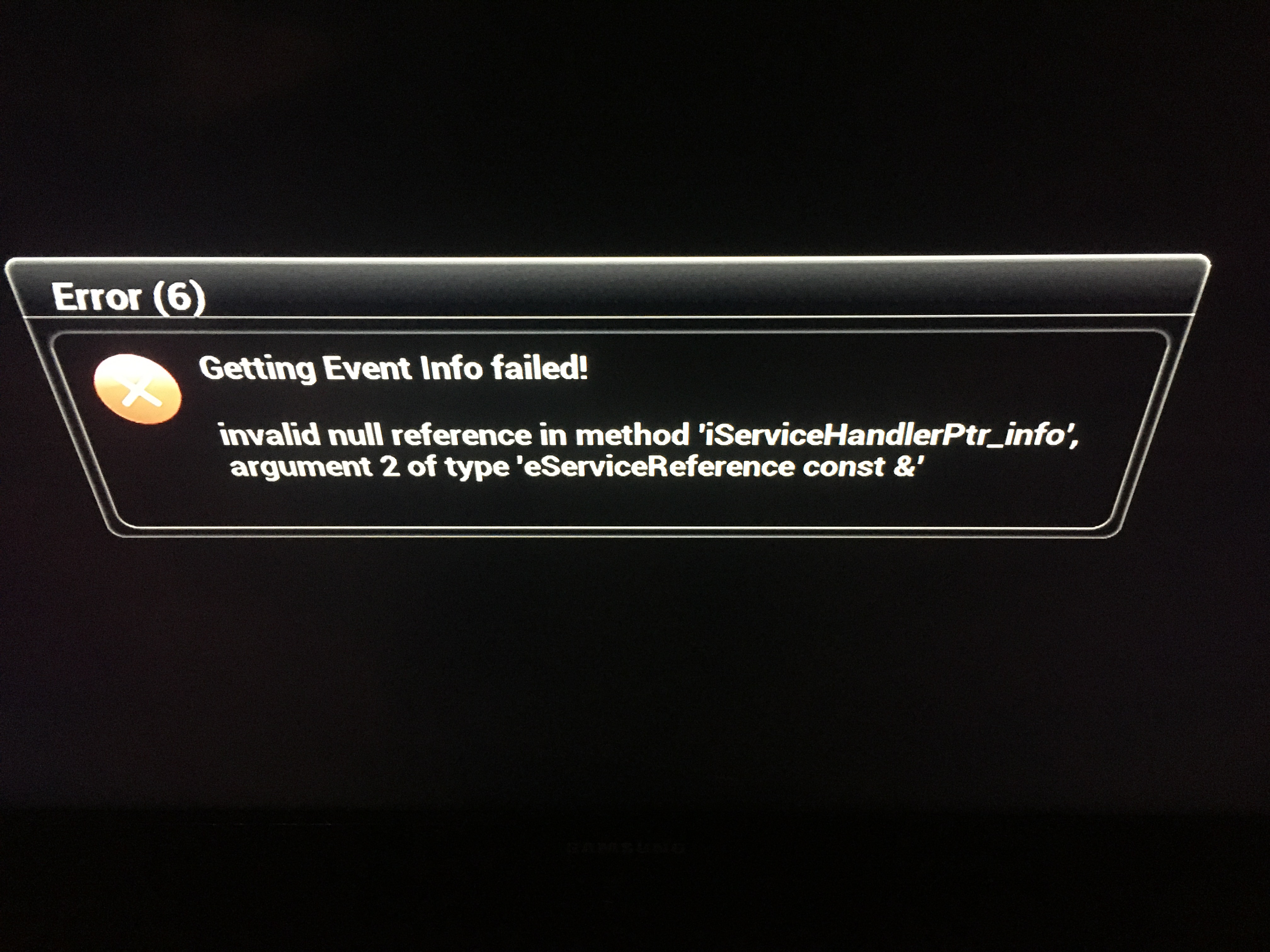

I am using zgemmah2s recently the wooshbuild logo appeared on the screen and wouldn’t go away so I updated the openatv to 6.3 via the online update now all I see is openatv 6.3 logo and if I go to a channel number I get this message can anyone help thanks

No channels found I am using my sly dish would they have switched it of so that I get no signal

I just switched on sly box and it says it isn’t getting a signal
That suggests either your LNB or cables are bad or your dish has moved in the wind
