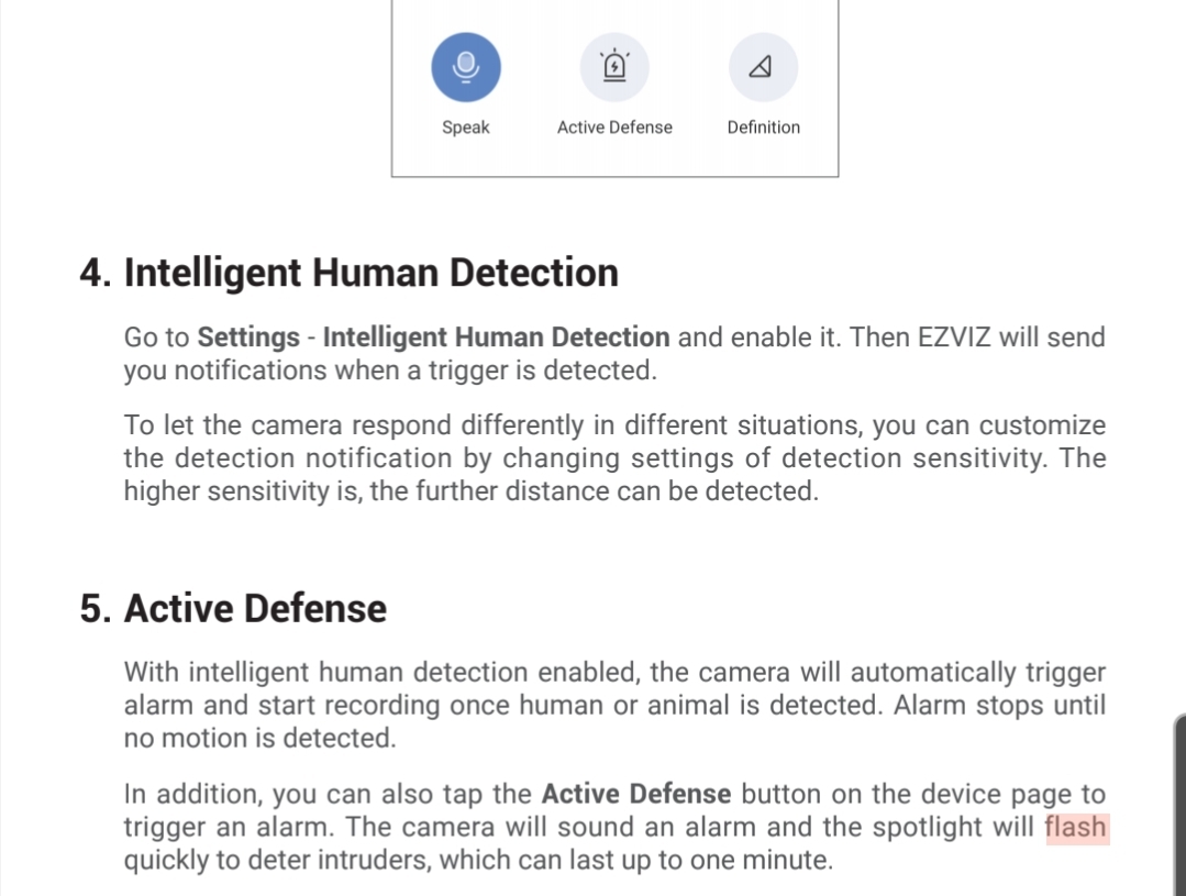

See these settings from the manual.
You have to enable human detection to edit defence modes. See 4 and 5 below.
Maybe then you can assign behaviours for the light.
Thank you again but it looks like they stay on all the time using colour night vision only poor design so will be staying on black and white IR
