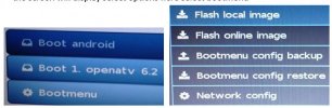

if you can get where you have options to boot from a partition go to bottom and select boot menu , then you can flash local or online image
