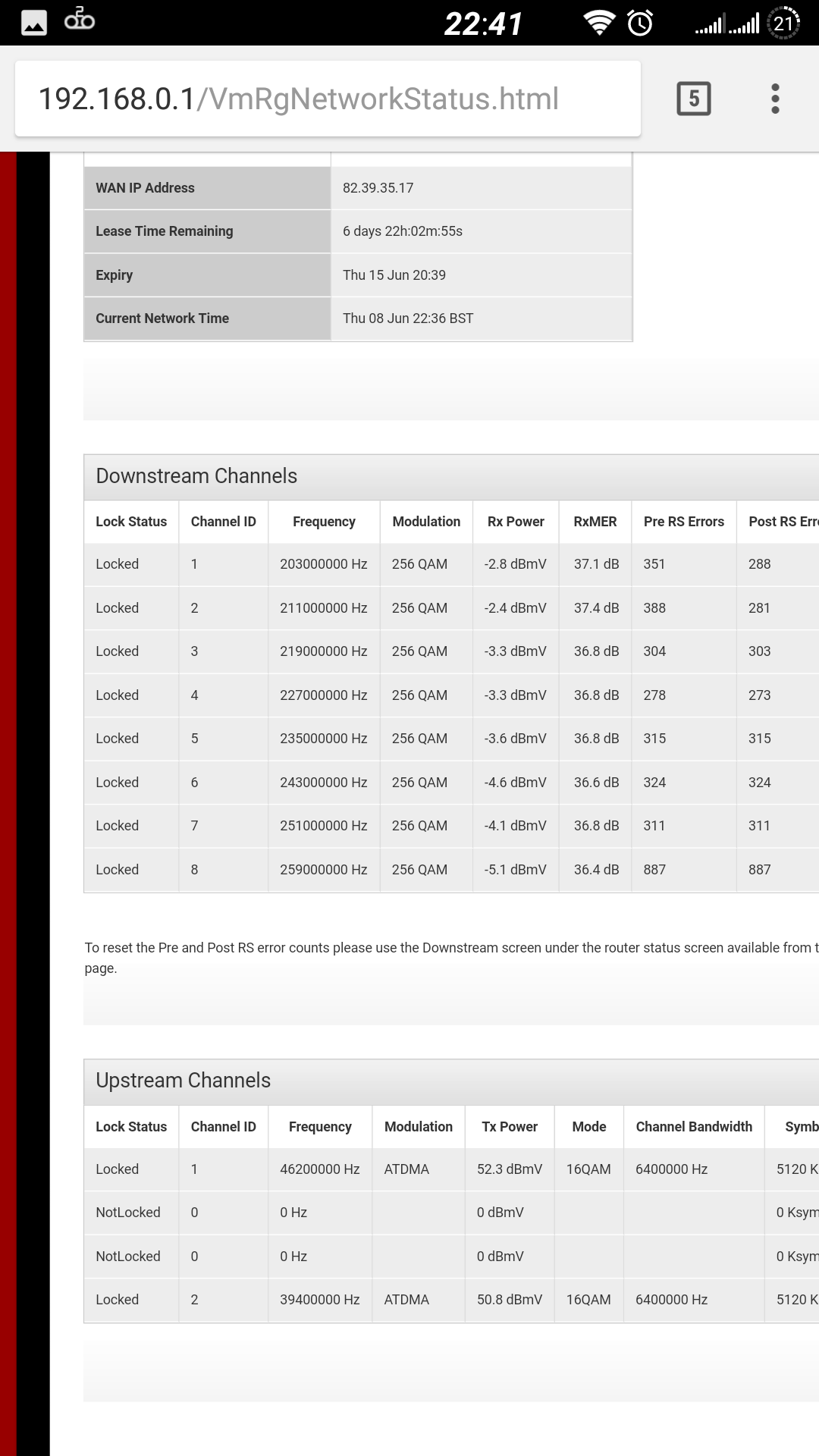

Maybe there's an issue with the SNR in the cabinet - can you check signal levels on your router.
Definitely a weird one mate. I'd put it down to a faulty box if it was just happening to just one h.2h - but it's the same problem on both boxes.
