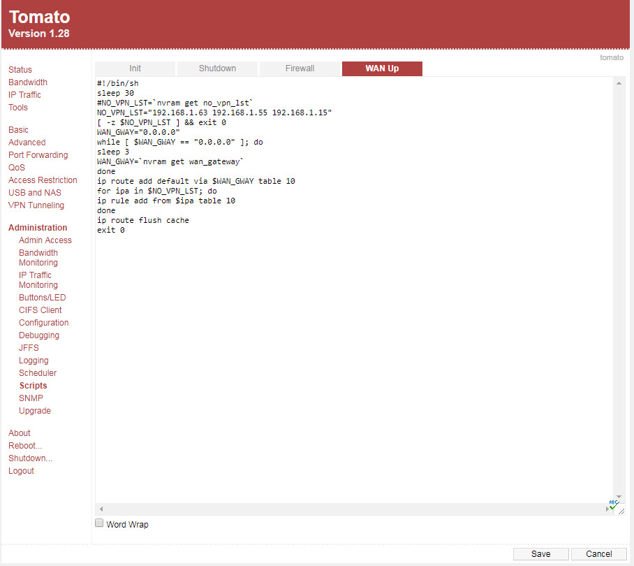

(did he supply you with all the keys etc. for the VPN?? just interested to know as it seems like a way out the way to go to get you up and running with a VPN) all your devices that are connected to the router would then be using the VPN and suffering speed/loss etc. (I made a post the other day on a small router that sits behind the device you want to use a VPN on and then your other devices can all still benefit from your normal speeds etc.)
of course you can add exceptions to the rule if you want to exclude a device from using it....simple script you add and that device can be connecting to your normal IP via the WAN rather than the VPN...... for example when I had a vodafone sure signal...no point having me location in outer mongolia.........not gonna help my suresignal that was....lol so I excluded it
192.168.1.63 was my suresignal vodafone router....192.168.1.55 and 192.168.1.15 is a secret! 😆
