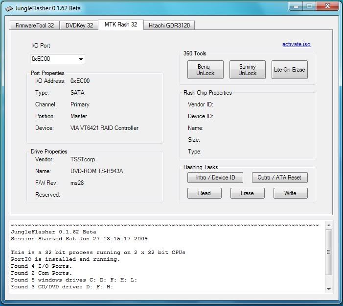

Start up Jungle Flasher and go to the MTKFlash 32 tab. You might have to change the IO Port to find your Samsung.
Once you find it, you should see the properties listed under Drive properties.

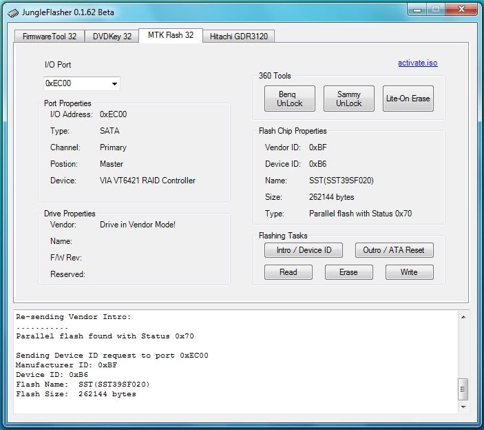

Since this is a stock drive, you will want to click Sammy unlock and you should see the following in the picture.
Notice the Flash Chip properties and now the Drive properties says Vendor Mode!

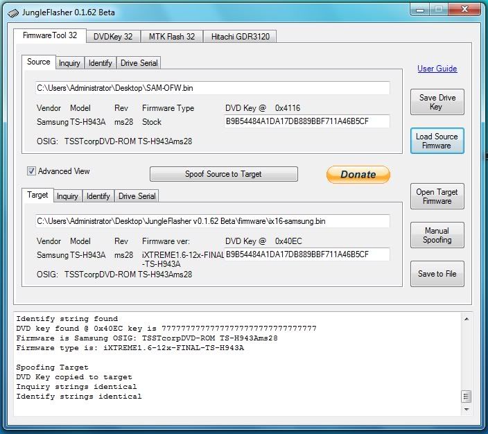

This is the result of clicking YES. Jungle flasher will autload iXtreme 1.6 for Samsung and spoof your information over.
Double check your original firmware to make sure you have a legitimate key.

To get good flash chip properties, we need to send the Intro to the Samsung drive, and then power cycle to get into vendor mode.
After you click YES, Shut the drive off for 1 second and then power back on
This is the result. Good flash chip properties and ready to read firmware.
