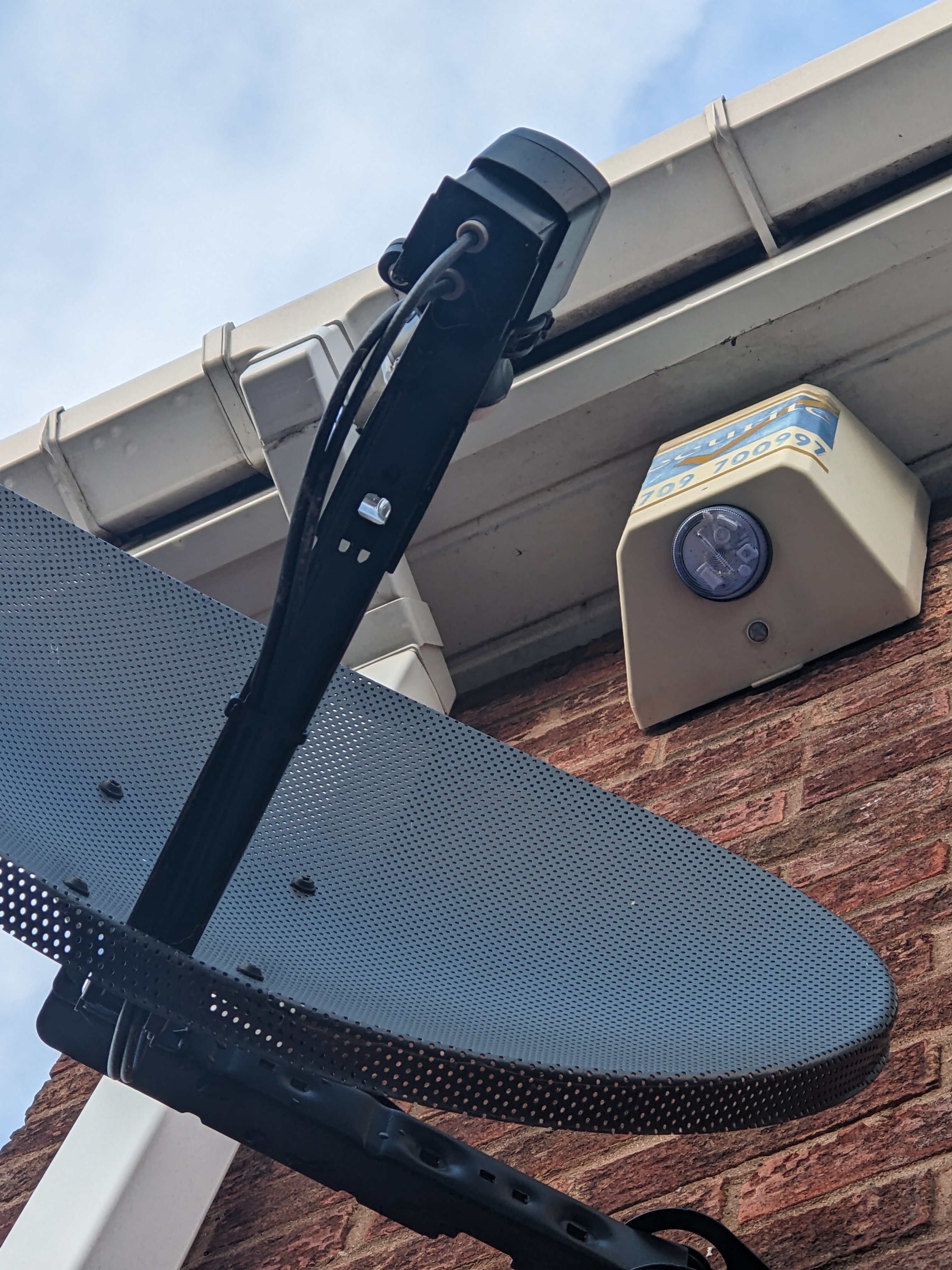

Had SkyQ fitted in 2021, ultimately we cancelled as they failed to offer the promised brodband speeds. I have a Samsung TV with built in freesat tuner but this does not work without buying an expensive Freesat box. I understand i need to change the Lnb on the SkyQ dish to a hybrid Lnb to make this work? Planning on ditching virgin at the end of the month and need a relaible backup for my iptv
Can anybody advise what is entailed in swapping over the Lnb, is it a difficult Job, any tips? its not too high on my house and i have a suitable ladder to get to the dish
I have seen some hybrid lnbs for sale on ebay, but which one would be suitable? i only need it to connect to the single Tv and nowhere else in the house.

You would only need a hybrid lnb if you wanted to continue with sky q. If you are positive that you only want freesat on tv then you only need a single lnb. Its dirt cheap and you only need to undo 2 screws, remove old lnb and keep it as its expensive, but that q lnb will have 2 cables so if I was you I would get a quad lnb as you will find uisng freesat on a tv is a PITB.

yes same cables. Just had a though have a look at lnb you have and count the outputs. report back

I had a good look at those 2 pics and very neat indeed but I hope there is some spare cable as those inputs to the lnb look very secure and I don't think they pull out easy.
