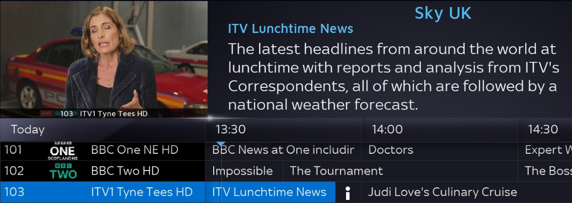

According to lyngsatT, V Tyne Tees is now on 11386H Have you changed your search ? I'm in London and my box picks up 5 ITV channels and ITV Wales plus ITV2 on that frequency
28.5°EAstra 2EUK, 54 dBW11386 HDVB-S2/8PSKSR-FEC: 27500-2/3
I thought they'd got rid of most of the regional channels now and made them the main HD channels.
I've just scanned Sky FTA Tyne HD and the channels look right.
