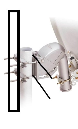

nothing in the way, been the same for years.I will assume there is nothing new blocking your direction of dish.
I'll just have to do it all again tomorrow, Thanks.Sounds like dish elevation to me, going out the further you get from 0.8w
Thanks, i will do that, the annoying thing is as i said i've done loads of them over the last 20 years and it falls into place, but not this time.Make sure the dish is central on the motor stub and your motor is set to your latitude, rest should come natural to you with todays experience.
You where right, even though it's bloody freezing i've just been out to adjust it, working fine now, Thanks.Sounds like dish elevation to me, going out the further you get from 0.8w
Oh result mate.You where right, even though it's bloody freezing i've just been out to adjust it, working fine now, Thanks.
