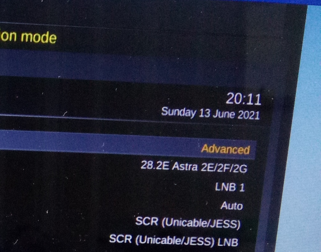

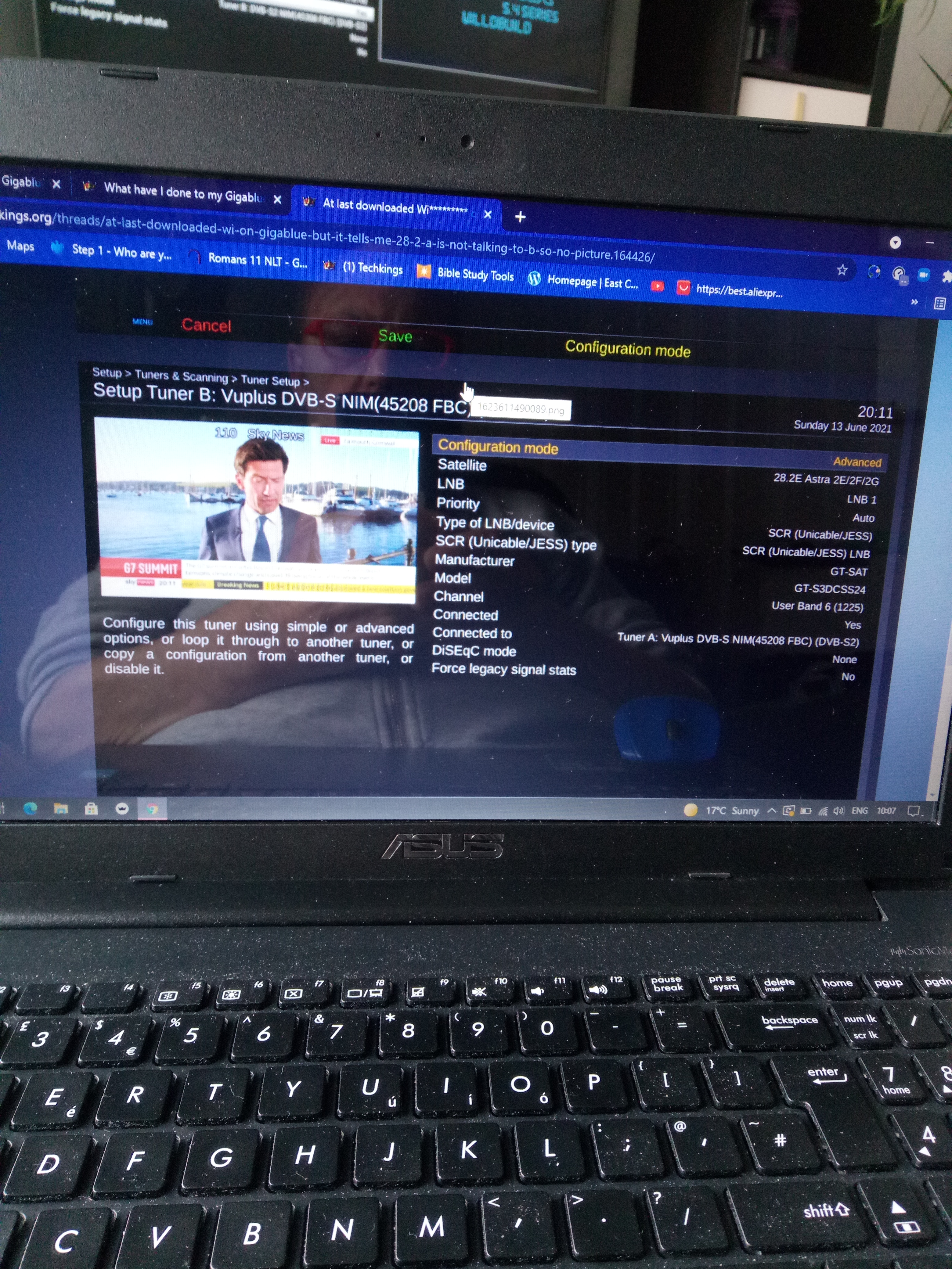

So if you have a separate cable to each tuner why is Tuner B connected to Tuner A in your picture?

Make sure your not using the same scr frequecies on both boxes they need to be different from box 1.
