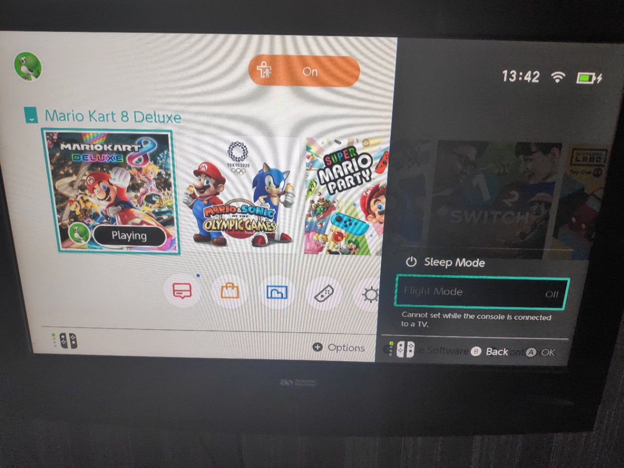

Got a strange slide bar that keep appearing on the right hand side of the screen without touching anything , this can happen during game play both on Tv or on small screen, i tried taking screen shot using the switch but it does not actually capture the slide bar that appears , so it may be some sort of overlay. I have taken some photos below using my phone to give you understanding.
I have tried updating and calibrating of the controllers but it still just appears , I'm thinking its actually a problem with my RHS joycon stick , this is normally the controller the kids use so it may just be busted , but thought see is any members have had similar issues before i buy another.
The only way i can get the slide bar away is turn off the switch and reconnect using another controller.

yes there is obviously something wrong with controller. One of the kods may of connected the controller with a bit to much force. you can buy a replacement rail for aroud £9.00
sorry mate you need to buy the slide bit on the joycon you can get them for £5 while you have the joycon open you might aswell replace the joystic to prebent drift. total cost around £13.
Thanks Mike , seems a shout , i put on another the other R Joy con that i have and to replicate that side screen appearing you have to hold down the home button, so could be possibility thats jammed also , are you aware if that can be replaced ? i just i could see what kind of screws it need to open. might me crisps or ohter junk it it . I'm blaming kids for sure at the pink controller is there go to.
Yes you can replace the home button. Best to give a quick clean when you open it up.
