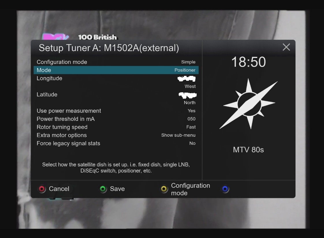

Please I need help, I updated my TM Twin 4K with Openvix 6.6, I am finding it difficult to setup the motorized on the Receiver. I live in London South. The user manual is not helpful. I had no problem with my older Tm-5402 M3. The dish alignment is alright. Thank you.
When you get the the tuner set up you need to select simple, then drop down to mode and toggle left and right button to select positioner. This is where you put your long and lat.
