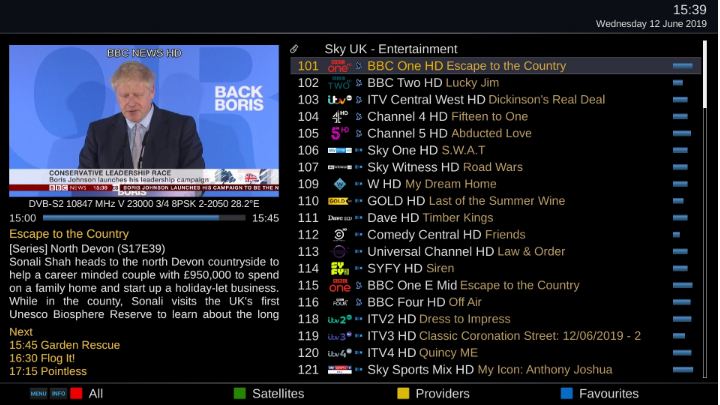

Vu+ use hardware transcoding.
Changing between satellite and cable is seamless. If you use the custommix plugin it will combine cable channels into the satellite bouquet to replace channels that no longer clear on sky.
39662
If you go with an FBC satellite tuner you will need a unicable LNB to get the full benefit from it.
It will just work in 'loop through' mode on a normal universal LNB.
