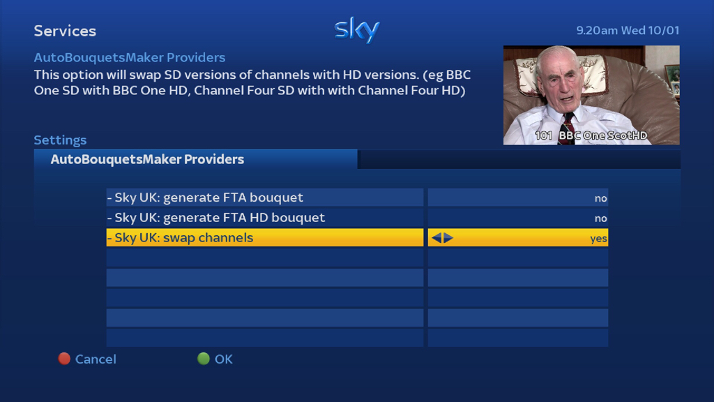

Green button -> WB Config -> Country, Region and scanning options
As Sayers said you can choose FreeSat only or set it to no and scan the paid channels too, then further down you can hide the non working Sky channels.
Don't forget to run a channel scan afterwards.
