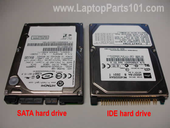

As for the SATA and DATA drives. I think its hardware vs terminology here.
Here is a SATA and IDE hard drive:
and here are the cables used to connect the two different types of hard drives to your system:
You notice that the SATA hard drive itself has a more compact connection lead as its much smaller than the old IDE ribbon cable. So thats your TWO different types of hard drives
So i hear you say "what on earth is a DATA drive then dan?!?"
I guess its just a term given to a hard drive that is used specifically for backups, so that would mean no operating systems should be installed on there, simply just drag and drop files onto this drive to minimise the risk of losing your data permanently.
