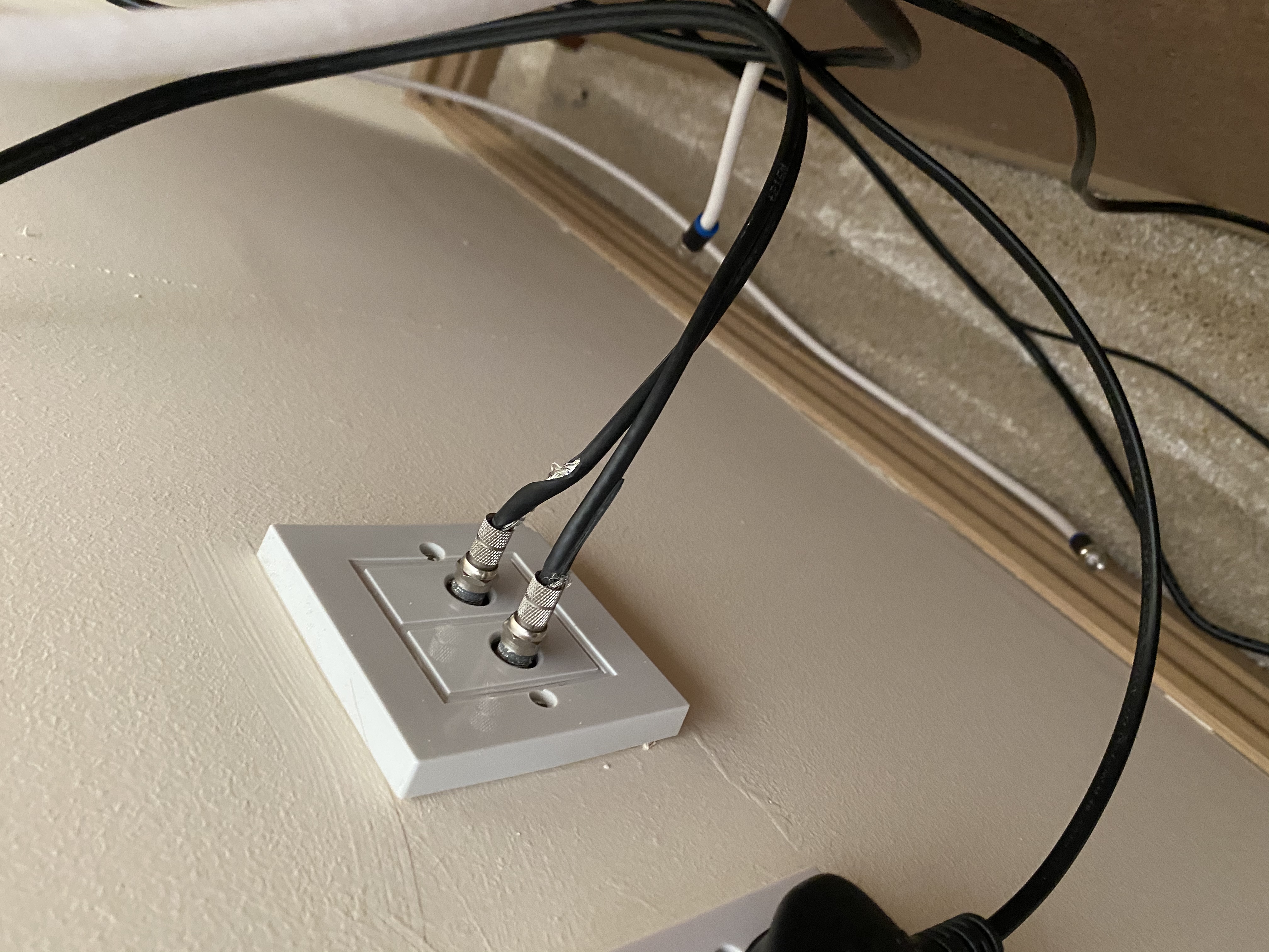

Can anyone help. We recently sent sky q back. Using sky+ for free sat. Downstairs the box works perfectly. Cannot get box upstairs to work. Says it’s initialising when it switches on then tells me it’s getting no signal. I’m losing the plot with this.

We cannot get freeview upstairs as we have no aerial socket. Just wanted to plug sky box back in to use it for the free channels. It works perfectly fine downstairs but not upstairs. Could we possibly have cables wrong on the lnb on sat dish?

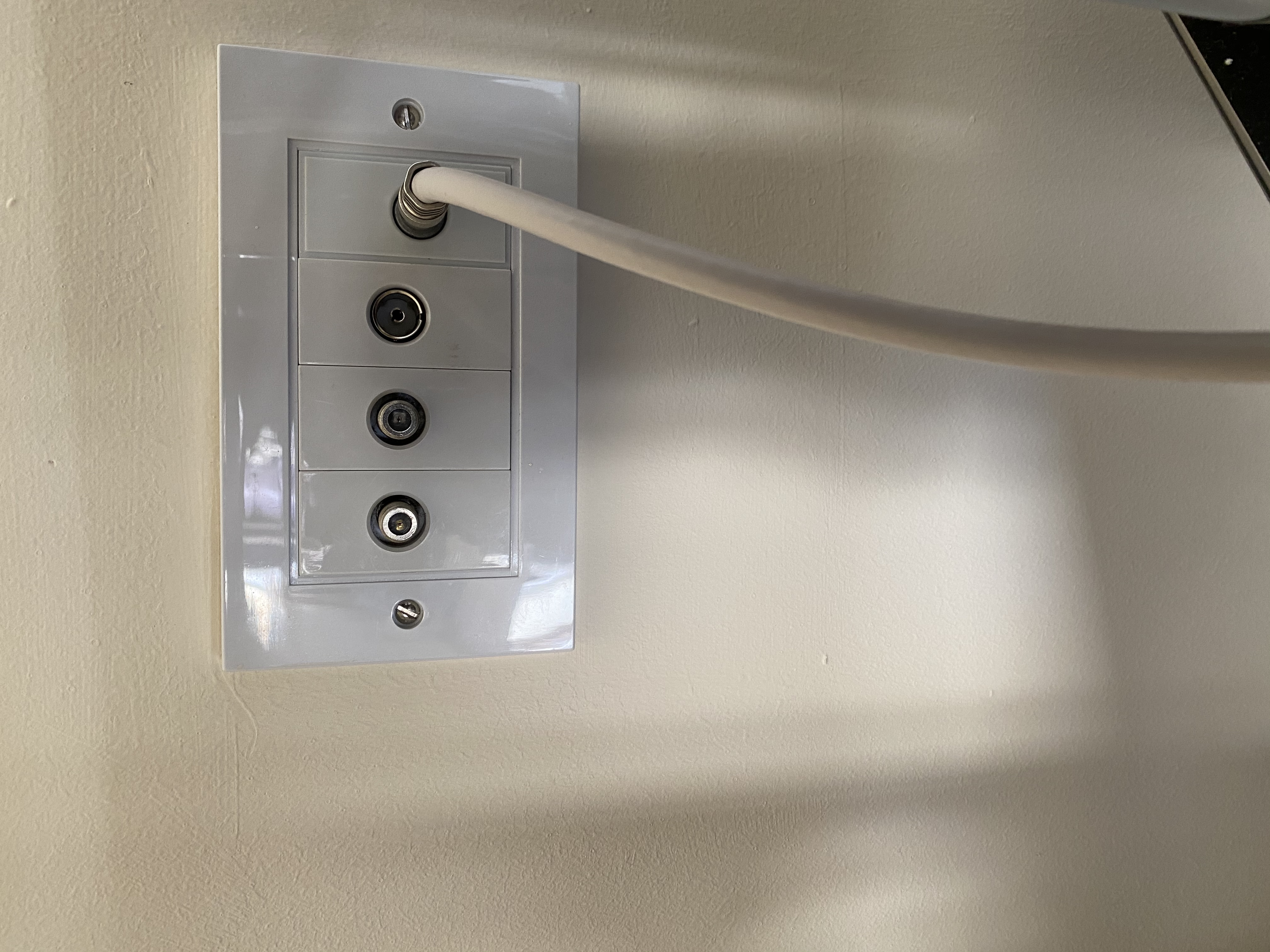

Could the 4 sockets we have on wall downstairs be anything to do with it? We have 2 sky sockets and 2 coax on wall in living room where sky cables come in from outside
Possibly a bad connection recheck cables and f connectors
Would the 2 cables that were tied back out the way when sky q was installed become damaged

We got rid of sky q we just want to use the sky box as Freesat as we have no aerial socket in bedroom upstairs
If cables tied back could let water in and might need new cables
4 sockets sound like 2 sky f connector plates with threads, are the other 2 cable/ aerial push in types as cant see sky using them.
Post a picture of living room as more likely that room has 2 sky feeds and other room previous had 2 feeds working off a quad lnb.

The ones on the left have threads =sat? are the ones on right both push ins?
That is a faceplate that could have any plate added like hdmi or lan as got them in my kitchen.
picture above looks like twin sat feeds.
Yes 2 satellite and 2 push in co ax? Downstairs. 2 sat upstairs. Which is what we have used to connect the sky+ box. The only thing I can think of is the 2 cables that weren’t in use on the sky dish have become damaged. Why do we need 4 sockets downstairs? We had a tv engineer come and install sky and freeview when we built this house in 2015 since we’ve had sky q installed only the living room socket works for both sky and satellite
Push in connector suggests freeview via aerial on roof nothing to do with sky .
Lnb on sat needs 4 cables into 2 rooms for twin feeds like on sky + hd boxes.
Are there 4 cables connected to lnb on sat dish.
Engineers can install both sat and freeview at the same time if asked as you might have a freeview box or tv with that tuner.
Yes we just installed a universal quad lnb the previous one left over from sky q was just a double. The 2 leftover cables were just left cable tied to the arm of the dish. We asked engineer to wire up 2 bedrooms for freeview and sky the remaining 3 bedrooms were to be freeview living room sky and freeview and kitchen only freeview. From day one we have had sky in the house which is the boxes we have gone back to.

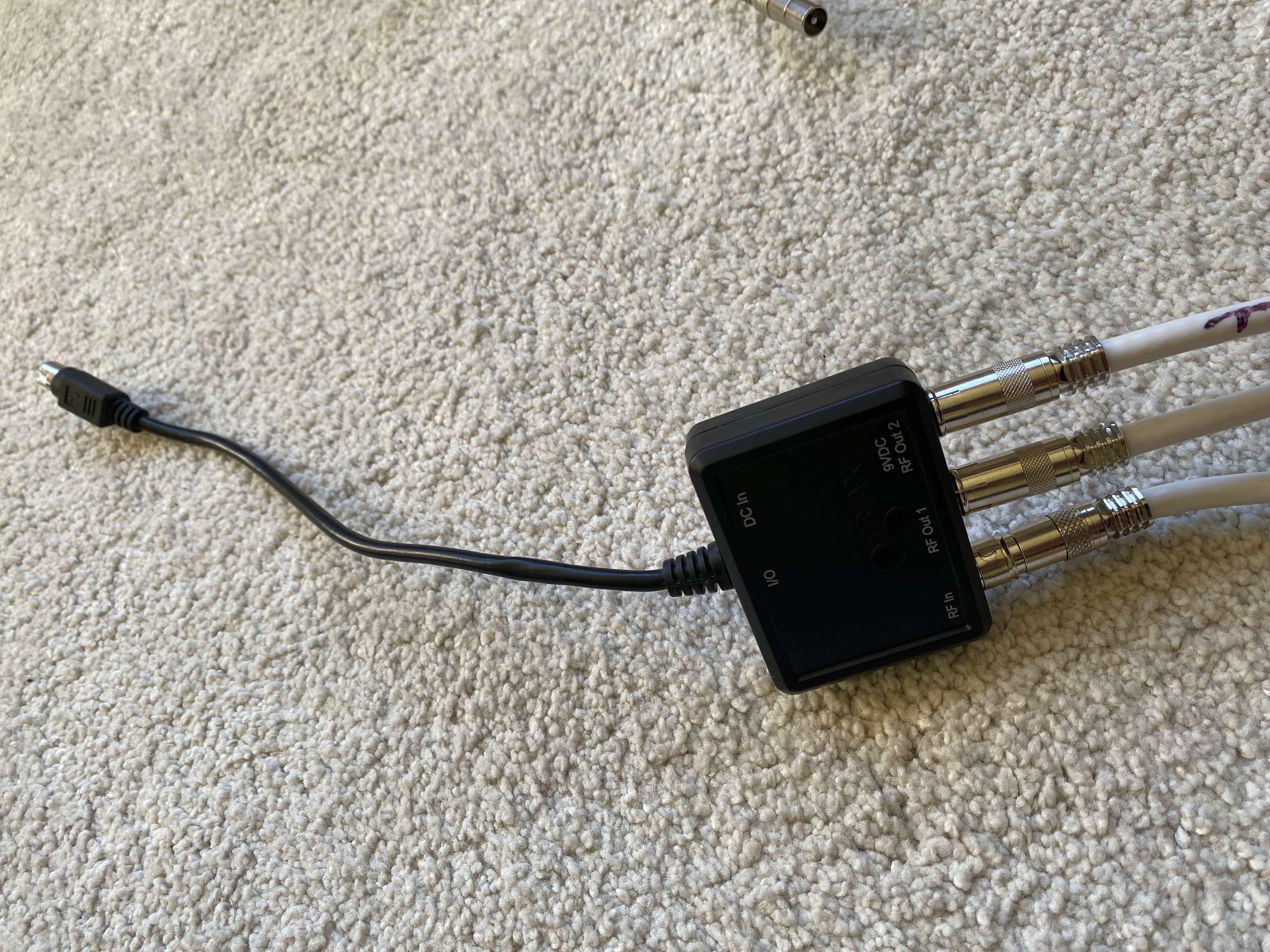

We also have one of these which we think was when we used a magic eye for sky through in kitchen would that be right? image.jpg
