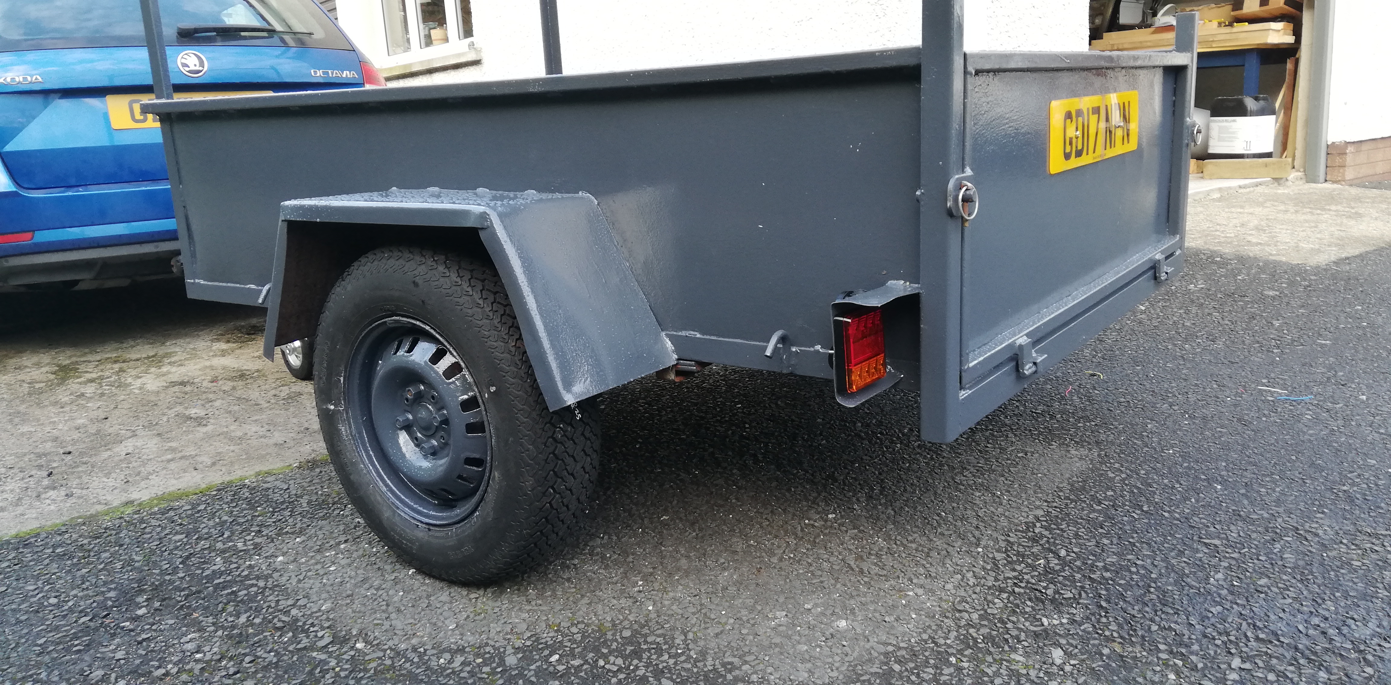

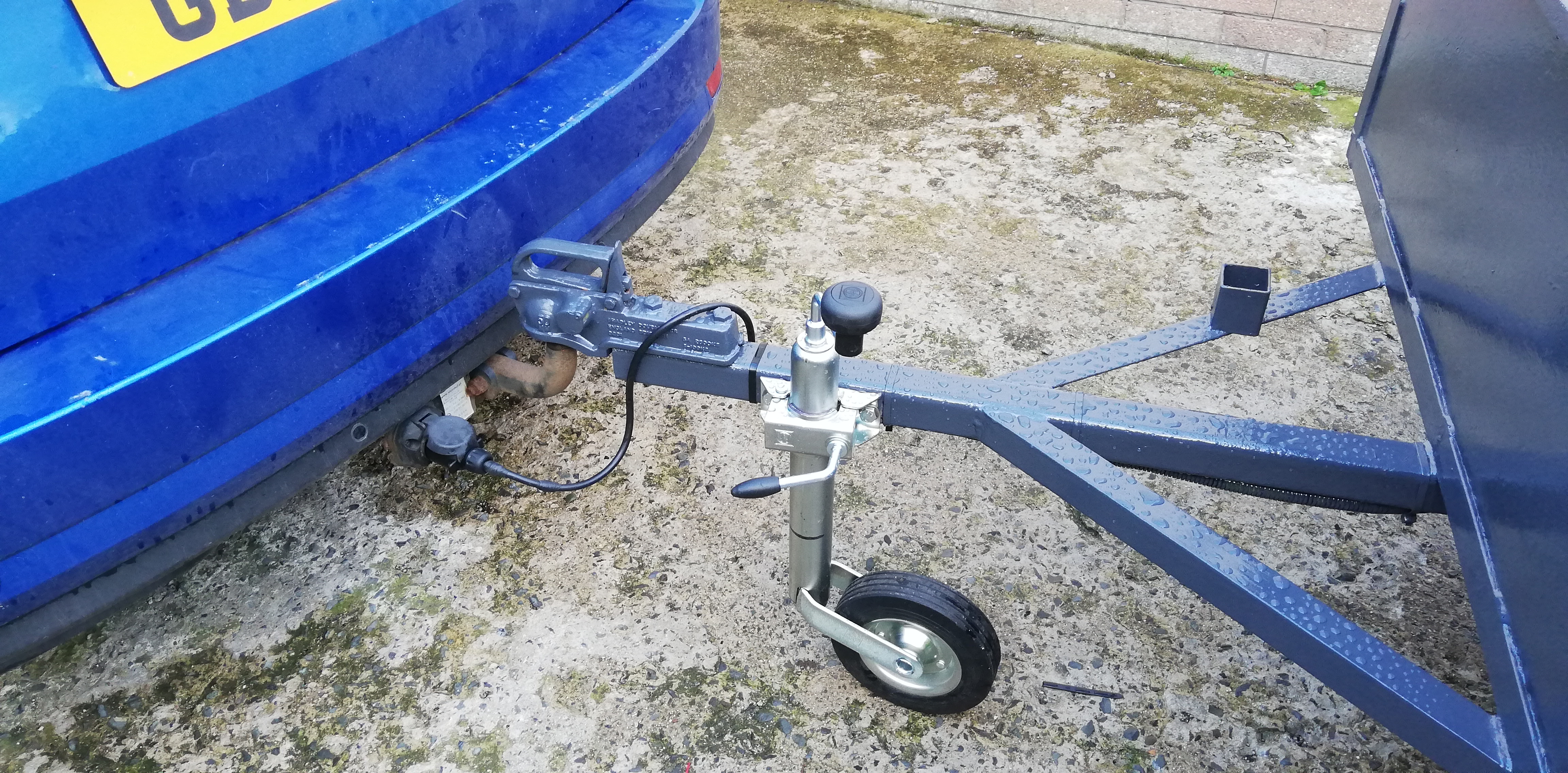

Regarding the paint, I eventually found a local guy who paints and mixes paints for lorries, agricultural equipment and steel outbuildings and could mix to any colour you wanted. The paint could be applied by brush, roller or my hvlp sprayer (although thinners would be required for a sprayer) so I just used a combination of brush and roller. The paint itself was easy enough to apply, but impossible to remove from brushes and roller sleeves, so use disposable ones. I applied 2 thick coats and used about 3 litres - the cost of 5l of paint was about
Should have updated this week's ago but forgot - sorry.
£40.View attachment 93623View attachment 93624
