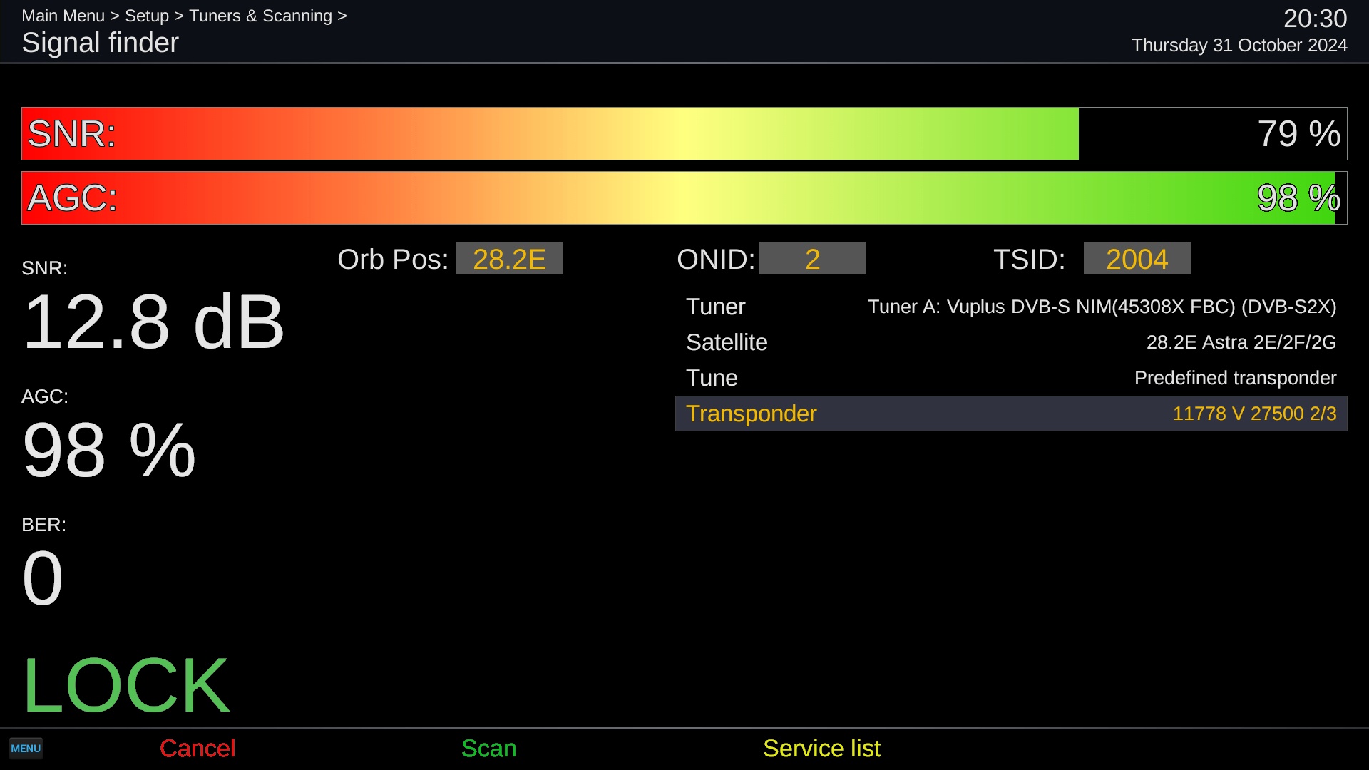

People make comments like "I have good signal", but it is not a thorough answer. There are many transponders on 28.2, some weaker than others. Some on Horizontal plane, some on Vertical plane. You really need to check the signal on the transponder you are interested in. For Sky 28.2, ABM uses 11778 MHz, Vertical, 27500. This has not changed for many years. Please use signal finder, select that transponder, check both tuners.
Yes It will be good to update, but it may not be the problem.
I have only found 7 channel at 11778
There are only 7 on that transponder, so it is correct. Did you test that on both tuners A and B? Can you please post a screenshot. Please highlight the tuner press right/left to change it if required. If you are getting signal on 11778 on tuner B on signal finder, best you update your image and then run ABM again and then get your debug log showing the fault.

Yes tuner A and B I’ll check some photos ,you think an update of the openatv will help?
You cannot perform a software update across version changes. You can easily flash a newer image using "flash online". If you have a storage device connected to the receiver, a settings backup will be made, after receiver restarts, it will re-apply everything and re-install what is on Plugins server. Very easy to do.
