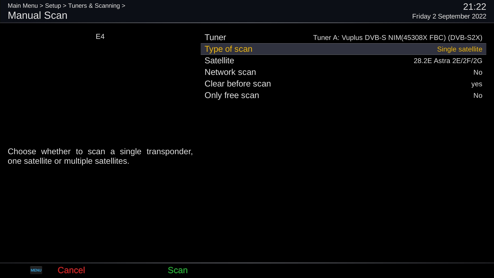

How are you scanning? Are you scanning using a plugin or using the scan facility in enigma2?
If you are using the enigma2 scanning, please post a screenshot of the settings you are using so we are on the same page. Sometimes people select a single transponder scan. You should be scanning using: Manual, single satellite.
