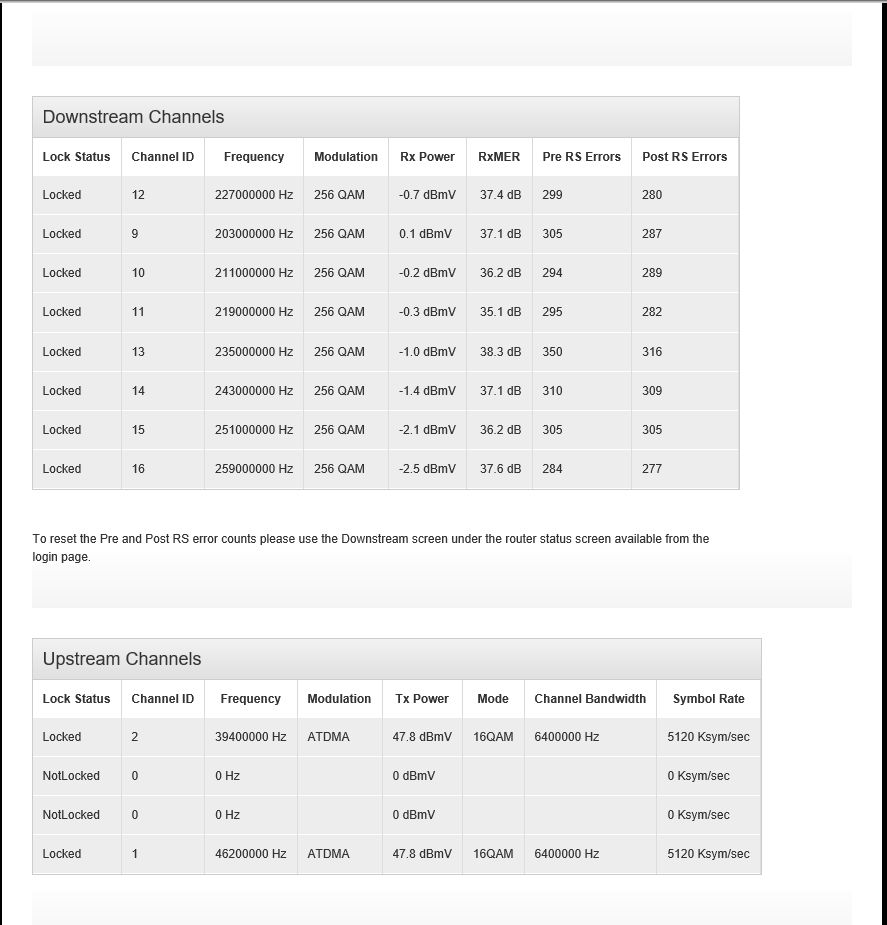

I have problems on sky sports arena Hd and sky sports mix hd on vm. The service code is the same as my TiVo box. The SNR is the same as other channels. The picture is pixelated with the sound breaking down. The SD channels are ok. Any ideas would be much appreciated.
Check power levels from router - check all cables and splitter(s) that you may be using... hopefully you're not using poor quality stuff.
Splitter is good - I notice it's a 3 way though so you may be losing some signal there... are those blue and yellow the new push fittings as fitted by VM? ... i'd also check that older type f connection on the right.
I do also have a TiVo box that is why it is three way, two for boxes and super hub. Will try changing cable on right to one of the 6.1db outputs and see if that makes a difference.
Sent from my iPad using Tapatalk
Made no difference which you may be expected since it's only 0.5db difference. I then changed the three way with the two way that was supplied from vm and again the arena hd and mix hd are pixelated.
