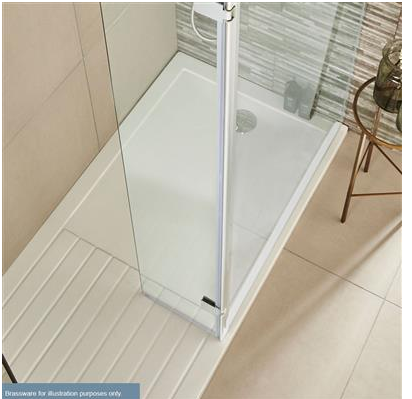

Has anybody got experience of wetroom walk-in shower formers? There is obviously a saying that you get what you pay for. Are formers like item 276033241340 on ebay of good enough quality? Any recommendations greatly appreciated. This is for installing on a concrete floor above PIR insulation.

This former is 40mm thick, meaning it will have to be enclosed with sides/walls etc

Many thanks. I have seen Mr Bisby's video, (he has more than one). As well as Plumber parts, but they are more for suspended floors. I ripped out the timber floor and went for a concrete floor. I have used smaller PIR where the "shower" is going, so should be solid enough there.
Another complication is that we will be installing wet UFH, those formers are I insulated.
I am wanting to keep a lip free entry for wheelchair users. God forbid should anything happen, so that rules out a tray.
