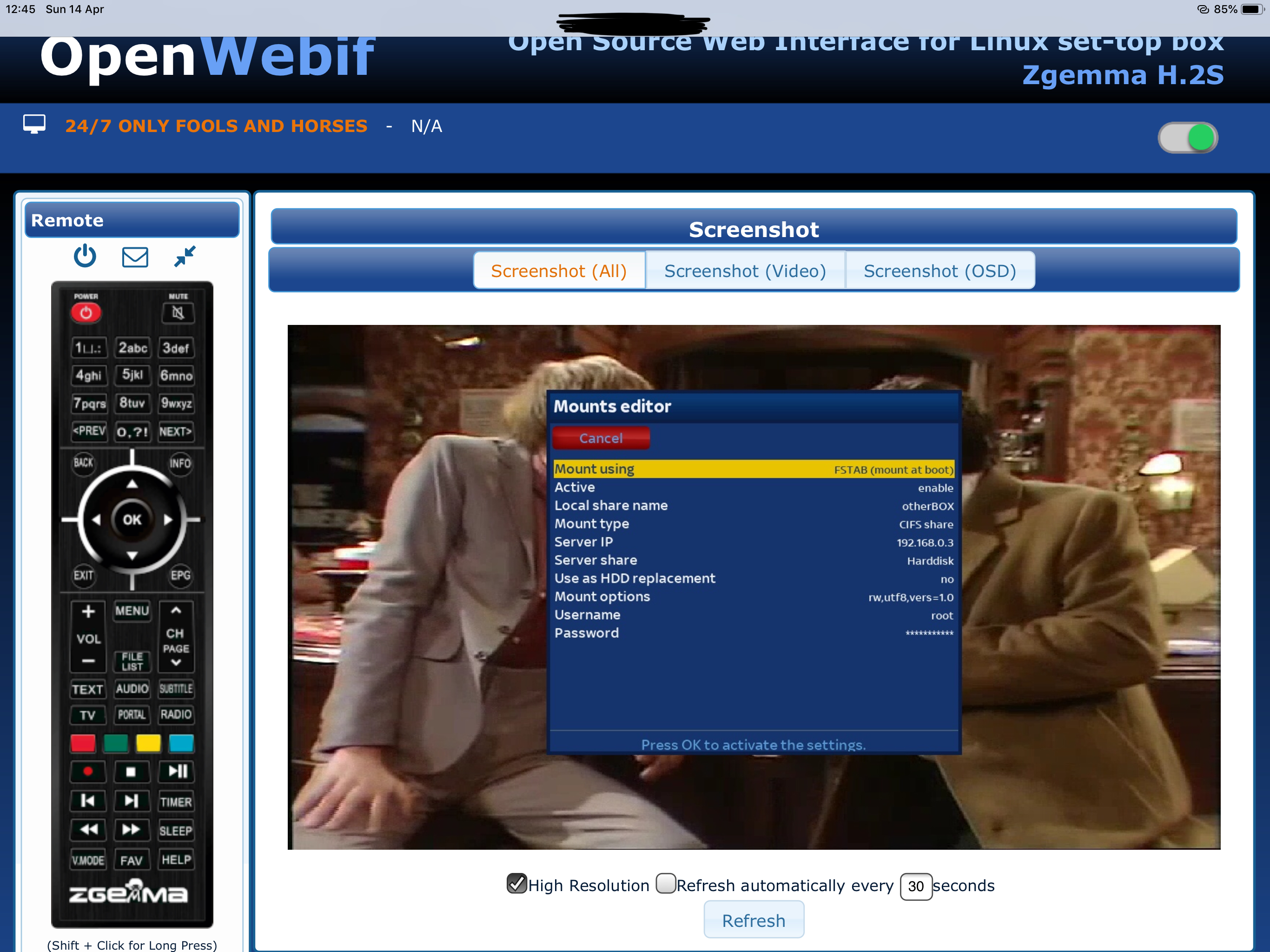

Could I find how you managed network the boxes to play each other’s recording?
The H7s Seems really good, far quicker than the H2S. I may buy another to replace the second box too.
Re the networking to see the other box, I have followed a guide on here before Willo maybe? Searched just now but I didn’t find it.
Anyway it’s a case of setting the other box up as a network mount. Settings/System/Network/Add Mount - or something like that.
Away at the moment but just logged into box and here is a screenshot of the info to enter. On the master box to look at the second box. On both of mine I have called them the “Other Box”. Same to add a network drive NAS or similar. Actually that might be what you search for to find the original guide on here.
Other trick once you have done it, to get the “other box” to show in the file list directly, go to recording settings, then in there select where to record to. You will want it to be the main hdd still but temporarily find the therbox/movies folder. then I think its blue or page down to make it a favourite. Then whilst still in that menu, select the hdd again. repeat on other box but with the different IP address. User name is root and password is blank (or if that doesn’t work use root). Unless you have changed it before.
