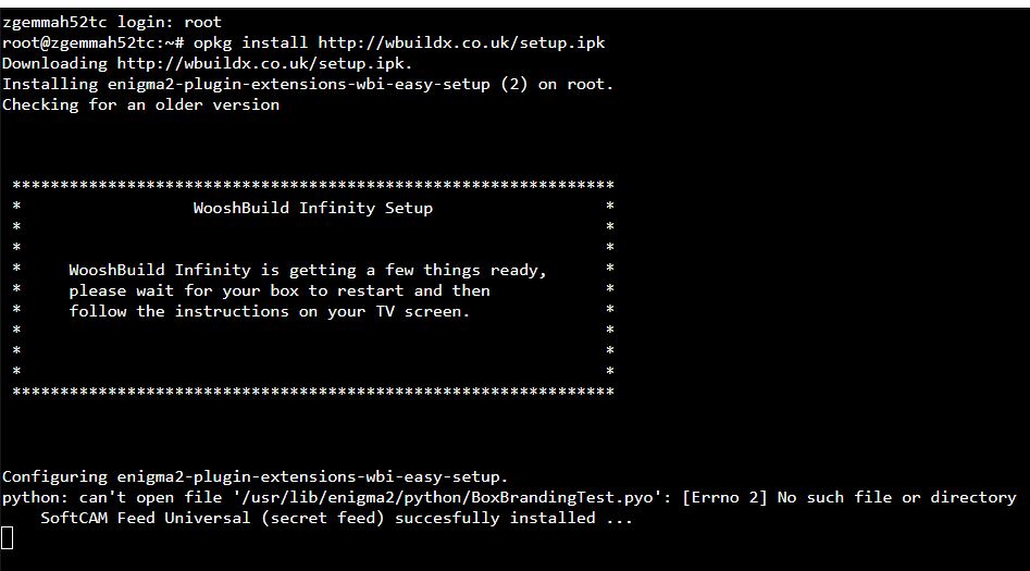

I just tried updating a Zgemma H5.2TC and something hasnt gone to plan.
I updated the openATV fine to 7.1 via USB.
Prob a mistake doing it that way but its done now.
I then logged into webif using the guide linked below and ran the command as instructed.
WooshBuild Infinity - For ALL Enigma2 boxes

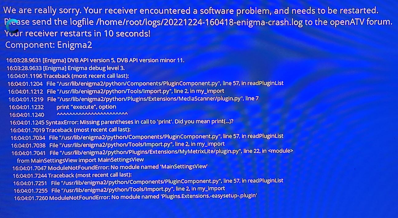

It did do something but then came up with an error and now when the box tries to start up I get a blue screen of death and the box just restarts over and over again.
Please see atttached photos.

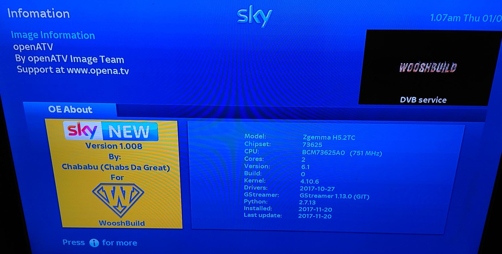

When I first plugged it in the box was an older version op openATV with the Wooshbuild from 2017 it seems combined with A Sky new Plugin which makes the EPG look like a Sky HD guide which I really like.
If there is something I can install to keep it like looking the same that would be great.

As @moshibeth said you need openatv 6.4 for wooshbuild but that is not really updated any more and niether will be openatv 6.4 it is end of life but for freesat it maybey ok as long as plugins still work but they may not be updated either. And if you do decide to install wooshbuild when you install openatv 6.4 initialaze your usb first before trying to install wooshbuild or it will fail and when wooshbuild askes you to initializes usb just say no.
