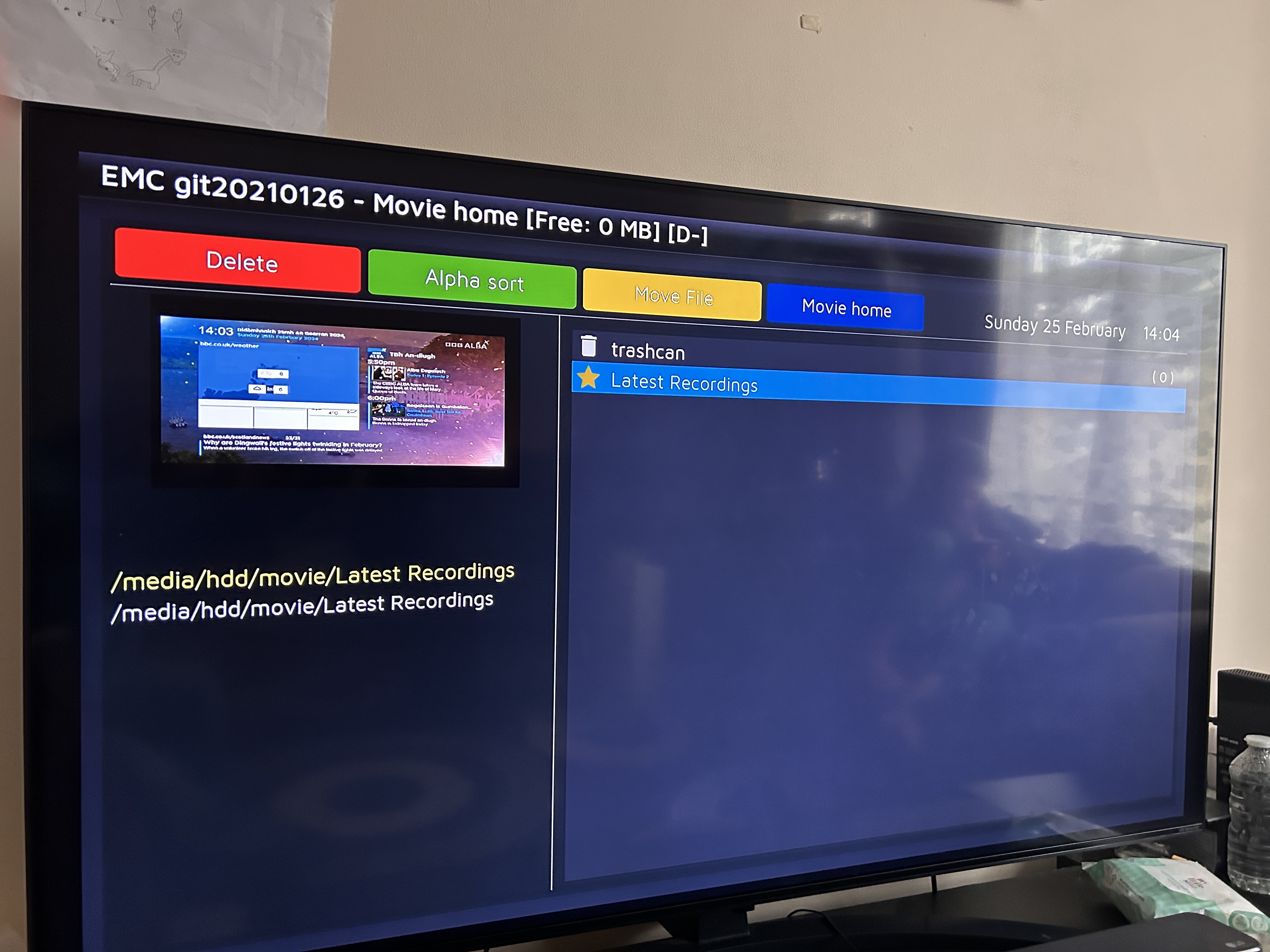

Hi I need help My recorded movies are disappeared. I attached 100GB external hard with my box. When I press file list button of the remote. This below screen appears on the screen. I can not even record the programs. If some one could help me please. Thanks
