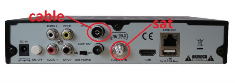

You say
2 Cables from Dish. Into LNB and RF in.
so where is your vm cable going or was that an error?
sky cable in tuner a bottom right and vm cable in rf adapter in top left

If you can see say sky movies and sky sports then you're fine and have a non virgin Ireland line
Sent from my VF695 using Tapatalk
I think we're getting mixed up what box do you have? Are you getting virgin channels without the cable connected? This would allow you to record one sky channel and watch one cable channel.
---------- Post Merged at 02:58 PM ----------
It's not rf out its rf in

You say
Hey, with this setup, Sat cable in bottom right, Cable from VM in the RF port - so for recording on a H2H - other versions of the box have 2 LNB's from reading Whoosh/Sucm guides, what about the H2H? Do i need another cable setup on it? I am unable to record one channel and view another. It says no free tuner.
H2H has 1 port for satellite, and 1 port for cable. If you need 2 satellite ports, you need the H2S box.
To watch one channel and record another on the H2H, you need 1 satellite feed, 1 cable feed, 1 satellite line and 1 cable line.

Sounds like your cable tuner is not set up properly, have you put your area Id in ? for example 00002 Glasgow
Have you scanned for channels ?
