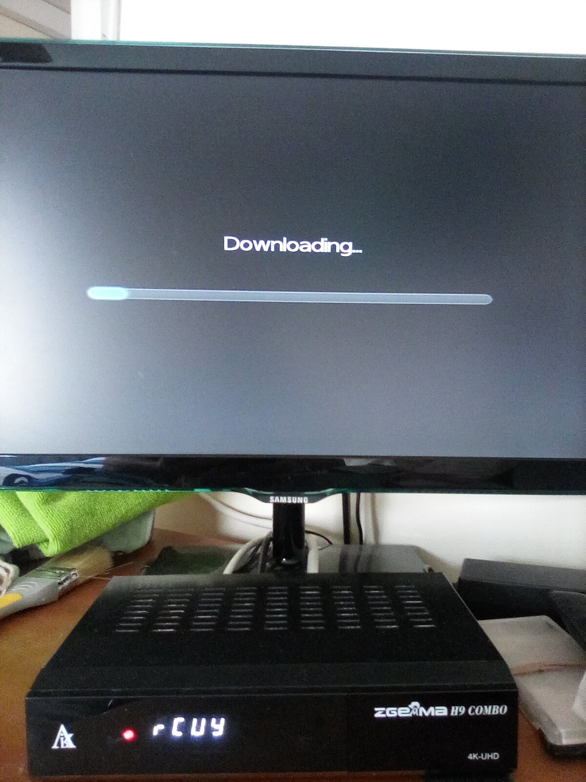

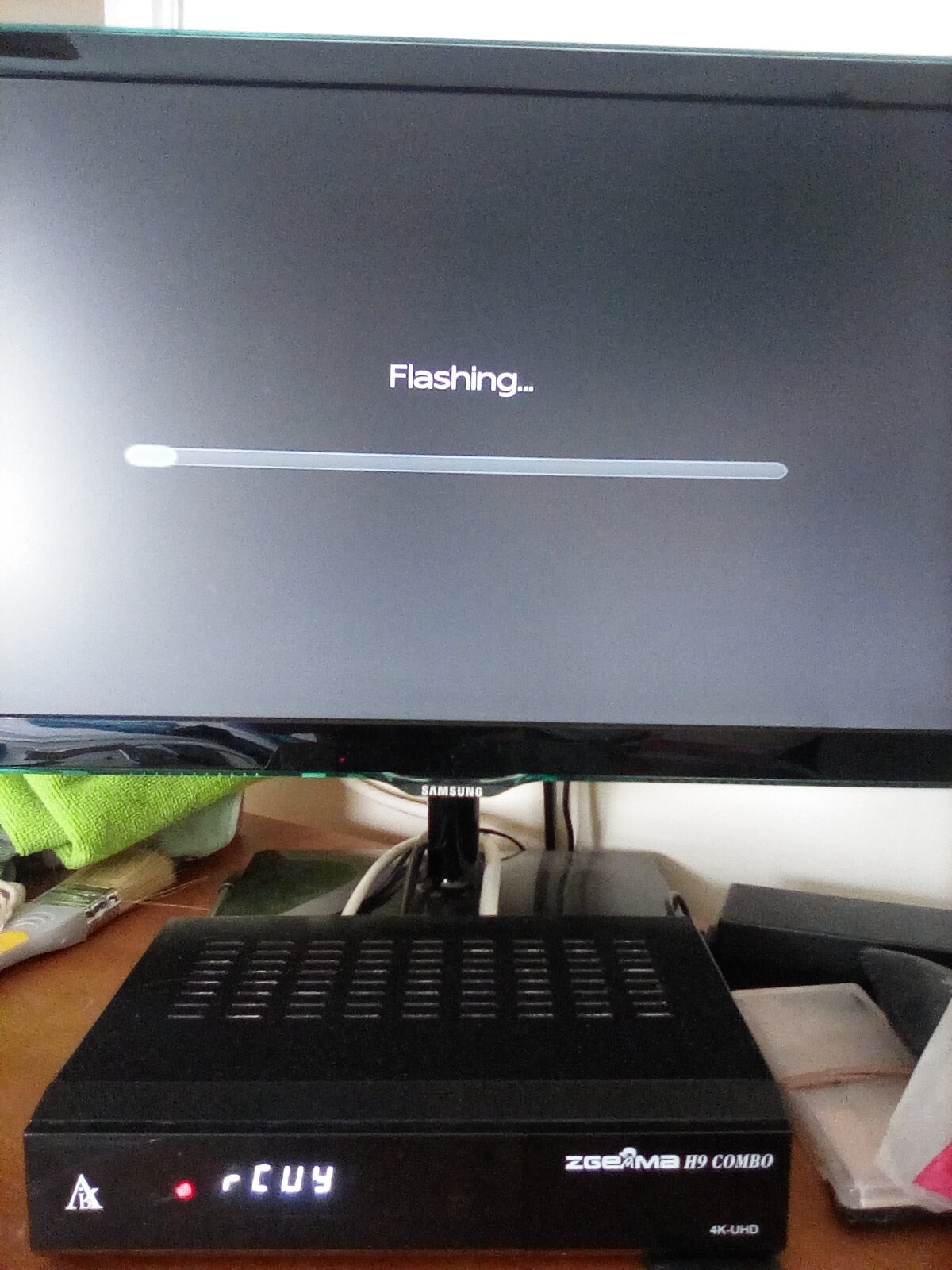

Try this method,I've just done it on my h9 combo and it took less than 10 minutes.
Turn your box off.Leave hdd in back of box.,nothing in front.
DO NOT USE BLACK RESET BUTTON.
Press the red power button on the remote down and aim at front of box.
Press and Release the white button on back of box while still holding down remote control red power button.
When you see rcvy on front of box release red power button on remote.
Let recovery menu load.

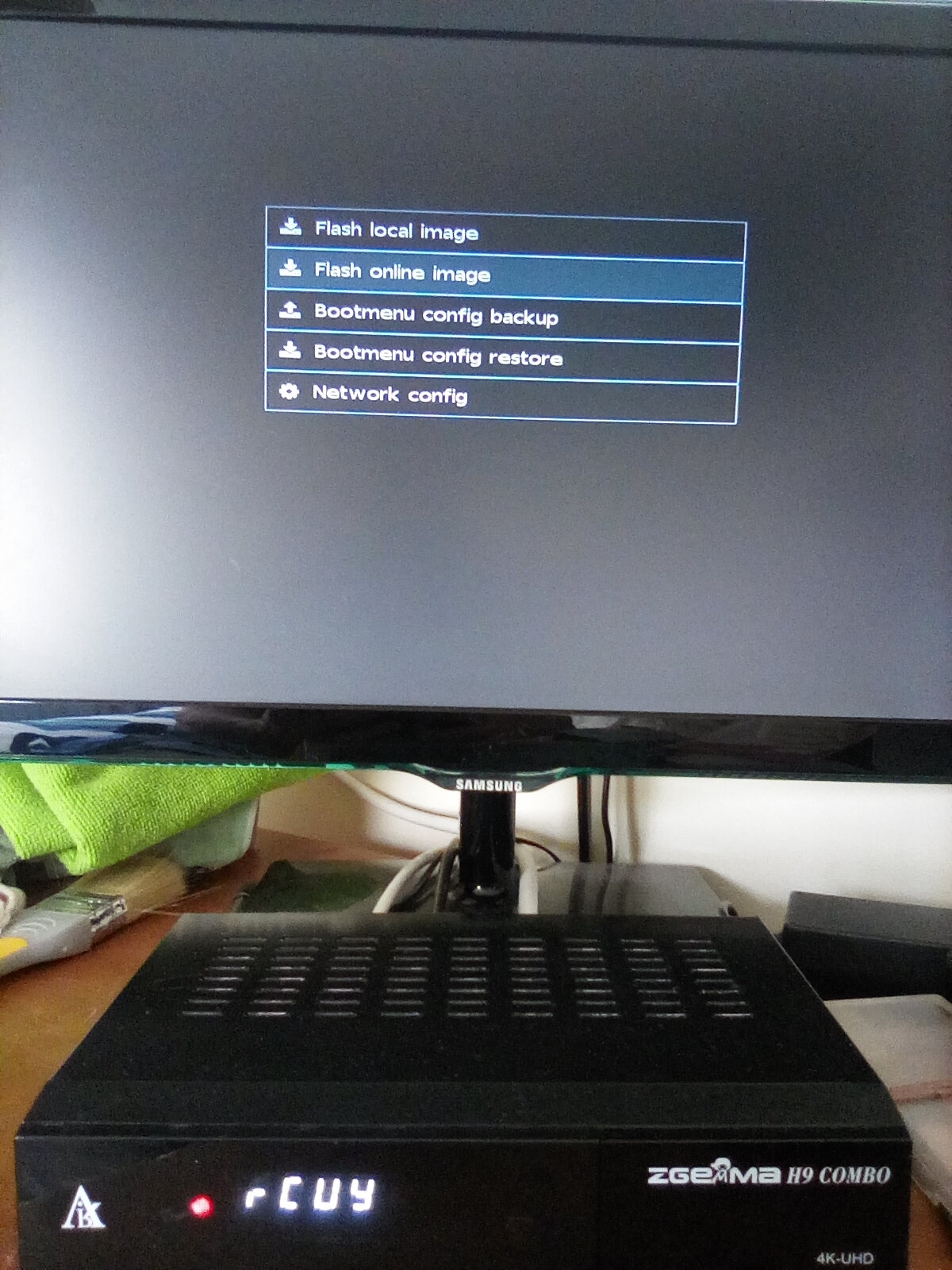

When loaded scroll down to boot menu.
Press ok

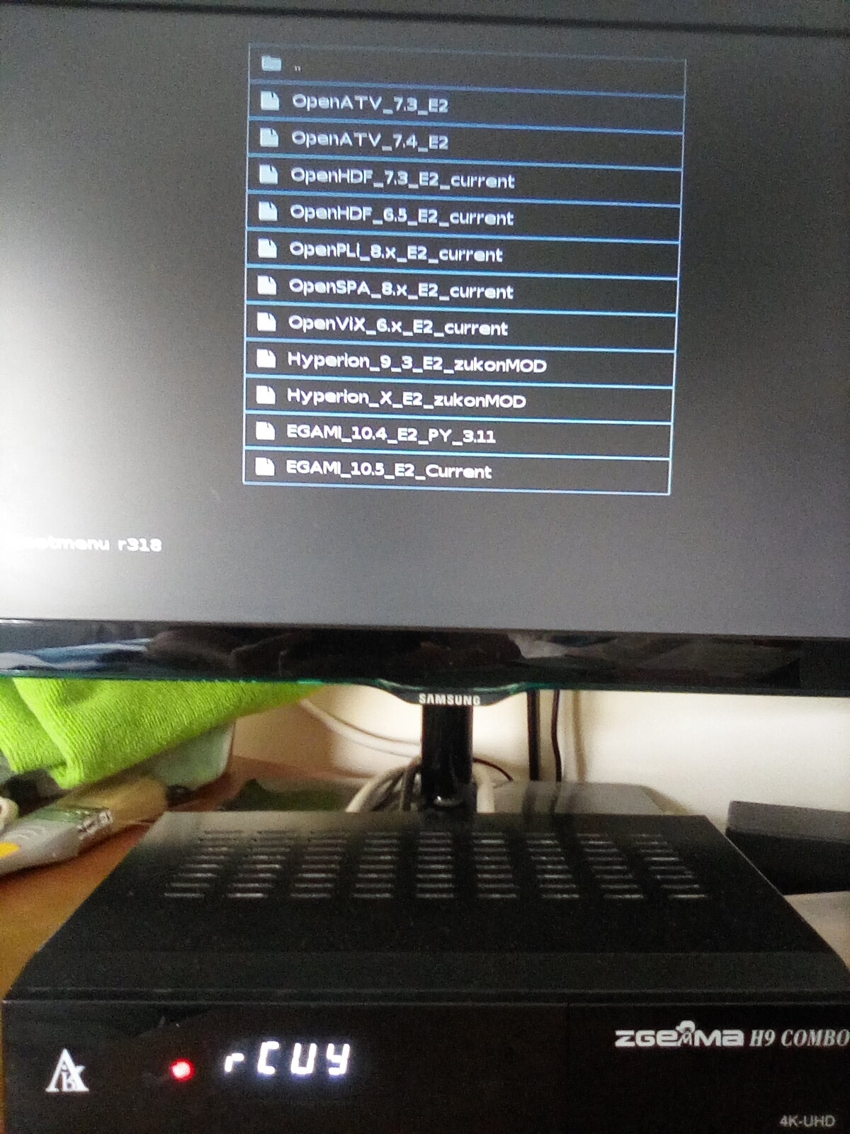

Scroll down to flash online image,press ok
Choose image you want to flash,i.e. Openatv 7.3 E2
Press ok
It will start downloading

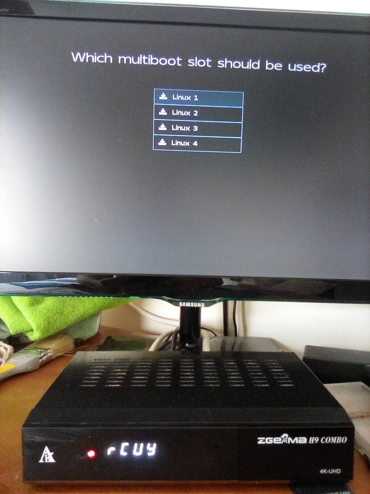

Then comes up with which multiboot slot should be used.
Press ok on Linux 1.or whatever slot you want.
It will start flashing

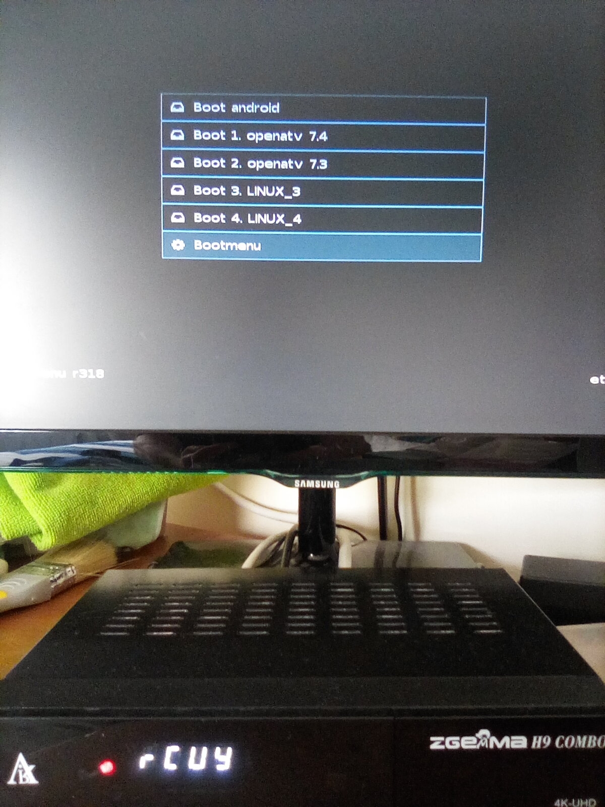

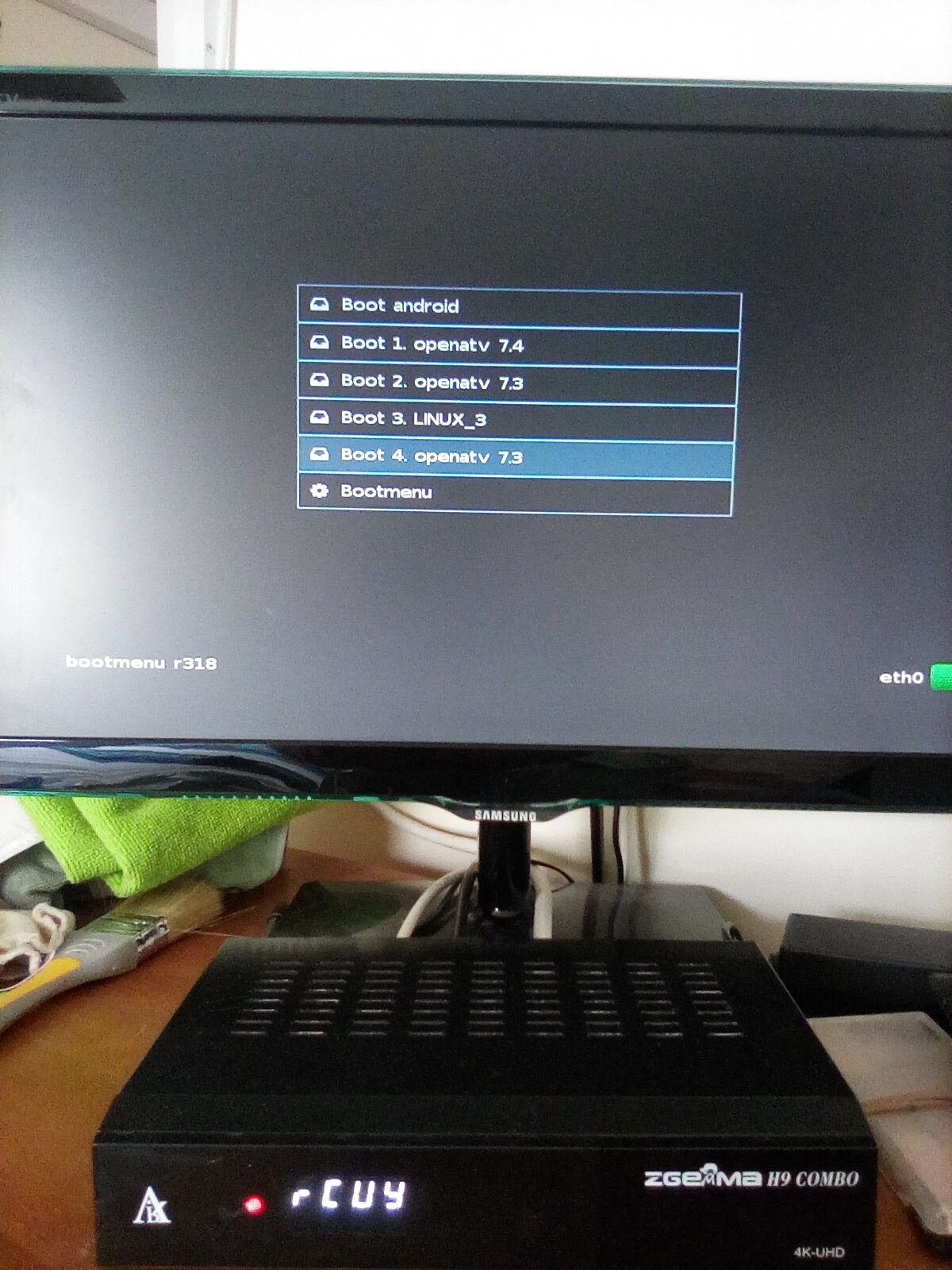

Flashing complete comes up on screen and then goes to boot menu.
Scroll down to boot1 openatve7.3 or whatever boot number you chose earlier.
Press ok
Box will start to boot up(can take up to a minute or 2)
Red light and says boot in LCD panel...just wait
Green light will come on and boot up to 49
Then go through set up options,
Might be worth initializing hdd during set up.

Cheers @bigwig21 will give it one last hurrah prob tomorrow now (cable managing my Atmos 7.2.4 system the now it's a PITA)
I don't have a HDD in the back (just a mounted 2GB USB), I assume that won't be an issue?
