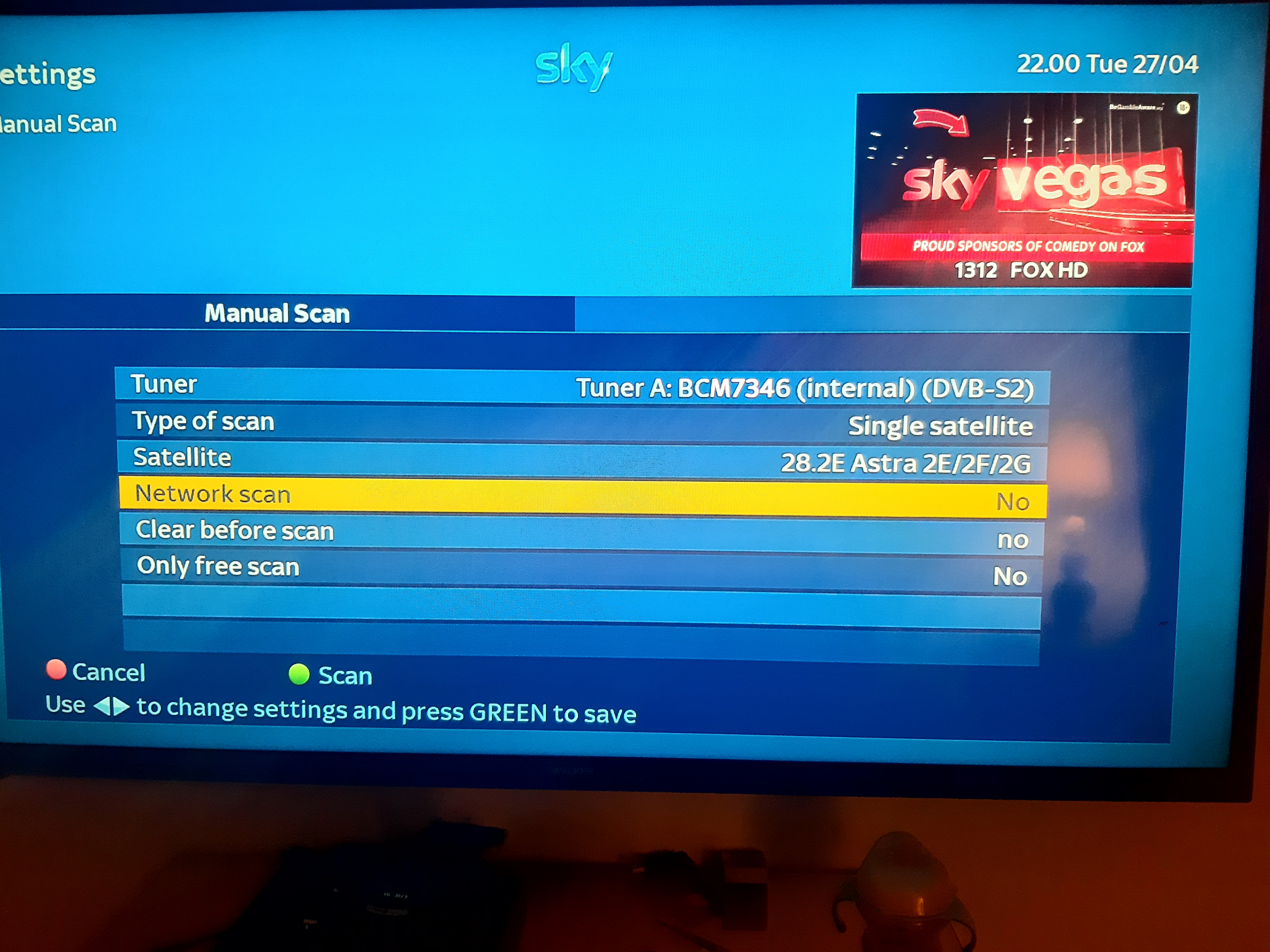

Those are the correct settings to use for performing a scan as I requested earlier. You have said that you are receiving about 100 less channels than you should.
You said your receiving the Irish version of Sky One HDs. They are on two different transponders, I don't know which is which. I asked that you to select the one that does not work, then go into signal finder. Then adjust the LNB skew or touch ends of dish to improve signal. I also asked you to attach a picture of the LNB from front of dish if you can get to it safely.
