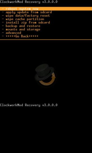

Boot your phone into recovery mode. This is done by powering off the phone, then by holding the volume down button and power button at the same time.
Use the volume up and down button to cycle through the options. Select recovery by pressing the power button, this will start The ClockworkMod recovery that was just installed on your phone.
Scroll to "install zip from sdcard" and press power button to select. Next select "choose zip from sdcard" and power button to select. Browse to where the zip file is stored, if its on the root of the sdcard its easier to find. Select the zip file with the power button and install it. Once this is finished your phone is rooted.

You may want to answer Y when prompted whether to install CWM or not. It will install the new 4.0.1.4 version of the tool.
Download the file from HERE and flash it via the clockworkmod in recovery, it will install superuser, as is done in the other HBOOT version and your phone is then rooted with a stock ROM ;)
