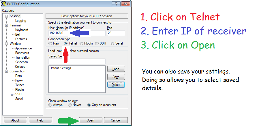

A guide on how to use Putty for Telnet commands
Download Putty from following link and install it
Start Putty,
Click on Telnet
Enter IP address of receiver
Click on Open
See attached picture

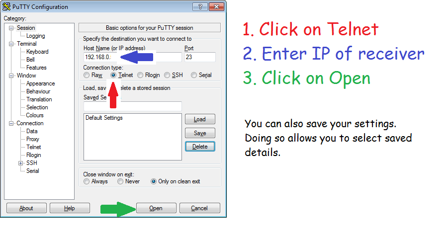

Code:
https://www.chiark.greenend.org.uk/~sgtatham/putty/latest.html
Start Putty,
Click on Telnet
Click on Open

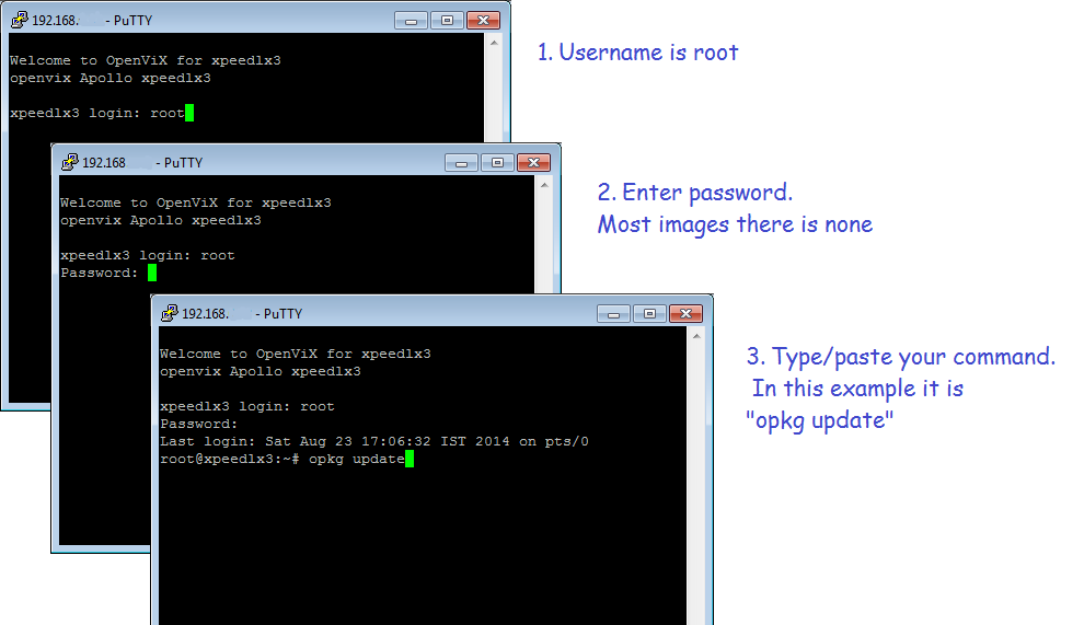

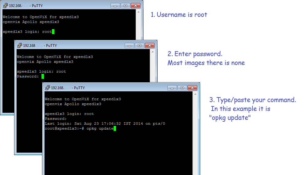

Once logged on, the default username for most images is "root" in lowercase. There is no password for most images as a default. If yours is different, perform a search on the net.
To find IP address on receiver:
Menu > Setup > Network > Device > Adapter settings. (Some images show it in the about page). You can also use the hostname. eg tmnano3t.local
You can save the details to enable quick access if your router assigns the same IP address or you are using a static address
You obviously want to issue a command someone has posted. It is better to paste than type them. This avoids errors.
Copy the command you want, right click on the putty window, paste, press return
