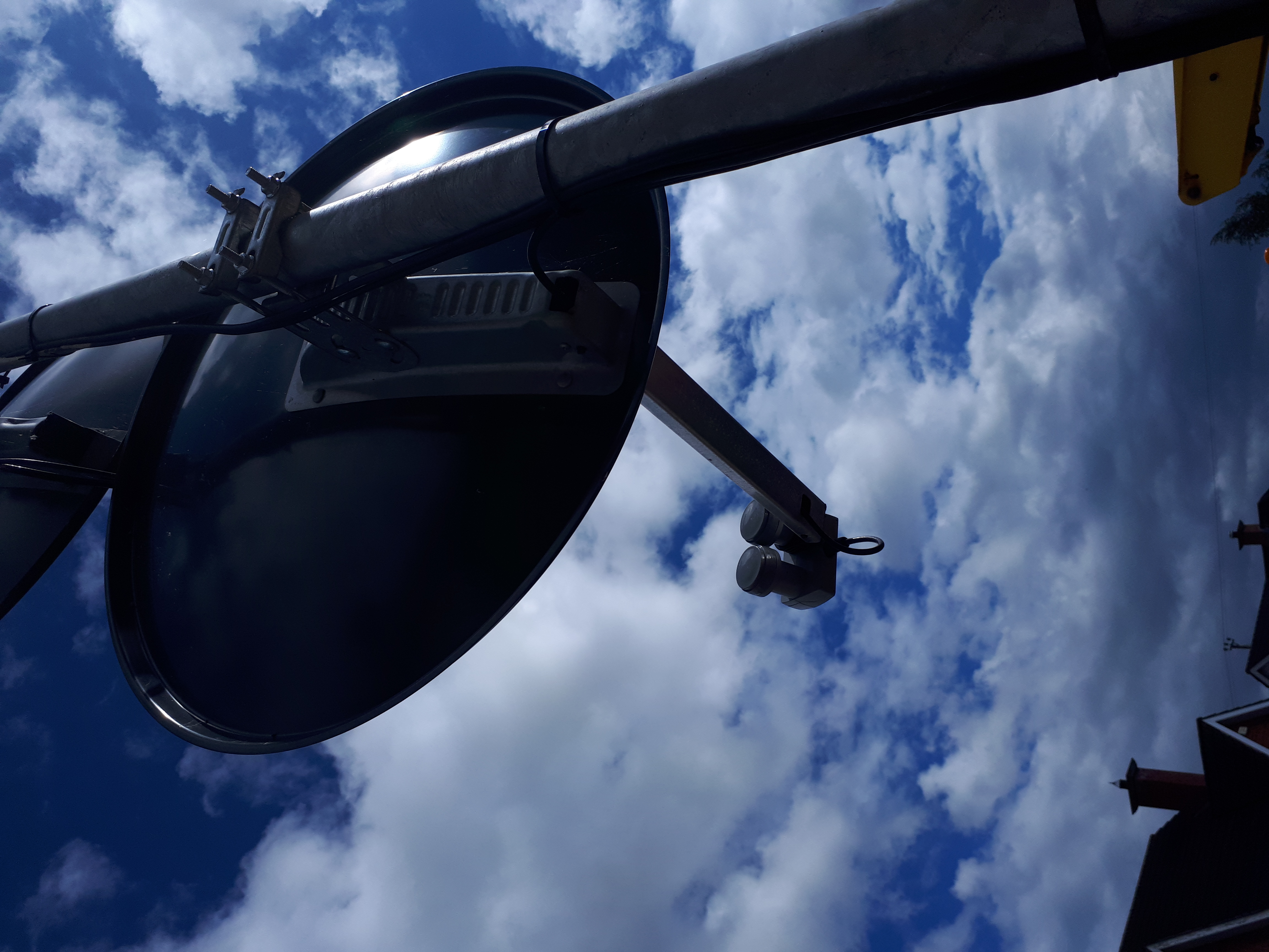

Hi I am installing a 1m dish i can gain good signal by holding the LNB about 6 inches higher than the dishes lnb holder, i cannot gain a signal when its placed in its holder. Anyone have any ideas please?
With the sattelite aligned on 19.2 (reference satellite) centre Monblock satellite meter
Connected you should be recieving s.n.r
On 13 east not 19 Skew the Monblock l.n.b
Up slightily to recieve maximum s.n.r on the
V and h side off the transponder With the
Settings correct on the reciever your s.n.r
on 19.2 should be high Thats the way the
Monblock works due to the built in switch
Isn't the focal point on a monblick determined by dish size,?
I'm no expert in monoblock , but simple science would suggest that a 60cm dish has a different focal point than a 1m dish, so a monoblock designed for a 60cm dish wouldn't work on a 1m dish, or am I talking shyte as usual,?
btw, the bigger the dish, the more accurate your alignment needs to be, even if that does defy logic ,
