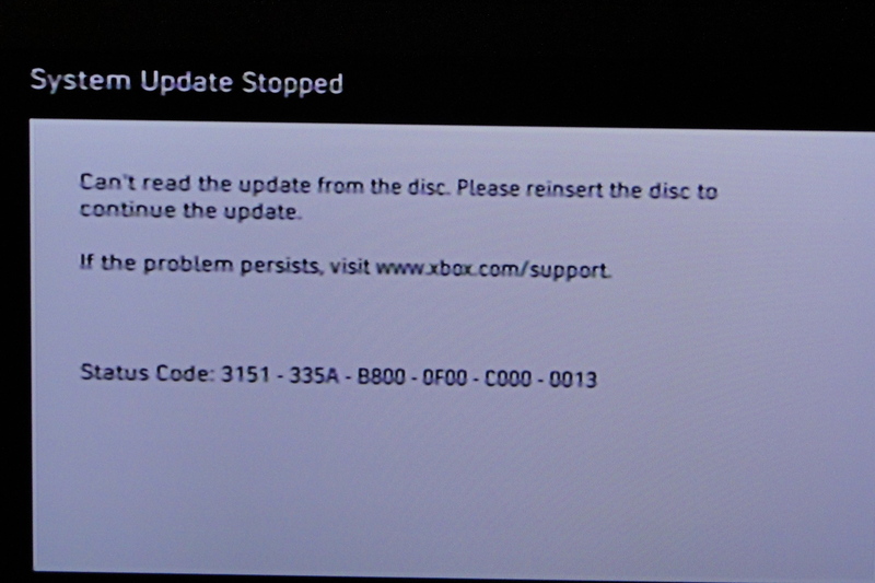

Okay Axxxo, you were spot on, it seems to be an update failure, when you turn on the XBOX, it says "applying update" for about 1 second, then you get this screen
when I go to XBOX.com support pages, I find this explanation for the Error/ Status code
Now the problem that I have is that, he has repeatedly tried to reinsert disc, he even went and hired the original, and couldn't get the update to continue.
I can't get near the dashboard to clear the cache. I imagine that this box would be on the Ban list if it were to be online for any amount of time, but would it be safe enough to attach a lan lead, to try to get it to download the update from microsoft directly??

Its always best to stay up to date with firmware even if the xbox is banned or just for offline.you could try applying the dash update via USB to see if that will help and you wouldn't have to connect to live either, info on that is in the picture you posted :)
Depending on the drive model, the update will flash the drive back to a different stock firmware, which you probably already know. Advice given nearly always just to be safe is to flash back to stock, update dash and then flash back to cfw.

Okay, so you will be glad that I have found a solution for this one.
I read around and heard that I could download the update from Microsoft and update from a CD/USB/DVD, I downloaded it and tried from both aCD and a USB to no avail.
I read that I could flash back to stock and try again, I did and it didn't work.
I then reflashed to the latest LT 1.9 and tried to update from the Backup Disk that caused all the trouble - AND Bingo, that worked.
So for any one else that comes across this problem, the solution is simple - update your firmware to the latest and then continue with the original disc that started the update.
