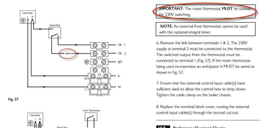

how do I know about the 230v stat?

What boiler do you have,?
The stat you have you could take the L out to bk1
But, its not wireless , you have to hard wire that stat to the boiler,
To get what I think you want will need a hive or similar, and they are all sh!t tbh.
