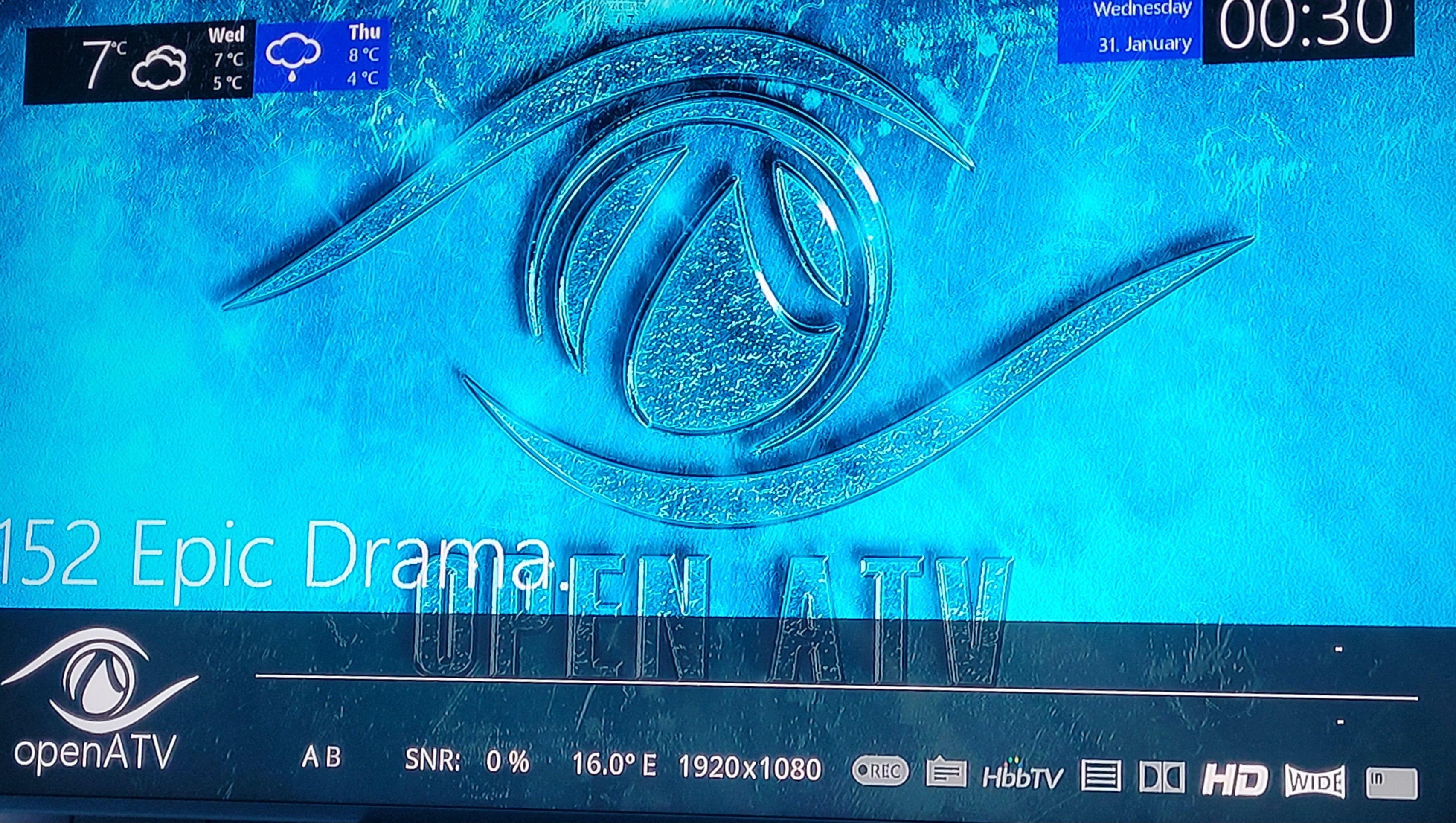

Vu+solo2 atv 7.3 using iptv and blurry picture

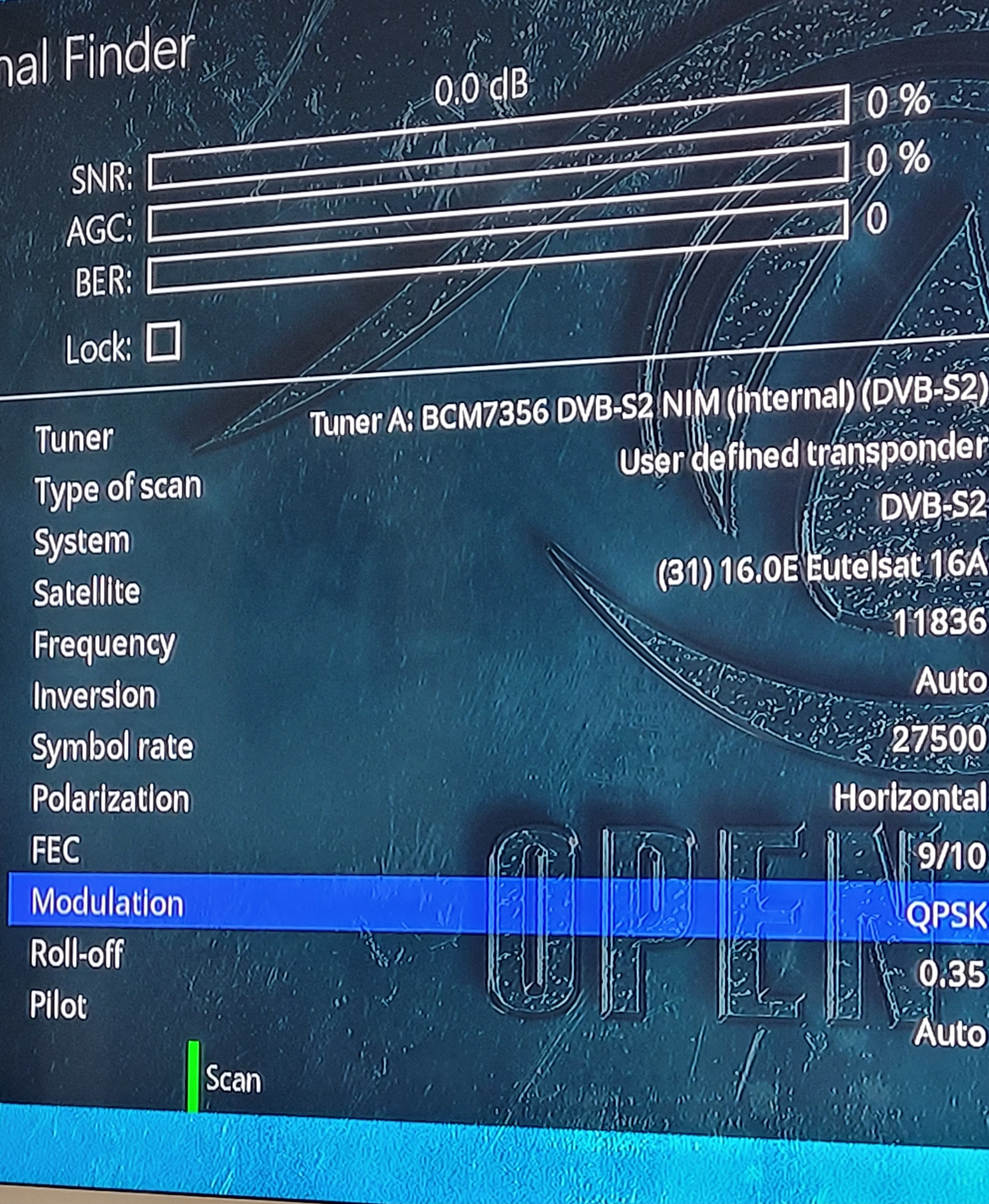

What do you want members to do , have you tried pressing menu button then go to setup > reception signal finder or even try manual scan.

Signal is not showing anything
Thats only a display screen or boot screen press button under ok button and any listing to choose from.

Do a screenshot of page after you press the button under OK.

SNR 0% ??
I would suggest to go into signal finder to check what your not seeing and is your channel list upto date?snr.jpg

If you do a satellite scan not a transponder scan does it pull any channels in ?
Can you show us your Tuner setup please a photo will do.
And have you tried using the 16 east cable on tuner B ?

If you do a satellite scan not a transponder scan does it pull any channels in ? = No channels
Can you show us your Tuner setup please a photo will do. = Yes pictures
And have you tried using the 16 east cable on tuner B ? Yes without any success.
