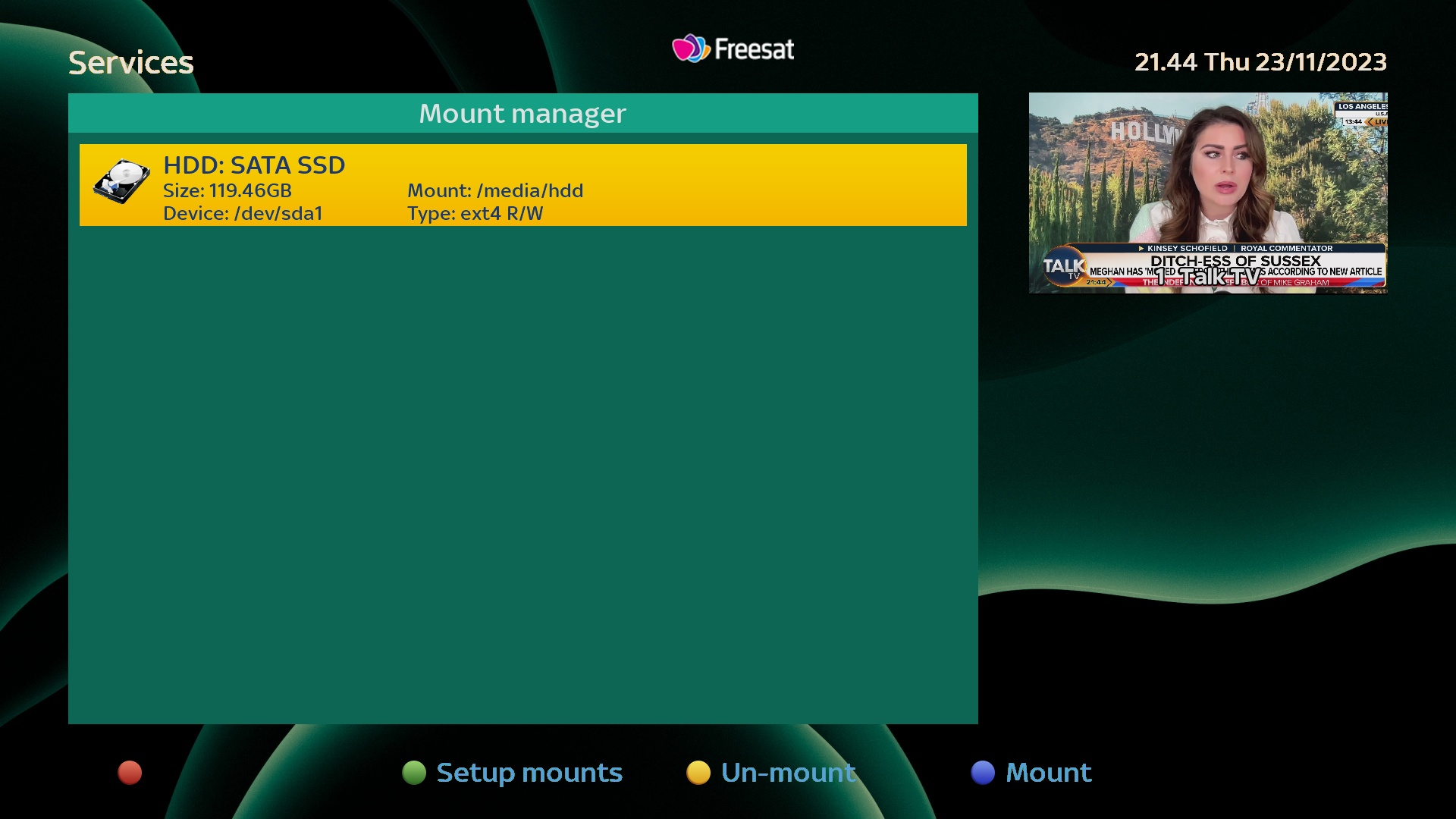

usb transmemory mount/media/hdd mate? thanksWhat is your USB mounted as?
MENU > SETUP > VIX > MOUNT MANAGER
Logs are also being written to /media/hdd/ as well as epg.
its got type ext4 r/w if thats it?What format?
It's already initialised then.its got type ext4 r/w if thats it?
