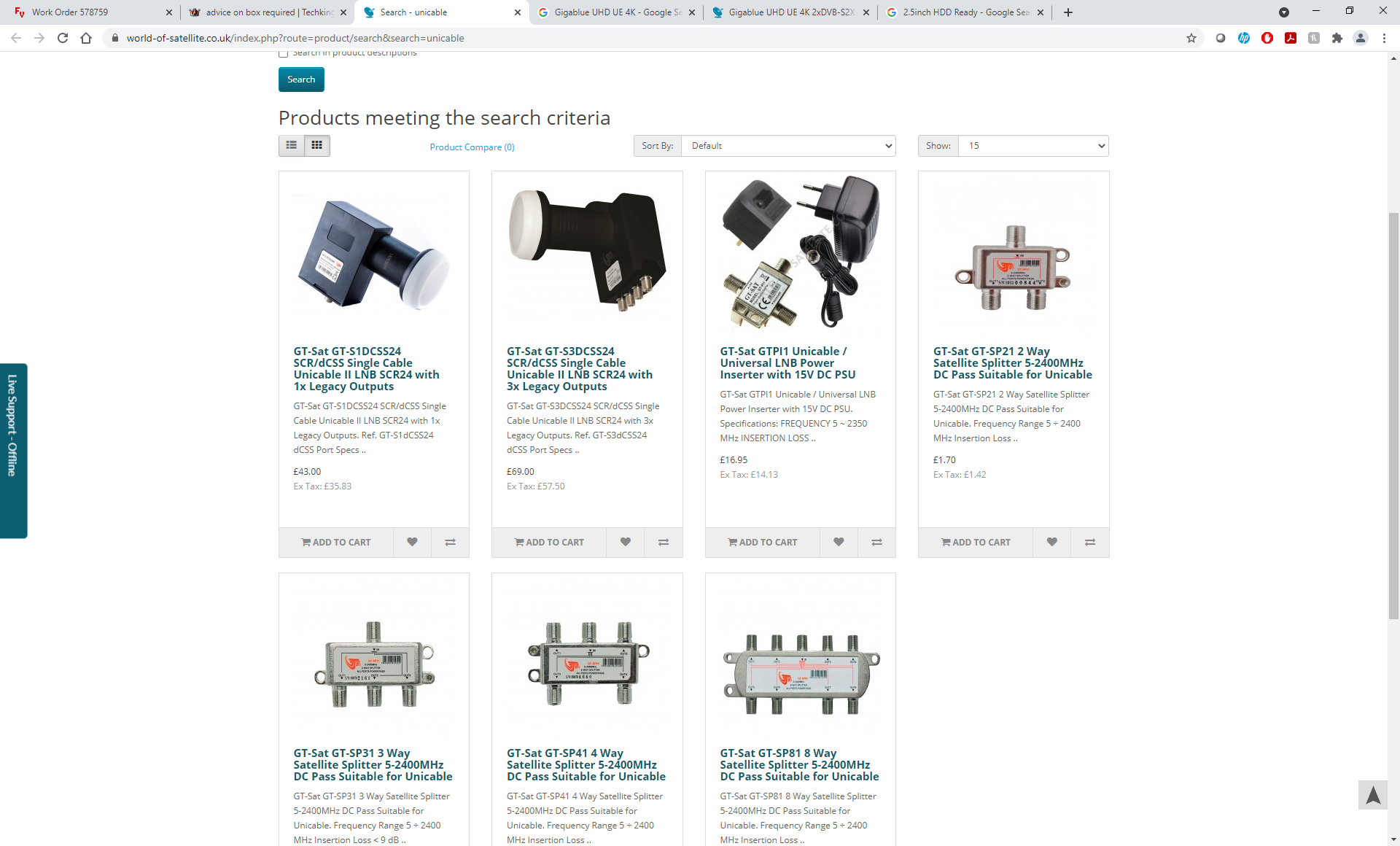

thanks. which one do I need? and how easy is it to change over?
Willo3092
The first one will do and you'll need a splitter and lnb adapter. There is info in the thread I linked to.
