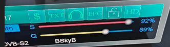

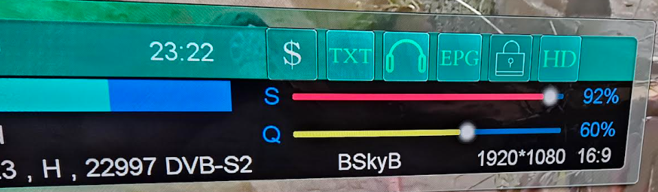

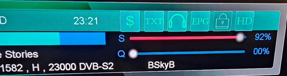

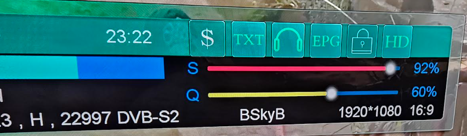

So is it a mix of H and V polarity channels?
If so do as ferret says try fine tuning.
If it's only H or only V polarity then it's lnb.

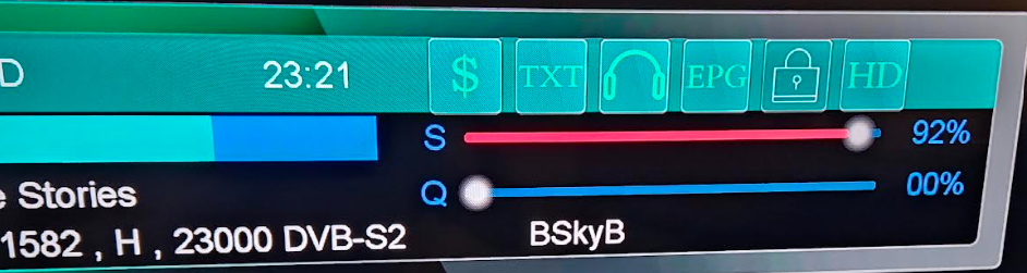

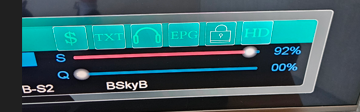

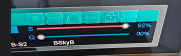

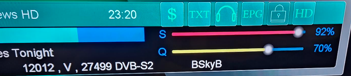

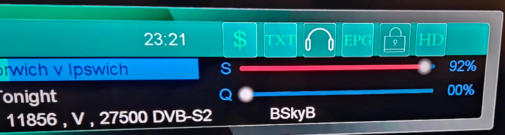

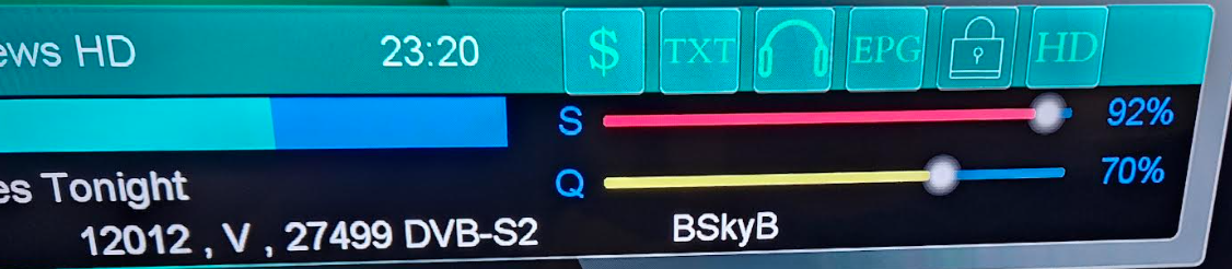

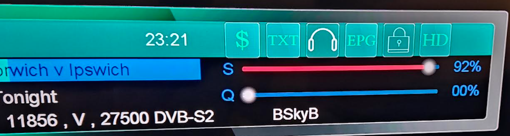

Yeah mix of both polarity. All have signal around 92% however on the channels that aren't working quality is zero. For ref on the channels that do work it's between 59% -63% for quality.

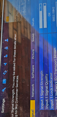

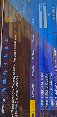

An update , setup and old TV outside and used the old skybox as that has a constant view of the signal ( I couldnt find similar on the viark sat 4k).
I did get the signal quality quite high on the sky box at the slight expense of the signal strength although understand quality's the important part. Slight improvement on the viark channels that were working. However still 0 on the channels I'm having issues with. For ref the sky box said no signal on the channels that I'm having issues with
I have ordered a signal meter to try and fine tune a bit more , hopefully should come tomorrow.

And as Manic said you are 100% sure you can view both V & H channels?
How have you got the LNB setup on the Viark and are you sure it is a universal LNB and not a SkyQ LNB on your dish ?
Yeah i think its a mix of both V&H, my understanding is that V or H that show when you switch channel which is what i'm basing that on. I've shared images to be sure of both working and not working just to be sure.
LNB is 100% not SkyQ, its been up untouched for 11 years and was working fine until now
I was starting to think it might be the viark receiver myself however freest on my TV has the same issues with the same channels - Both from different cables as the LNB has 2 outs and a shotgun cable one into viark and one into TV which would also seem to rule out the cables. Its worked fine from September with no kit changes in this time.

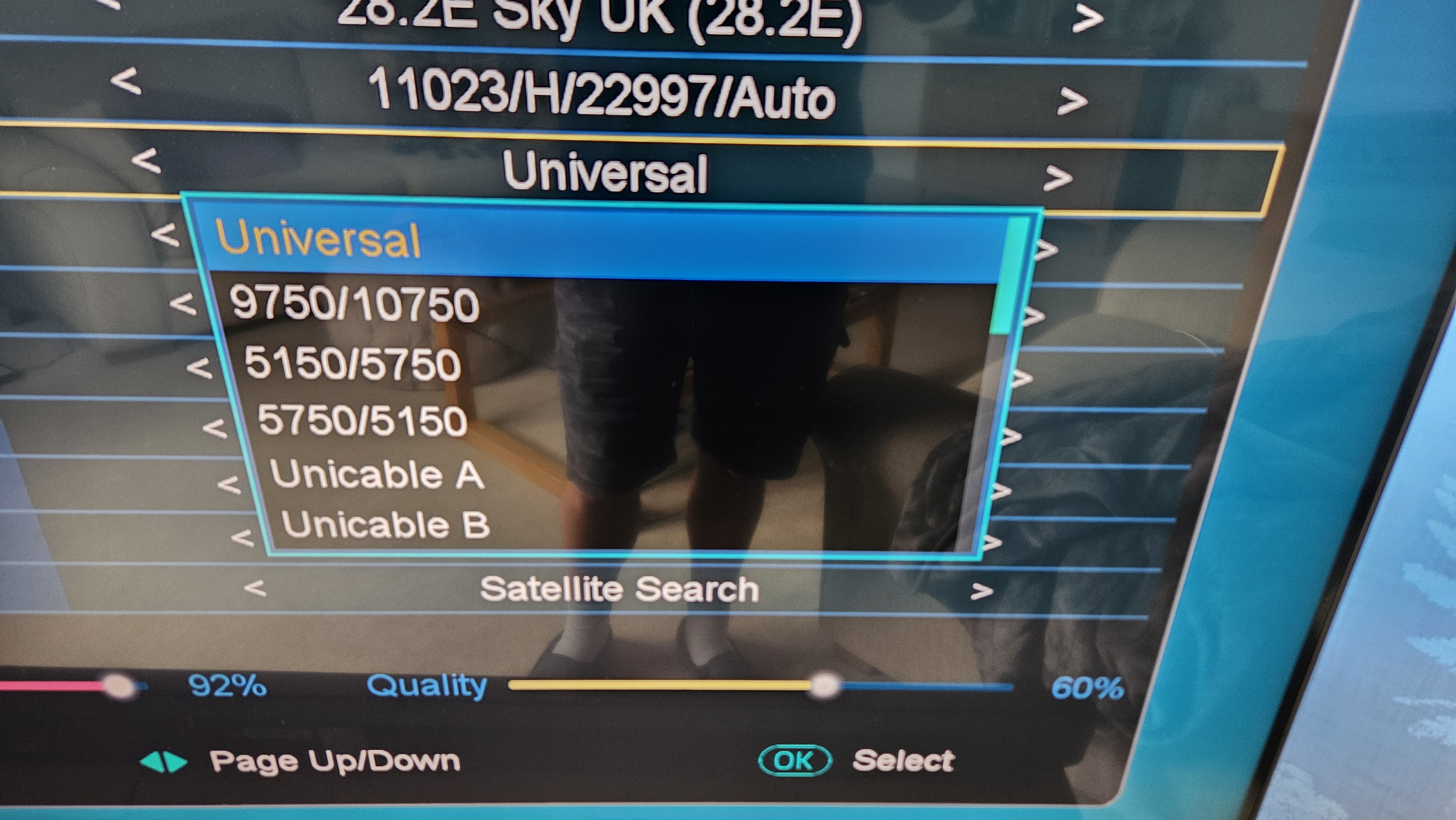

Pic of how you have the LNB setup on the Viark please

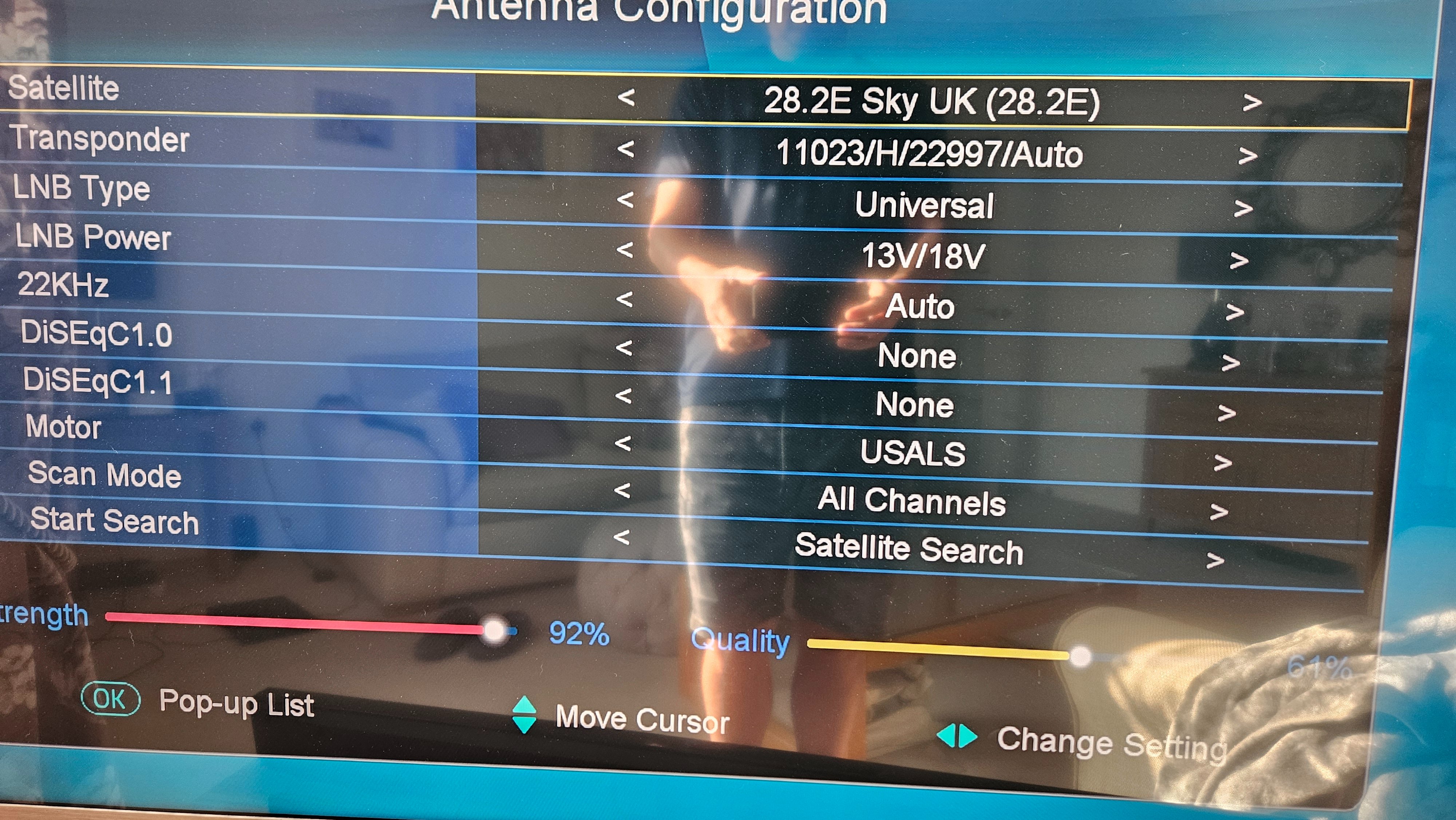

Something that could also be wrong here
Lnb settings attached.
Scroll to the UNIVERSAL but press ok
Show us a pic of that please.
Something else that could be out is band switching you may have signals on H & V but if the LNB is not switching bands you would get this issue also.

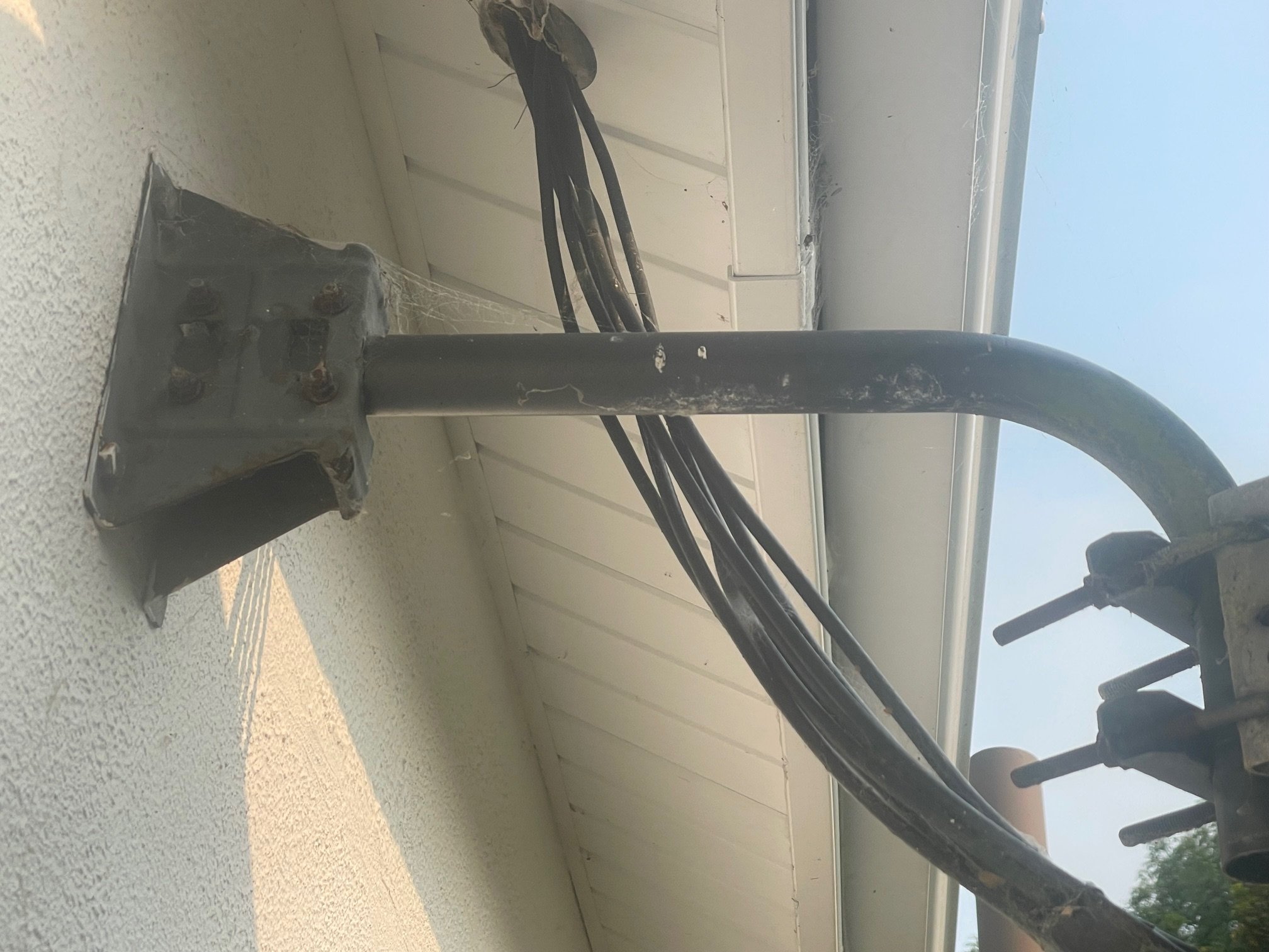

Moving arm up and getting better quality would mean dish elevation needs a tweak. Depending how you have dish mounted but there is a bracket on a sky dish that can droop over time and its hard to spot. here is a pic of a sky arm, dish is triax but the arm bit dropped over time, it was minute but spirit level would show it, once levelled all good. Just a thought.
