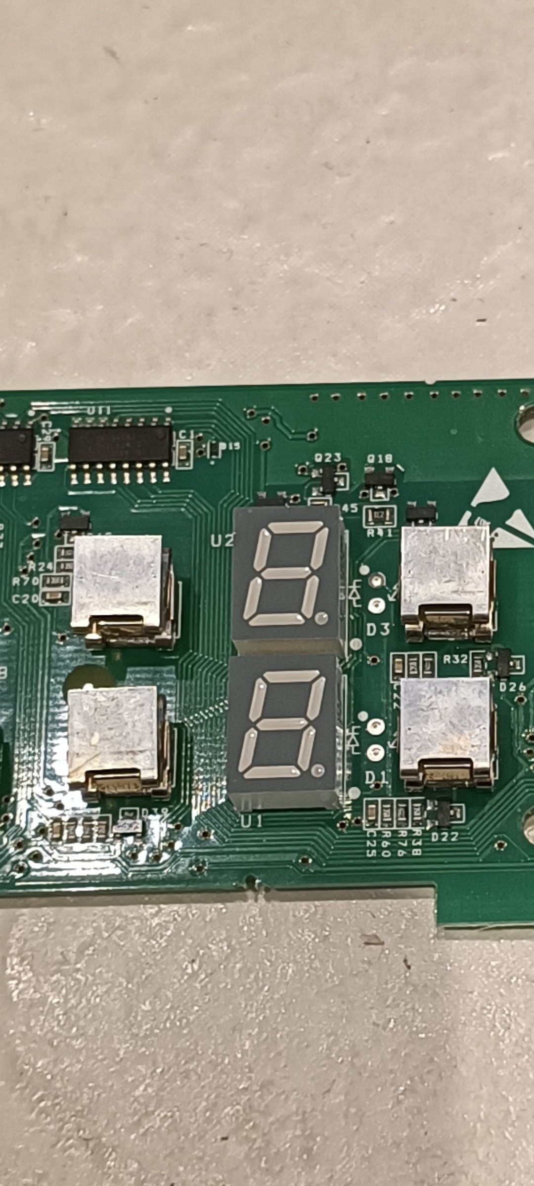

A lad I know said do this
"Hello pal, flip the glass off and clean the underside of the glass were the touch control board sits for the buttons. Also degrease the metal contact buttons and just ever so slight extend them there light a consetina you'll see but only 1mm - 2mm. If you have an oven below you can get a steam and junk build up that effects the control touch board/glass/ your finger contact".
So this morning I took it apart and the underside of the glass was abit greasy but the metal touch buttons were worse. I cotton budded some isopronol onto both and it's working fine,
For how long I don't know but now I think of it, if there's muck or grease between your finger and the top of the glass you would clean it but you can't get access to the board and underside of the glass.
This might be why it randomly worked then stopped. I just thought I'd mention it as it must be a common thing with all makes and even ceramic touch hobs.

You can see the grease so I'm hoping a glass and button clean sorts it
