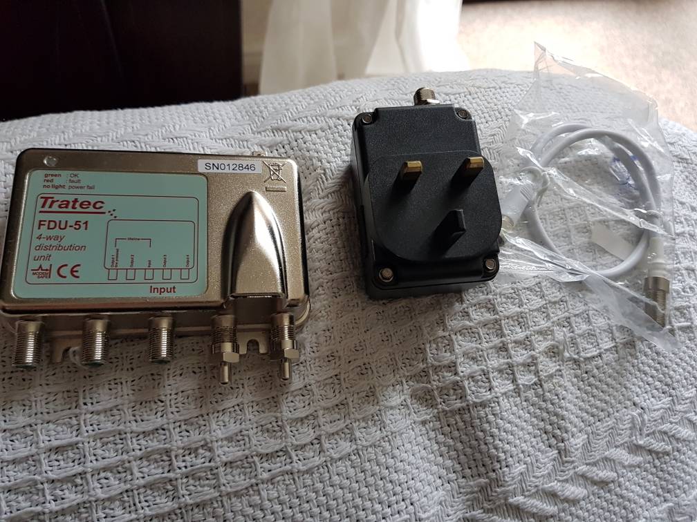

Hi guys,
I've just got hold of a fdu-51 amp, can anyone advise how to install, dunno where the psu installs
TIA
Sent from my SM-G955F using Tapatalk
Yes I can it's designed to go in the brown box outside. The connection "input" is the feed from the street cable. Then output 1 would be like your vm router lifeline. Output 2 Stb box etc etc. If you don't use all the ports just cap off with those terminators you have. You need to be able to get direct line power the FDU. I used a different fly lead to connect the power with just screw type on the end.
oh wait hang on that's weird, sorry sent reply from phone didn't see that picture from that side. You`ve got no direct line power in ??? looks like you have the reverse line powered model. So I'm guessing you need to use (whats inside the white box) the connections from the isolator?
Thanks for the reply think I sussed it, put the line in into line of the fdu, psu to a/c of the isolator, the stb connector is not connected then the connector is the isolator to connection output 4 of the fdu
