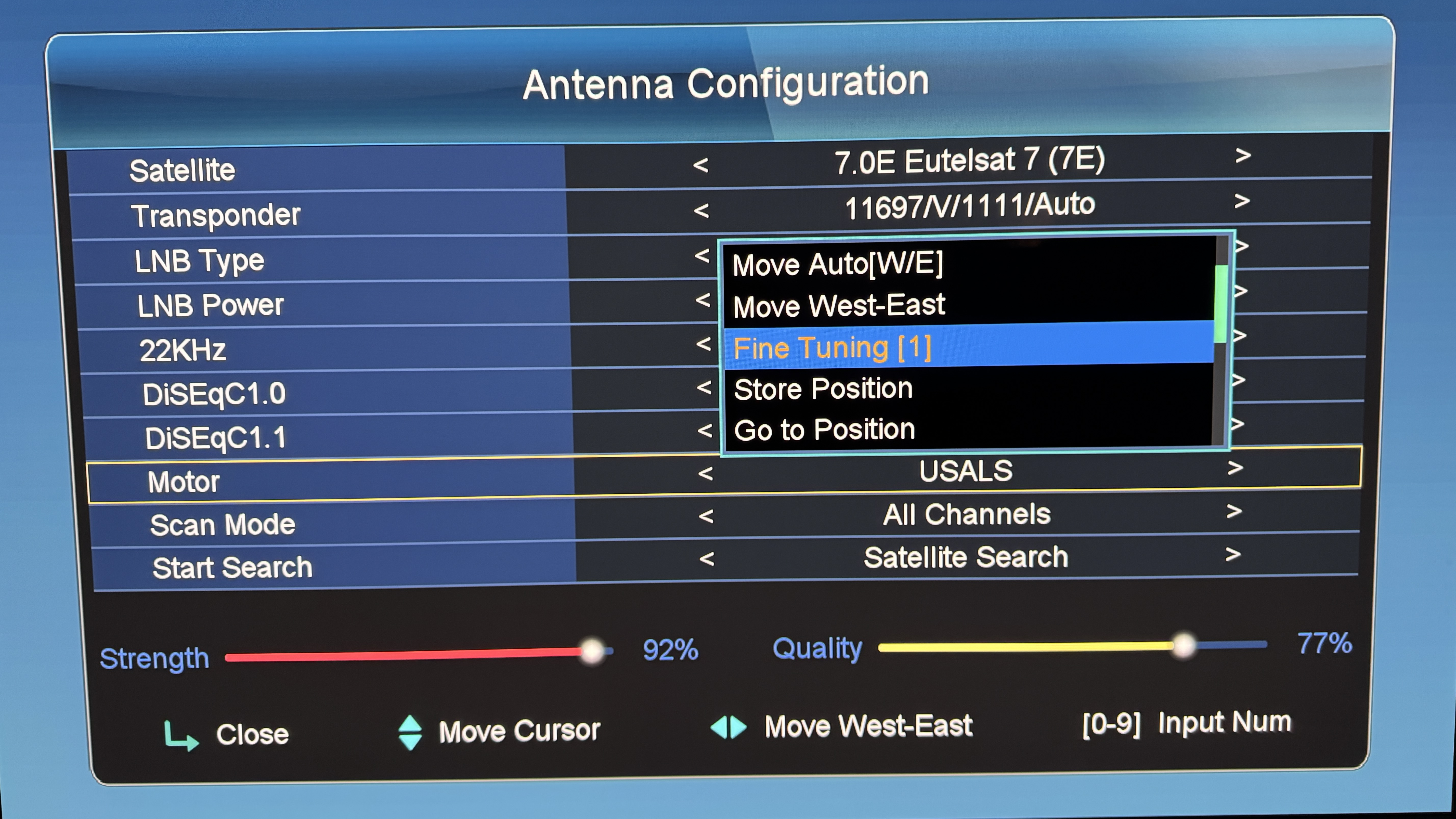

This is the strongest tp on 7e, thanks to barney115
Scan that in and nudge to its peaked
Strongest TP on 7 East is 11697 V 1111 - BANG-1 - BANG-13 FTA Radio Channels
Adding that one gives me a signal straight away. Nudging it it 3 or 4 times E or W only degrades it to 76% from 77% though. And going futher either way makes it worse still.
Then 7e looks like its aligned ok. Just because you can get that tp doesn't mean your dish is big enough for all 7e feeds

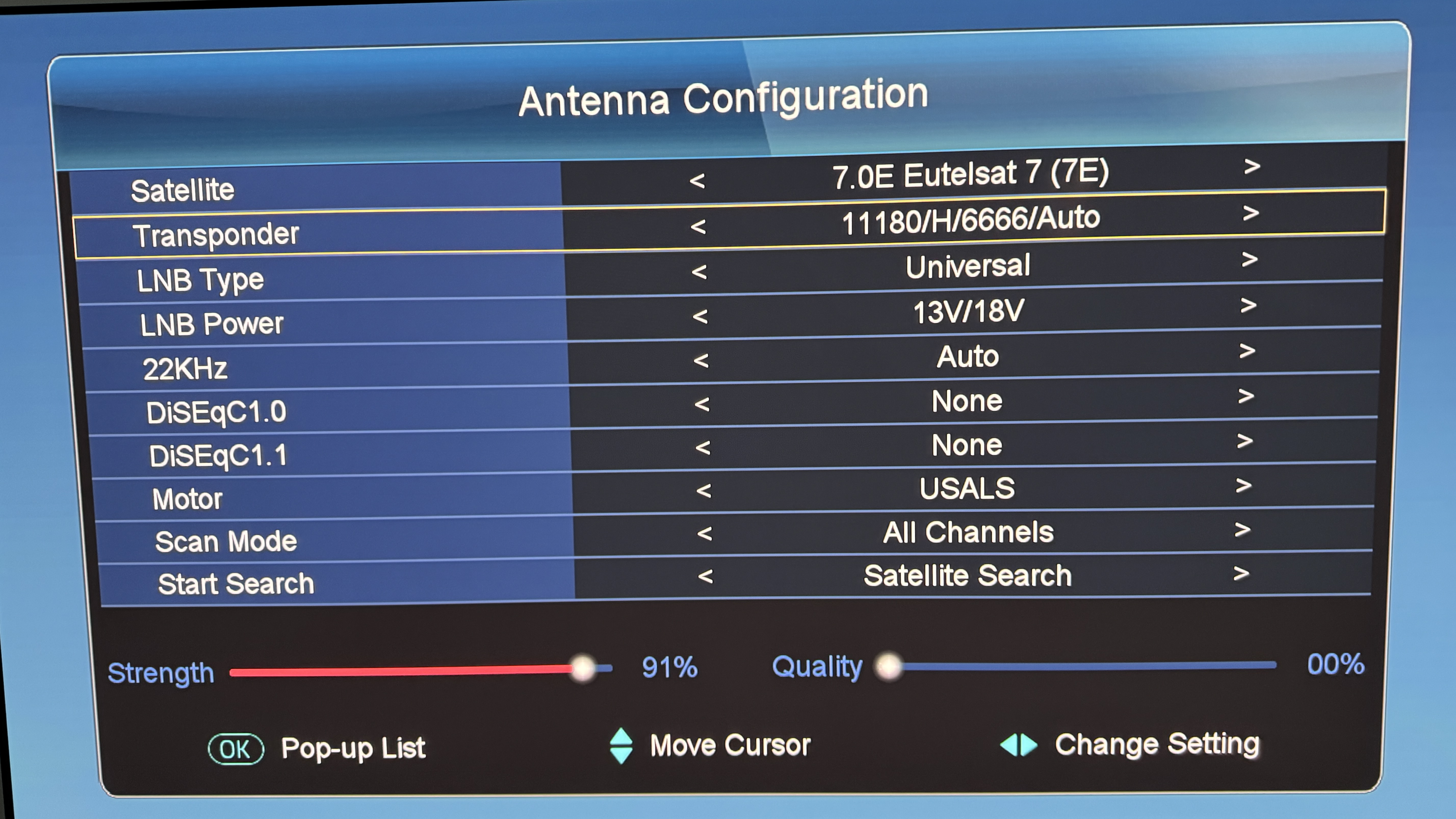

Many thanks. It's just strange - I used to be able to pick up boxing feeds posted in here - It's just that when I've tried over the last few weeks, I've had no luck. This one for instance, I get nothing. I'm certain I also tried something a little while back that I found on 28.2e & couldn't even manage that one.

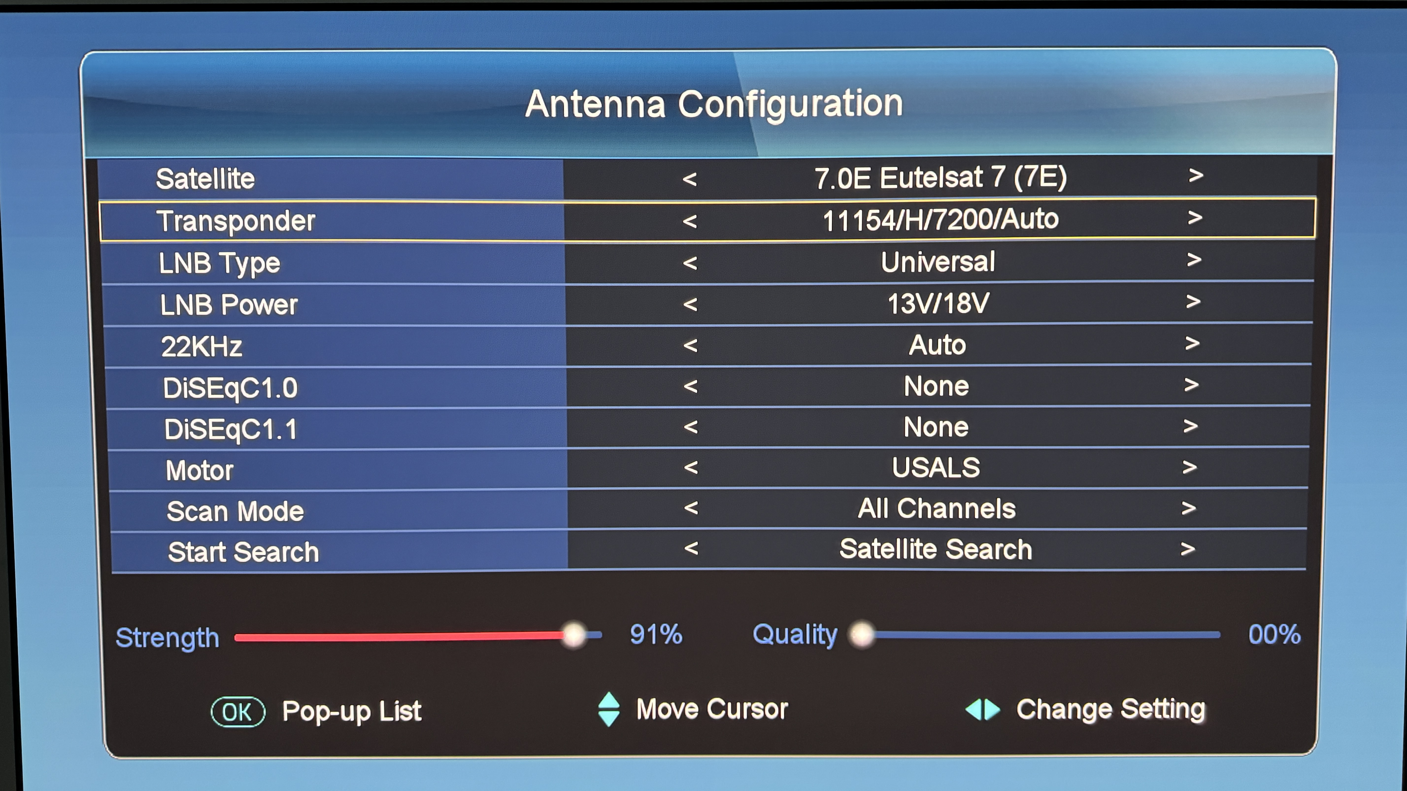

Can you get this feed?
Biss Feed Keys - Football Feeds Live On Satellite.
Rangers v Celtic
7e
11154 H 7200
ID:GCUK Enc 2
Its clears ok for me but very weak signal here on 110cm dish wiltshire

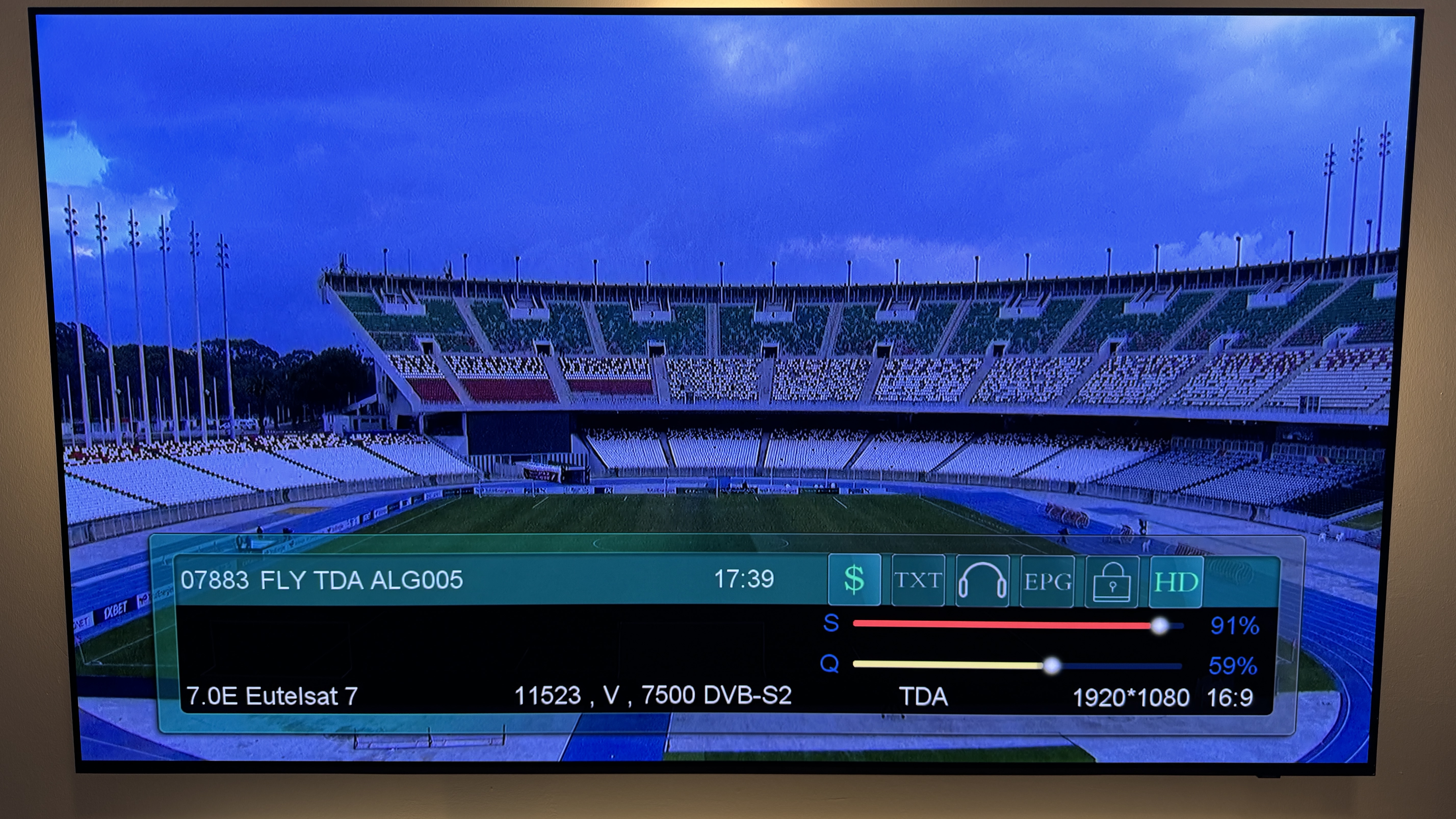

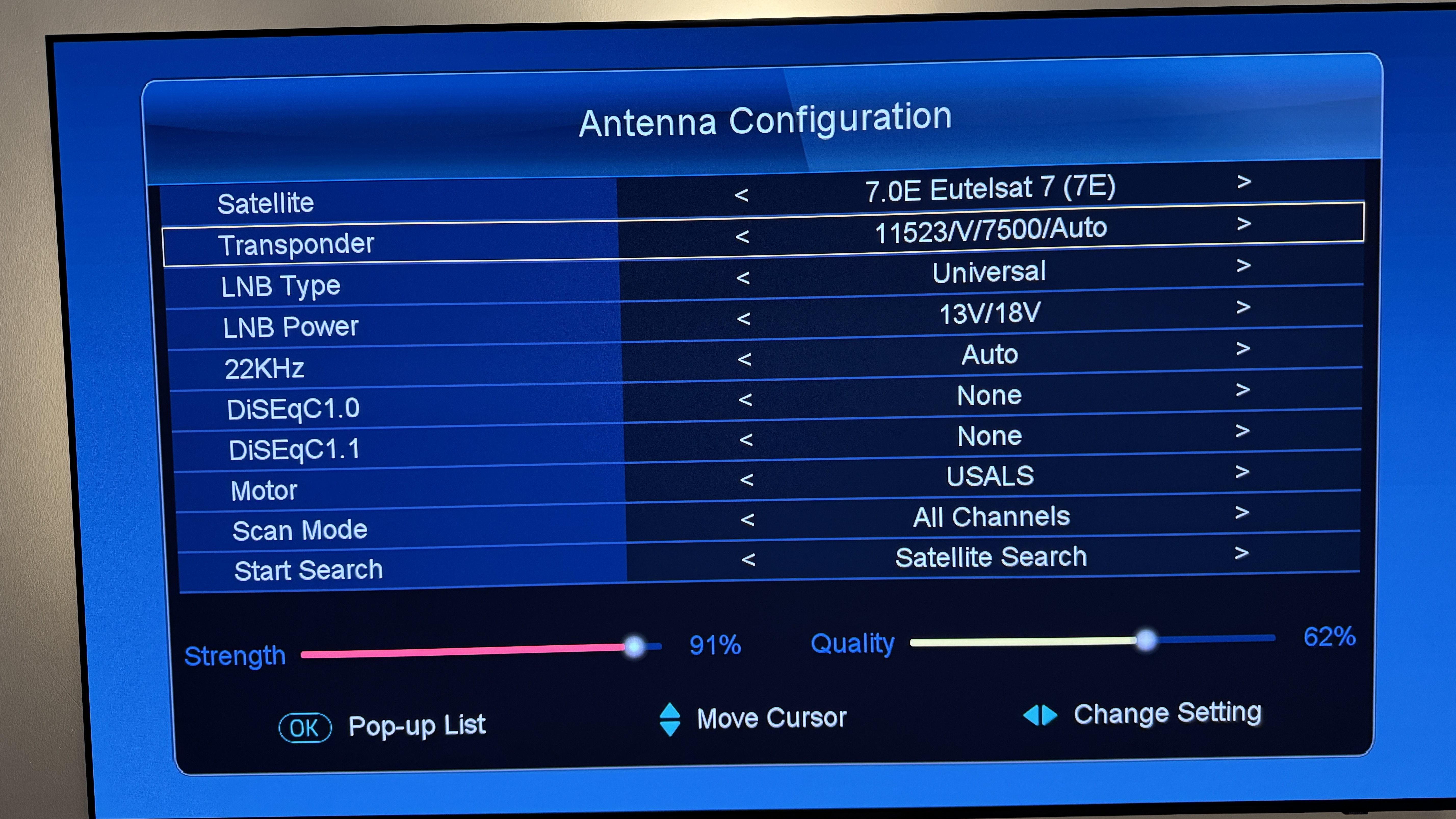

Try this, its stronger
7e
11523 V 7500

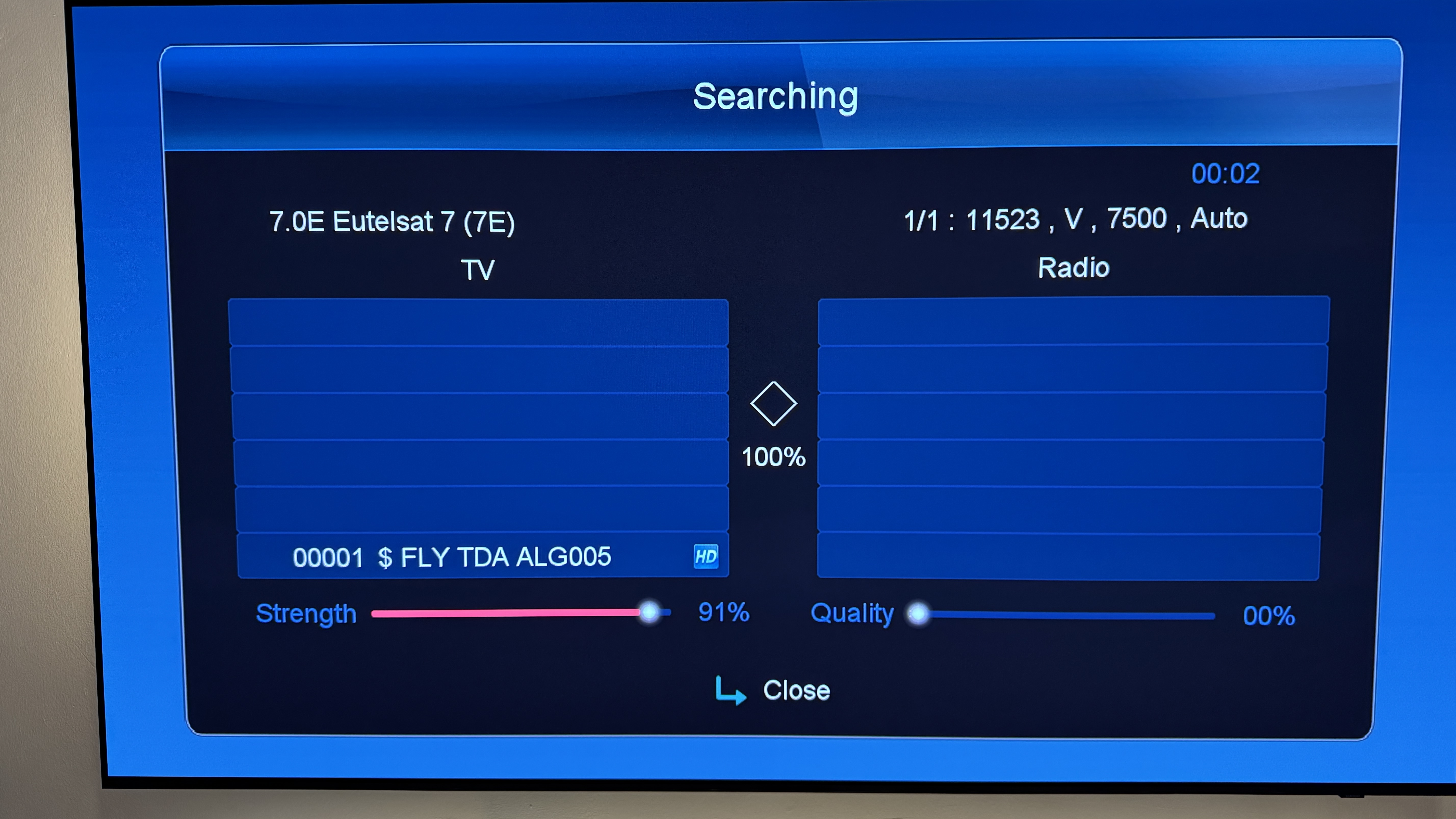

ID: FLY TDA ALG005 (TDA)
Yes, I can find that one. Nudging it E or W only makes worse again though.
