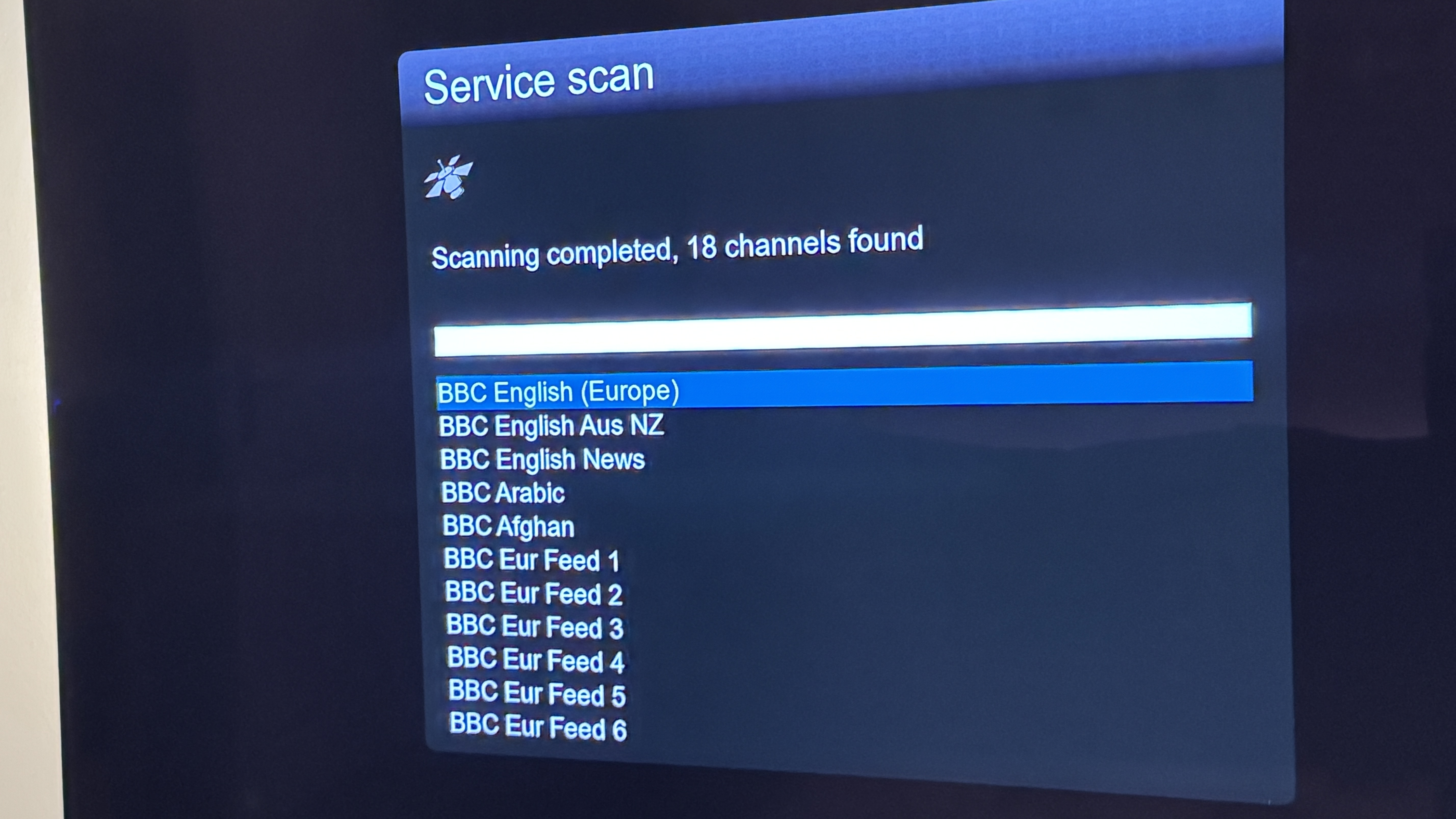

Having scanned 7e, I only pick up 19 channels - mostly radio - and all apart from the final one are V not H. The H one SNR fluctuates on opening but after a few seconds settles on around 75%.

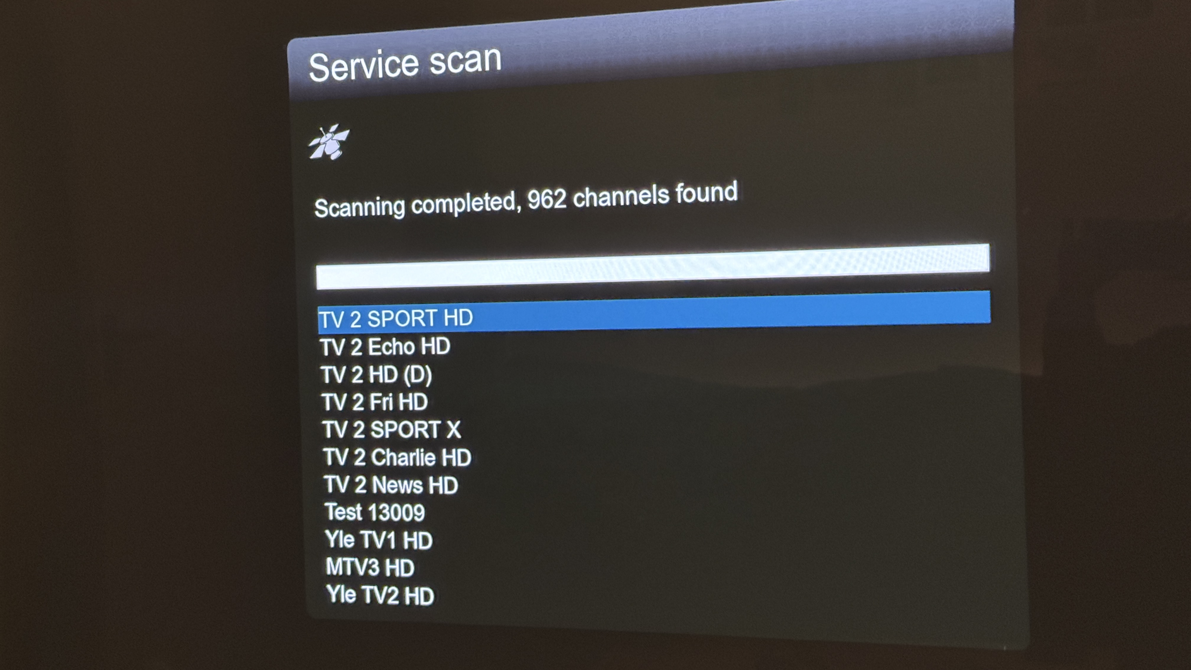

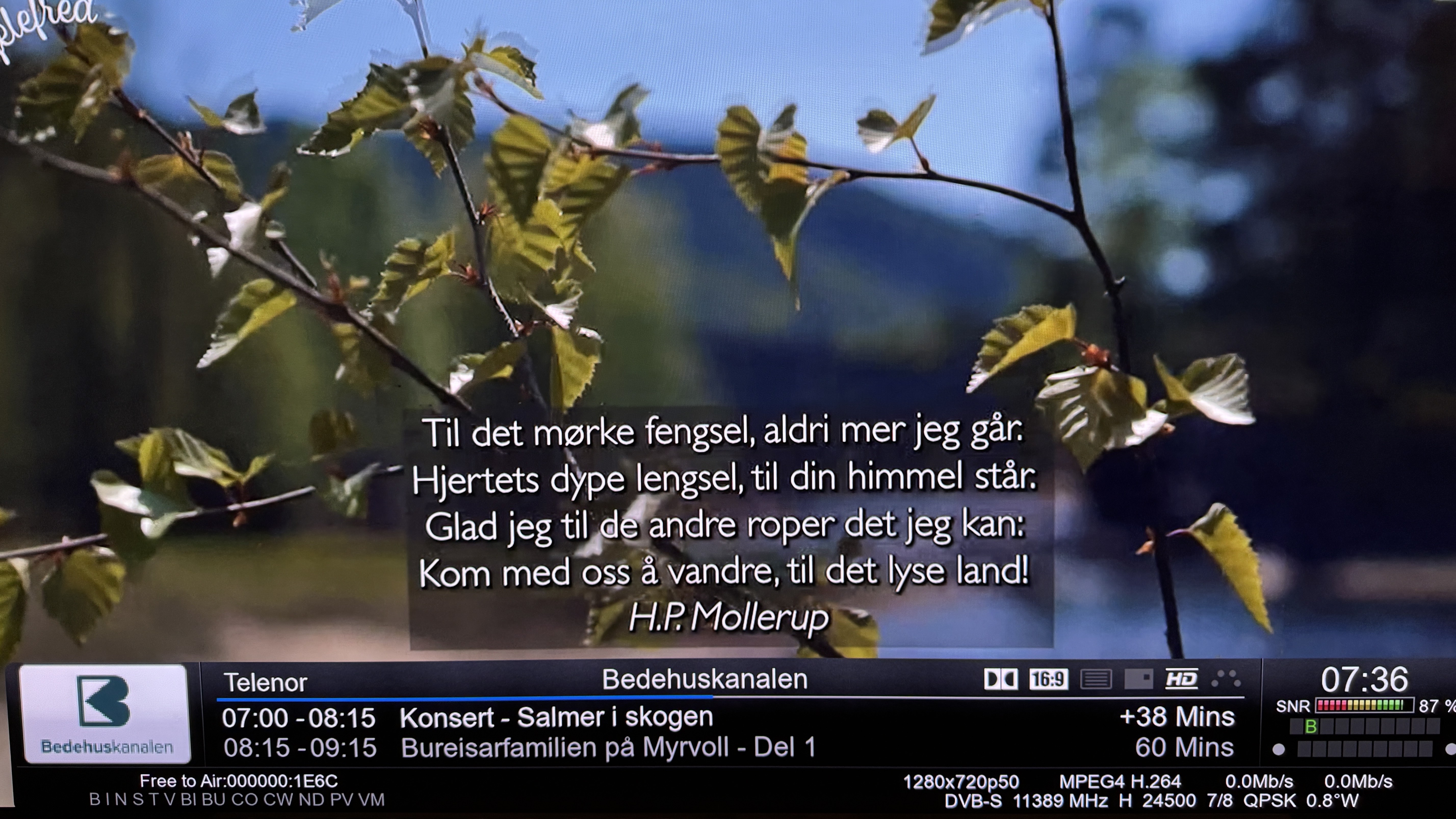

I thought I'd scan 0.8w while I was at it. Picks up nearly 1000 channels and seems to be a mix of both H & V.

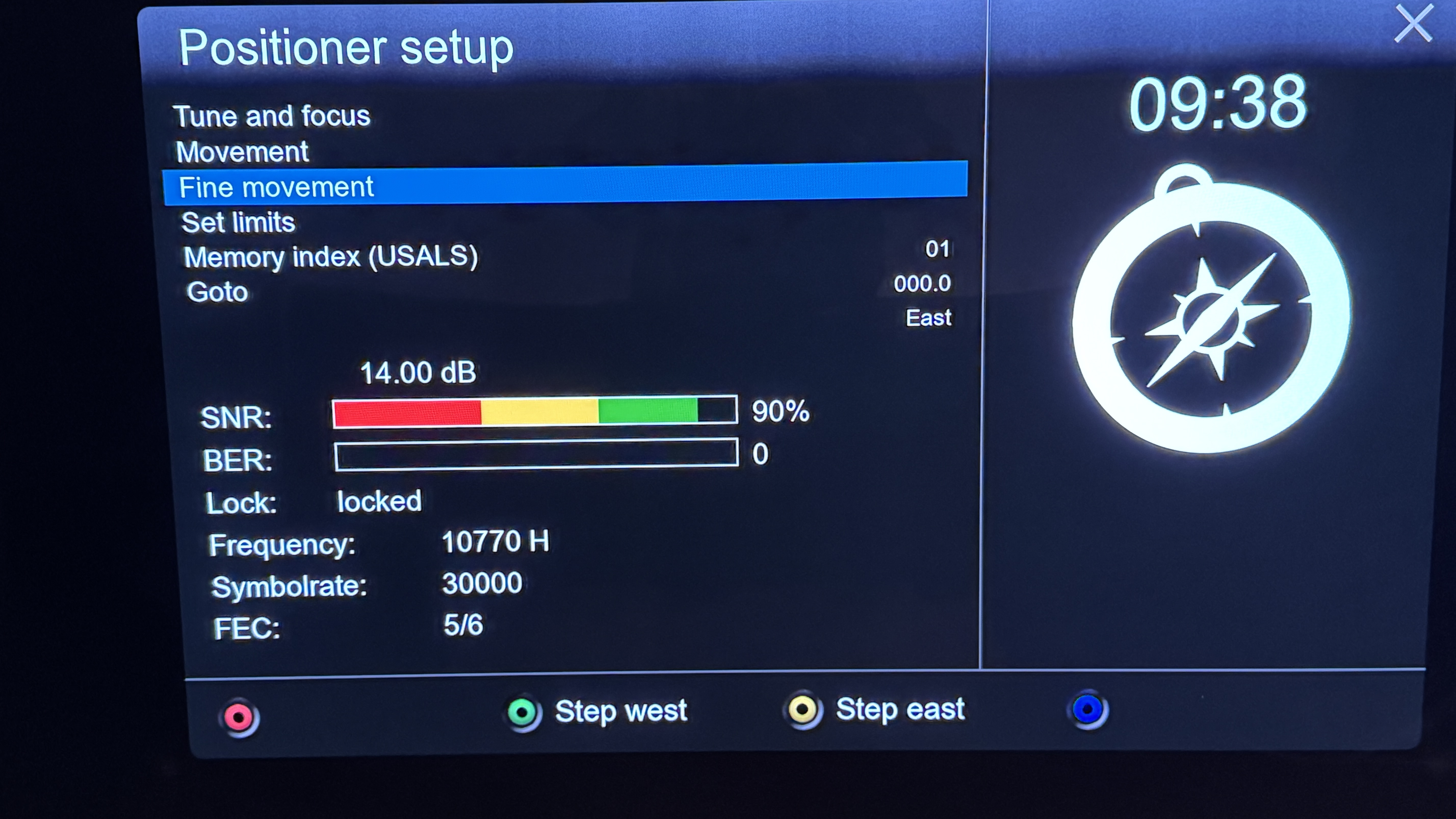

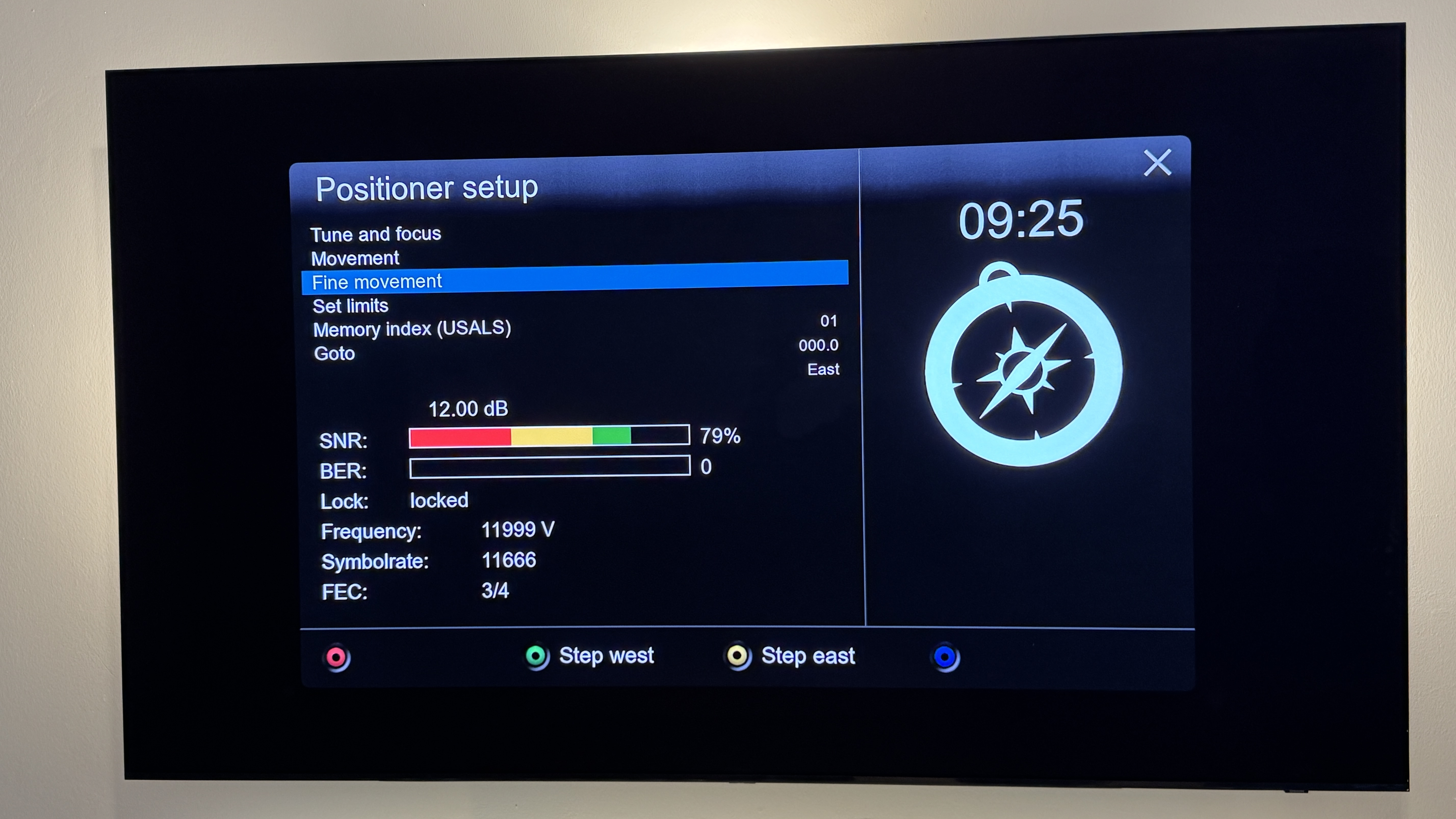

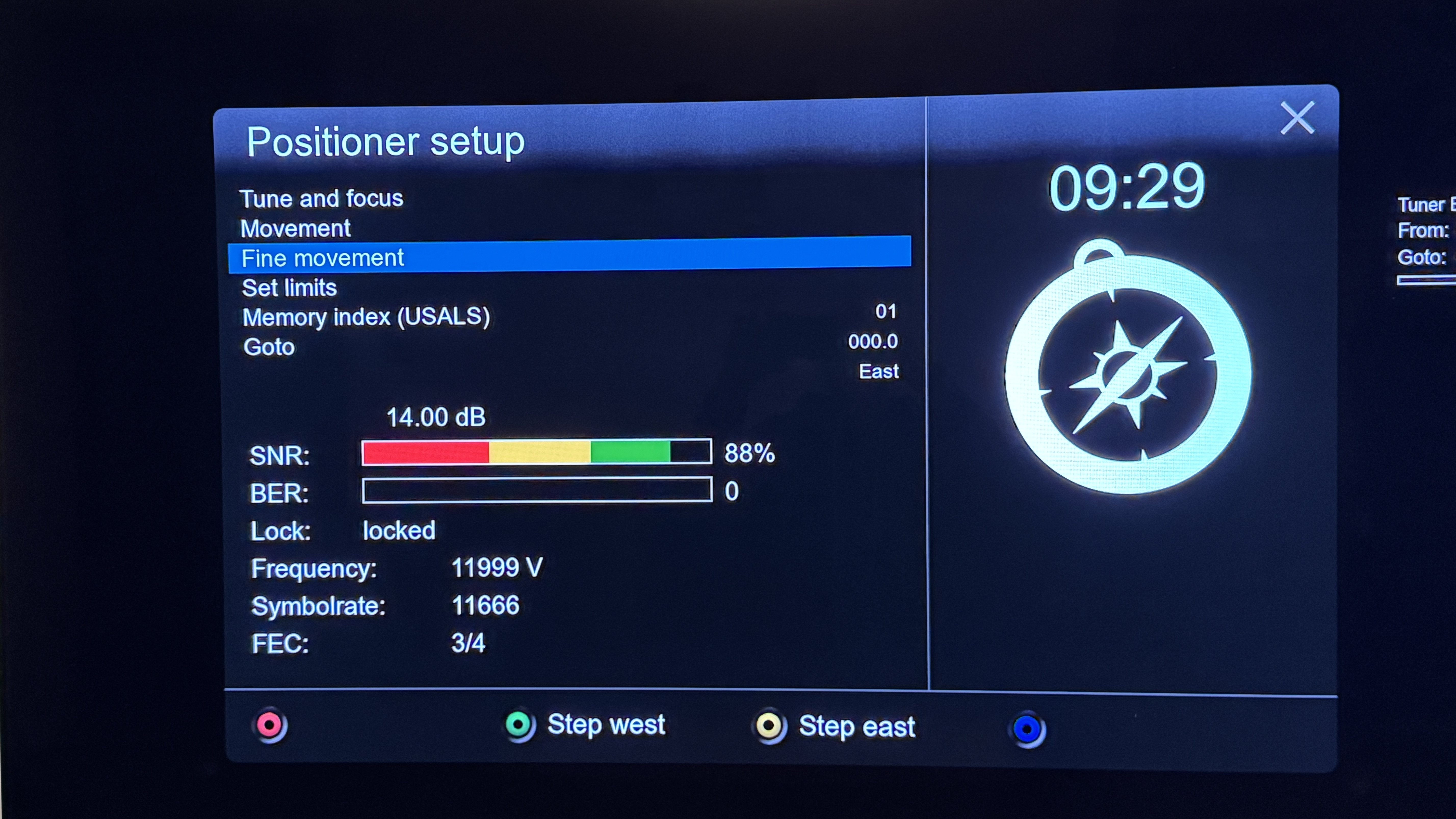

42e - starts off SNR 79%, but if I nudge it 6 steps west, then I reach 88%
30w - most channels seem to be 98-100% SNR to begin, though I did find one starting at 90%. Nudging that E or W only makes it worse - drops by a couple of % after 2 nudges.

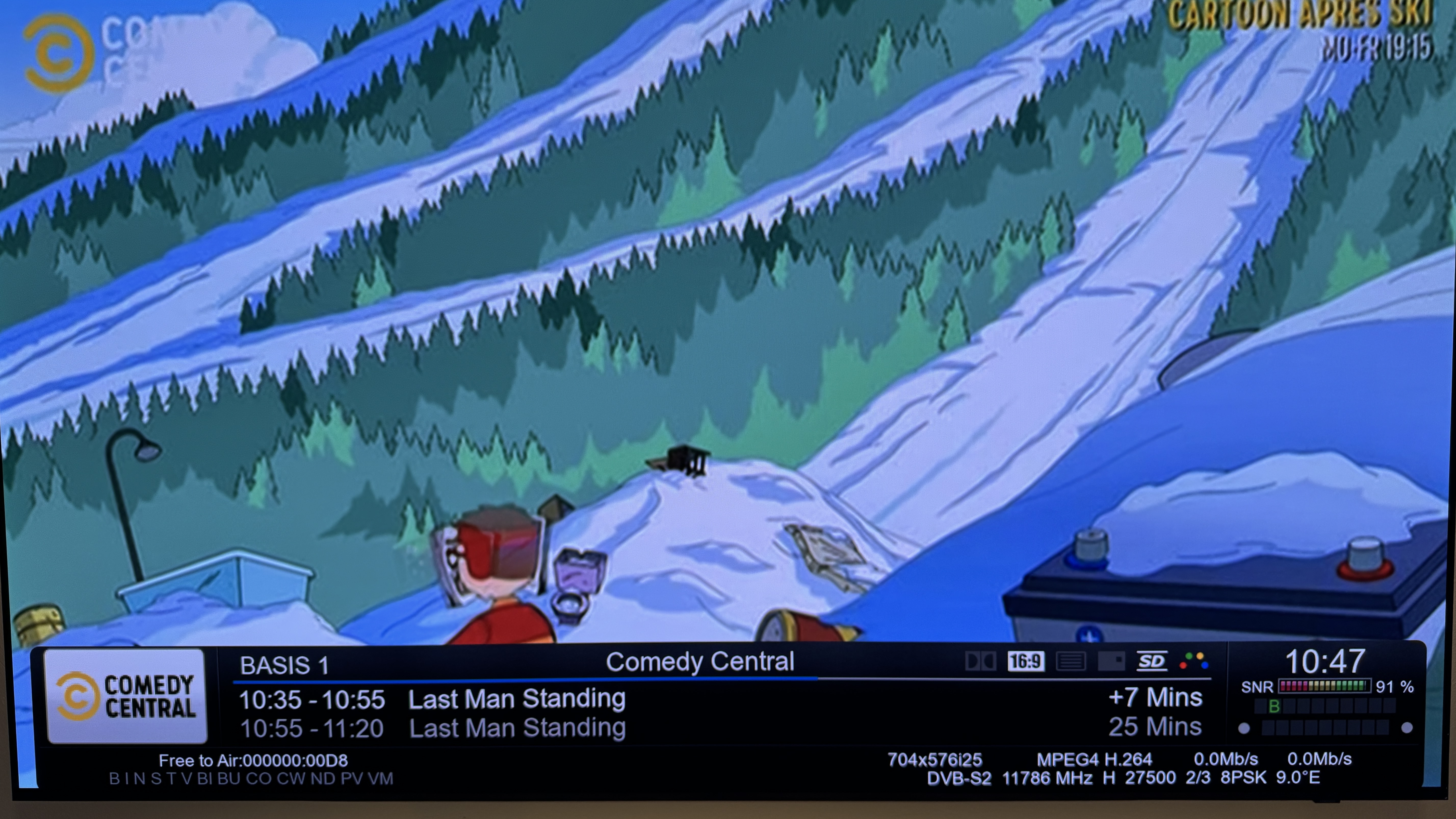

So on the Solo2 Comedy Central opens fine. DVB-S2 11786 H 27500 - 91-92% SNR. If I nudge it W by 2 or 3 it flickers between 92% 93%

Now your sucking diesel so as already said by ... alignment is out on the EASTERN SIDE, the West is OK so all you do is adjust the usals for the east UNTIL you get a good fix, then note it down, now you have 2 settings one for east and one for west, it means rig is crookled but it can be the dish, the pole, the motor, dish can move slightly on stub and so on. Its hard to fix small errors.
So it looks as if your motor is going too far east but only a tad and I think where you are usals may be 0.987. or such like so just make it smaller and save each time, while on 7e and when you get the 90% then thats it . NB write down your original setting.
Im willing to bet the pole the motor is mounted to is not perfectly plumb.
