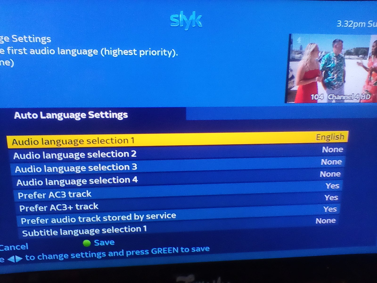

Just clean flashed openatv 7.6 on my mum's zgemma h9 twin and on most channels have audio description,I can change using audio button on remote but when I run autobouquets they revert back to audio description.
Any ideas and what settings to change??

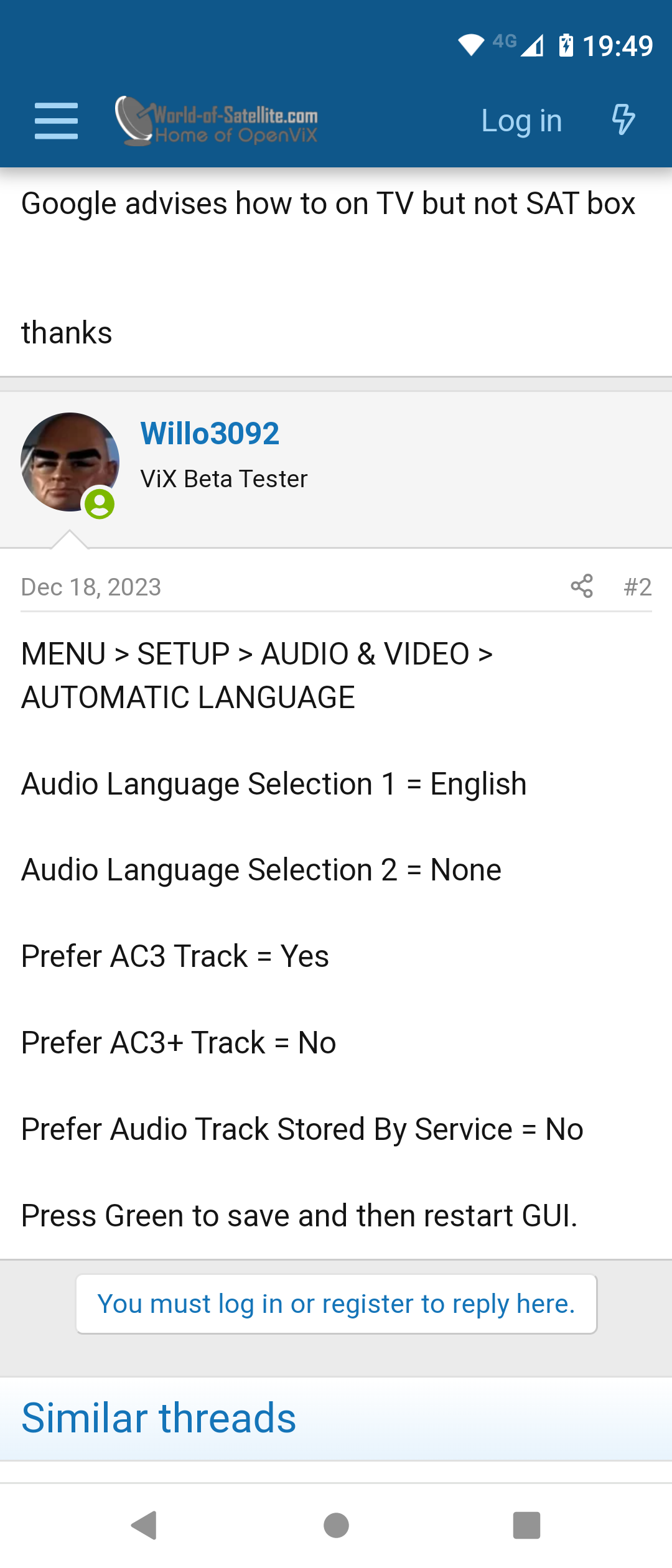

Thanks @Dar1437 will try that.
On my box it's the same except the bottom two which I have as yes.( Which work)
I tried my settings on mum's but didn't work so was a bit baffled.
Will try this tomorrow and let you know.

Tried above but still changed after running autobouquets.
So reflashed and used my settings in photo and everything working good now after rebooting box.
But baffled why but it's ok so will stick with what is set.👍
