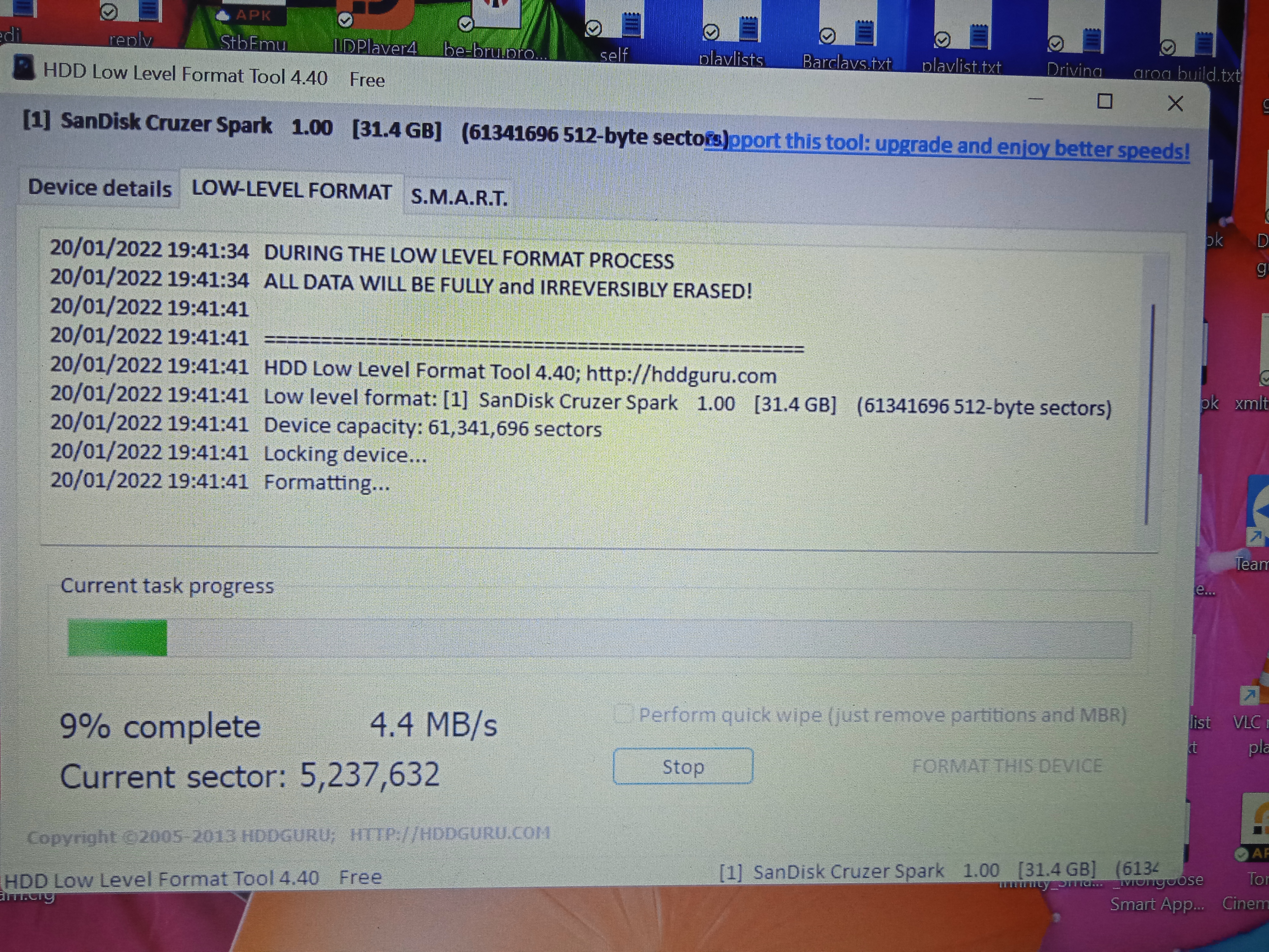

Gonna try hddguru now, @moshibeth sent me the link

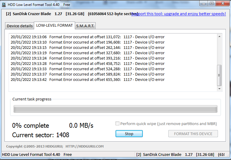

is it normal to get lots of errors like this?
Not even on 1% and it's error after error:
Knocked it on the head, set it on 'perform quick wipe' but it's just the same with continuous errors so think this stick's ready for the skip.

I'm not sure the Cruzer is any good, it doesn't seem to be formatting.
It works on pc, if I send a video or pictures to it, eject and put it back in I can access the content but formatting is failing and E2 box doesn't see them
