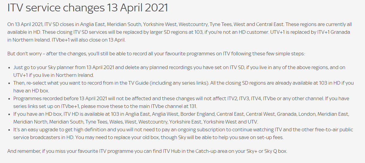

According to Sky website
Tuesday 13th
  • ITV SD closes in Anglia East, Meridian South, Yorkshire West, Westcountry, Tyne Tees, West and Central East. See ITV SD closes on 13 April for more info.
  • ITV Be+1 (231) closes
  • ITV Anglia East SD (103) closes - replaced by ITV Meridian East SD at 103
  • ITV West SD (103) closes - replaced by ITV Central West SD at 103
  • ITV Meridian South SD (103) closes - replaced by ITV Meridian East SD at 103
  • ITV Westcountry SD (103) closes - replaced by ITV Central West SD at 103
  • ITV Yorkshire West SD (103) closes - replaced by ITV Granada SD at 103
  • ITV Tyne Tees SD (103) closes - replaced by ITV Granada SD at 103
  • ITV Central East SD (103) closes - replaced by ITV Central West SD at 103
  • UTV+1 SD closes (203) - replaced by ITV+1 Granada SD
