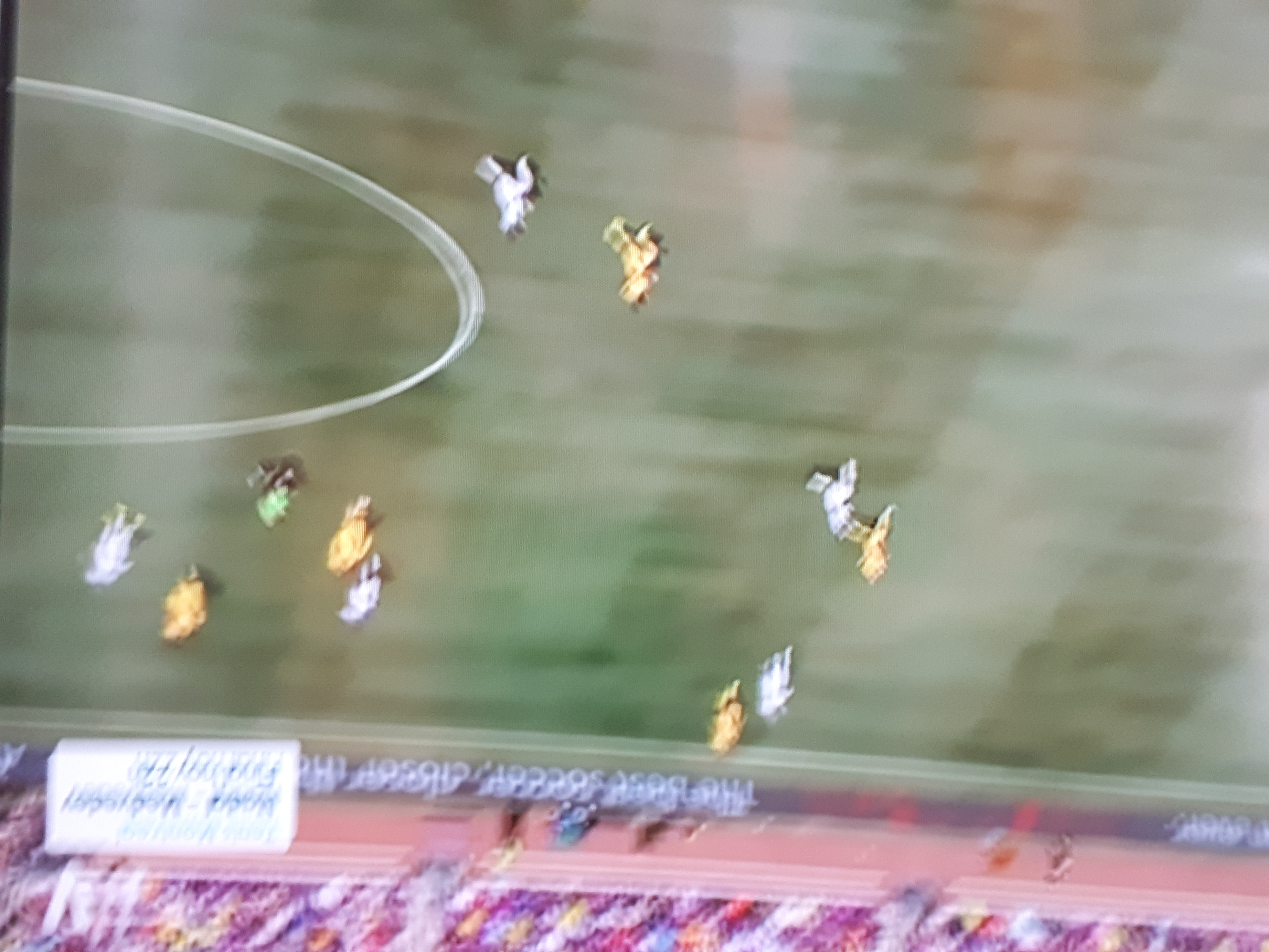

Working here. how small is your dish or signal strength
Thanks for replys from all,
Started working now, constant freezing on all Movistar channels (HD and SD)
Dish- 80Cm with 2 LNBs (19.2°E and 13°E ) diseq to splitter then onto:-
Zgemma H9S and Mirclebox
Update; while writing this double checked splitter (loose connection or faulty) all seems OK now
Grrr! LOL
