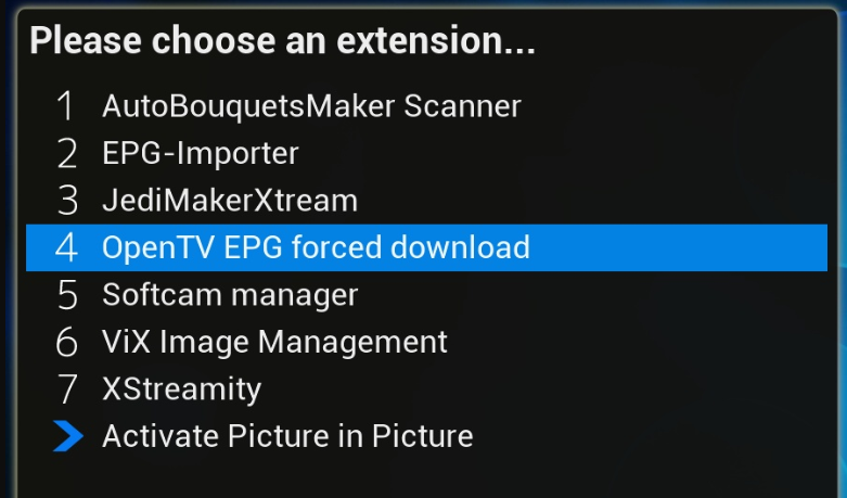

There should be an option to force a download on the blue button extension menu.

I just see a "Cancel" and "Save" option only. The "Menu" button appears when I highlight the Provider" and the "Update Interval" rows, but I don't see any option to force a download. The Remote's Blue button does not have an affect on any of those functions.
You have 'show in extensions' enabled.
Exit out of all menus to just the TV screen.
Press the blue button and the extension menu will pop up.

Maybe it doesn't show in the extensions menu on old versions of vix?
Did you restart the box after enabling the option?
Well holy ---- ! I rebooted the box, when it came back, I hit the Blue button, and low & behold, the "OpenTV EPG forced download" appeared as my new #4 item in the Extensions menu. I selected that #4, and it immediately returned back to a soccer station that I was previously viewing. But even better still, my CNN HD station EPG is now fully populated!
Fair play to you and the other responders - and many thanks!
